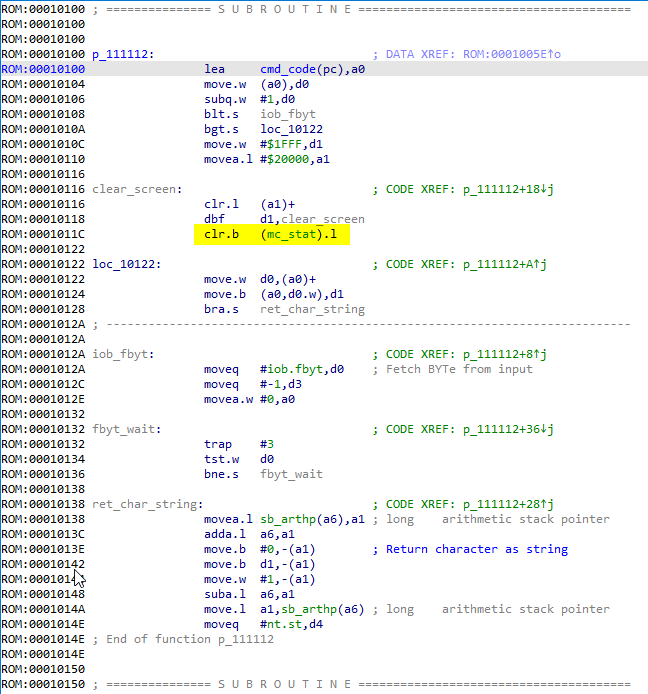

Offset $11C and $15C... (extensions_code)

Martin_Head
Posts: 1002
Re: MT.DMODE alternative (i.e. how else to change display mode)
Post by Martin_Head »
I'm in the process of trying to decompile SuperCharge's Parser_task, and that p_1112 routine of Marcel's that changes the screen mode, is called from Parser_task
