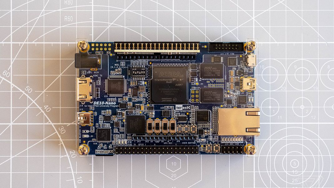

I am interested in Marcel Kilgus's SMSQ/E on MiSTer project but his webpage does not make it clear (to me) what one has to buy/do to build it. What is the maximum display resolution of his design and does it use HDMI for output?
I see that the FX68K core is written in SystemVerilog does that imply that the rest of the design is also written in SV?
Is the system portable, ie. can it run in any fpga large enough to accommodate it or is it dependent on the MiSTer hardware?
I recorded Marcel's recent talk on m68k including the after-talk Q&A but I stopped the recording just as he mentioned his FPGA skills, which he claimed were limited. SMSQ/E in FPGA is a remarkable achievement for someone with limited skills!
I "Googled" MiSTer and found that it is based on Terasic DE10-Nano Altera/Intel Cyclone V SoC experimenter's board which, strangely, is cheaper to buy (76 pounds) here in Switzerland than directly from Terasic.
From GitHub:-
MiSTer utilizes a readily available FPGA board called the 'DE10-Nano', which connects to your TV or monitor via HDMI video out. It can additionally be expanded with various add-ons (such as a USB hub, SDRAM, audio and VGA out).
The MiSTer software/OS itself is freely downloadable, and anyone is welcome to contribute to its development. In fact MiSTer relies on the contributions of many developers for the various systems (known as 'cores') it replicates.

hello Tinyfpga
in addition to the DE10.Nano board you need :
build or buy the SDRAM Module https://github.com/MiSTer-devel/Main_Mi ... DRAM-Board
build or buy the IO board https://github.com/MiSTer-devel/Main_Mi ... i/IO-Board
you can use a usb Hub or bulid/buy one https://github.com/MiSTer-devel/Main_Mi ... hter-board
i can recommend this kit https://www.antoniovillena.es/store/product/kit-mister/
Greetings from Switzerland
Markus

Regarding MiSTer, the I/O board is not strictly needed anymore, the SDRAM board is a must however. The release version does only the standard 512x256 resolution, but rescaled over HDMI, so can be used with pretty much every monitor and TV. Maybe someday there will be a 1024x768 version, but currently I lack the time to get anything done.

Difficult. It depends on the MiSTer framework for menus, disc access, video output, etc.Is the system portable, ie, could it be used in any FPGA large enough to accommodate it or is it hardware dependent?
The speed of the FPGA chips and the skill of the implementer.What determines or limits the performance of FPGA 68000 systems?
Easier.What do you think of using SRAM as main memory?
As long as you don't have much video resolution/colour depth that is.- SMSQE seems to work perfectly well in 8MBytes . CY62187EV30 64Mbit 55ns SRAM costs a mere 56CHF.
