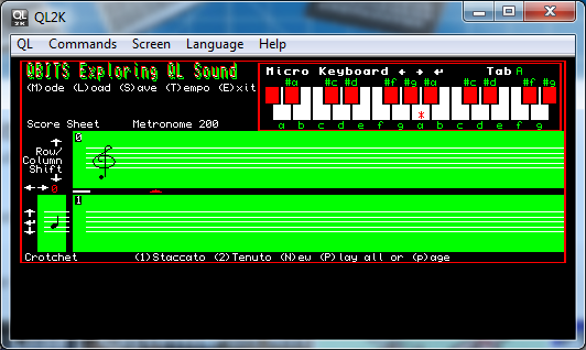

So as an NTSC user of the QL I get the joys of using only 192 of the 256 lines when using composite out -- well, color composite since my LCD seems to handle monochrome composite in its full PAL glory. Back in the late 80's and early 90's when all I had was a TV to plug my QL into I don't even know if the monochrome composite would have worked (I didn't realize it existed, otherwise I would have tried it).
So there are many programs that are not fully usable because the bottom gets cut off. Now if I run it in monitor mode and have an RGB to SCART cable and up-convert it to HDMI, all should be good, except maybe loosing some pixels on the left (QL-VGA will fix that).
In any case, I've played around with the SCALE keyword but it doesn't quite work for everything, only graphics, so if you mix modes, I don't think you can magically just re-scale things and have it fit...plus you lose width in that case too I think. So I wanted to run the QBQLSounds program on my LCD tv in color and if I run it as is, things get cut off. So I did some mods to it (as minimal in the actual code as possible since I didn't want to spend weeks learning how it works) and turned it from this:
To this:
I remapped the following calls, renaming the originals by appending a D and anyplace that the TO keyword was used I just did multiple calls since I don't know if DEFine can handle these type of variable parameters in SuperBASIC (i.e. LINE a,b TO c,d TO e,f became LINE a,b to c,d: LINE c,d TO e,f which could then be replaced by DLINE a,b,c,d: DLINE c,d,e,f). Note that with a JSU ROM, the characters are only 8 pixels in height (compared to 10 in JS) so that works out with text (and why the PSION suite worked similarly on NTSC machines since they re-worked their software to fit on the screen -- pretty smart by them but it's only the 4 apps as even QL Chess doesn't do that).
Here are all the newly defined procedures:
10 hs=.84
1100 DEFine PROCedure DBLOCK(ch,x1,y1,x2,y2,c)
1110 BLOCK #ch,x1,INT(y1*hs),x2,INT(y2*hs),c
1120 END DEFine
1200 DEFine PROCedure DLINE (x1,y1,x2,y2)
1210 LINE x1,INT(y1*hs) TO x2,INT(y2*hs)
1220 END DEFine
1230 DEFine PROCedure DLINE_R (x,y)
1240 LINE_R TO x,INT(y*hs)
1250 END DEFine
1300 DEFine PROCedure DCURSOR (ch,x,y)
1310 CURSOR #ch,x,INT(y*hs)
1320 END DEFine
1330 DEFine PROCedure DCURSOR_G (gx,gy,x,y)
1340 CURSOR gx,INT(gy*hs),x,INT(y*hs)
1350 END DEFine
1400 DEFine PROCedure DCIRCLE (x,y,r)
1410 CIRCLE x,INT(y*hs),r
1420 END DEFine
1430 DEFine PROCedure DCIRCLE_F (x,y,r,d,a)
1440 CIRCLE x,INT(y*hs),r,d,a
1450 END DEFine
1460 DEFine PROCedure DCIRCLE_R (x,y,r)
1470 CIRCLE_R TO x,INT(y*hs),r
1480 END DEFine
1500 DEFine PROCedure DARC_R (x,y,r)
1510 ARC_R TO x,INT(y*hs),r
1520 END DEFine
1600 DEFine PROCedure DWINDOW (ch,w,h,x,y)
1610 WINDOW #ch,w,INT(h*hs),x,INT(y*hs)
1620 END DEFine
1700 DEFine PROCedure DSCALE (s,x,y)
1710 SCALE INT(s*hs),x,y
1720 END DEFine
It would have been a nice feature where you could have specified a re-mapping of screen geometry. Maybe a command like MAP 512,256,0,0 TO 512,192,0,0 that would have done that. But that likely would have added a lot of overhead to the ROM. Not sure if non SuperBASIC would have worked with that. But still, having grown up with the NTSC shortcoming it would have been nice (though I realize the market for that is so tiny).

100 REMark QBSoundsv5 (QBITS Exploring QL Sounds 2021)
101 :
102 MODE 4:hs=.84:CLS:QLSounds:Init_Keys:QBITS_Menu
103 :
104 DEFine PROCedure QBITS_Menu
105 ac=0:ar=0:sl=0:sn=0:ds=12:bn=1:mn=200
106 mp=1:kg=0:kn=12:ka=143:ku=52:m=1:KMode
107 OVER#3,-1:DCURSOR 3,ka,ku:PRINT#3,'*':OVER#3,0
108 :

690   MKey(1,kn,5)=w:MKey(1,kn,6)=f:MKey(1,kn,7)=r
691 END FOR kn
692 kg=0:kn=12:DCURSOR 3,232,4:PRINT#3,'A'
693 END DEFine
1120 END DEFine
1220 END DEFine
1250 END DEFine
1320 END DEFine
1350 END DEFine
1420 END DEFine
1450 END DEFine
1480 END DEFine
1520 END DEFine
1620 END DEFine
1720 END DEFine
