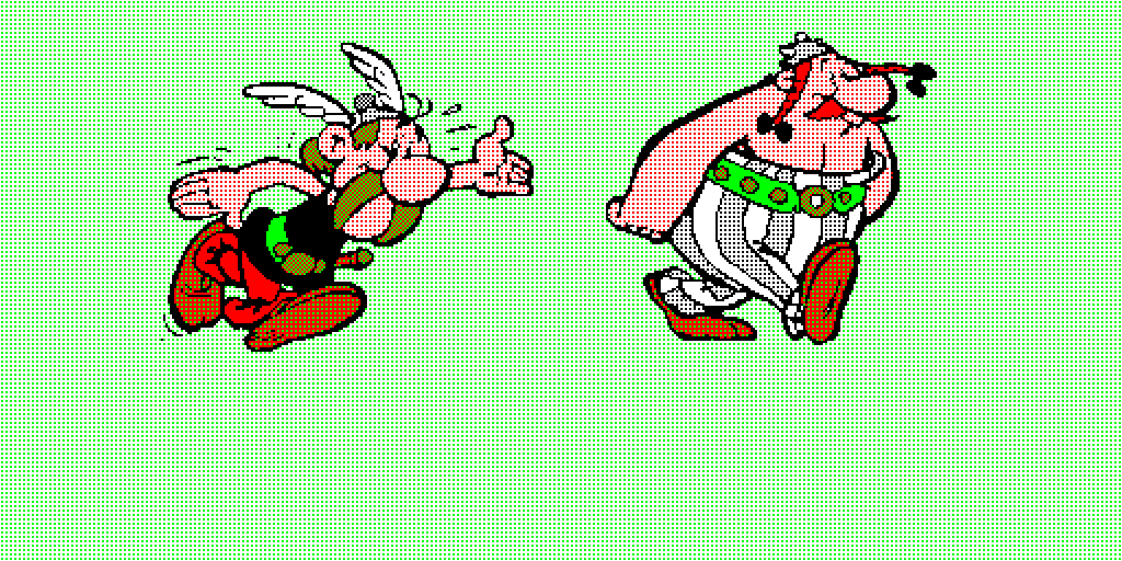

Been playing around with various QL art programs on a BBQL: Leonardo, Peintre, ARTice. The first two didn't work too well and were a bit slow so I stuck with ARTice. Imported a black & white TIFF file (QLTIFF_bas) and then colorized it in ARTice (with the limited mode 4 colors). Came out ok...the dithering really got the skin pinks and shoe browns (esp when the image is small). Sadly no blue and Asterix's hair is supposed to be yellowish (looks better in larger image):
the screen file is here...to be used in mode 4 (assuming mdv2_ but replace as needed): lbytes mdv2_asterix2co2_scr,131072

So I posted the pic on the "Sinclair QL For Everyone" Facebook page and noticed that in Chrome, it messed with the picture and gave me this (it's a little blurry since I magnified it x2). In an older version of Firefox it stayed grainy.
So it basically got rid of the dithering and colored in the rest...kind of neat. It saved as a jpeg.

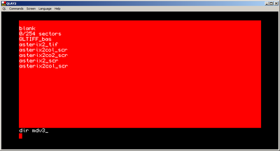

Oh, and then there is this...I was editing the picture and saved it in ARTice and found two identical names on the MDV image. It accessed the first one and to get to the second one I had to rename the first one but then everything worked fine. Is this a bug in the QLAY emulator or in QDOS itself (I use the US version of JS -- JSU). Note that the MDV is full.
