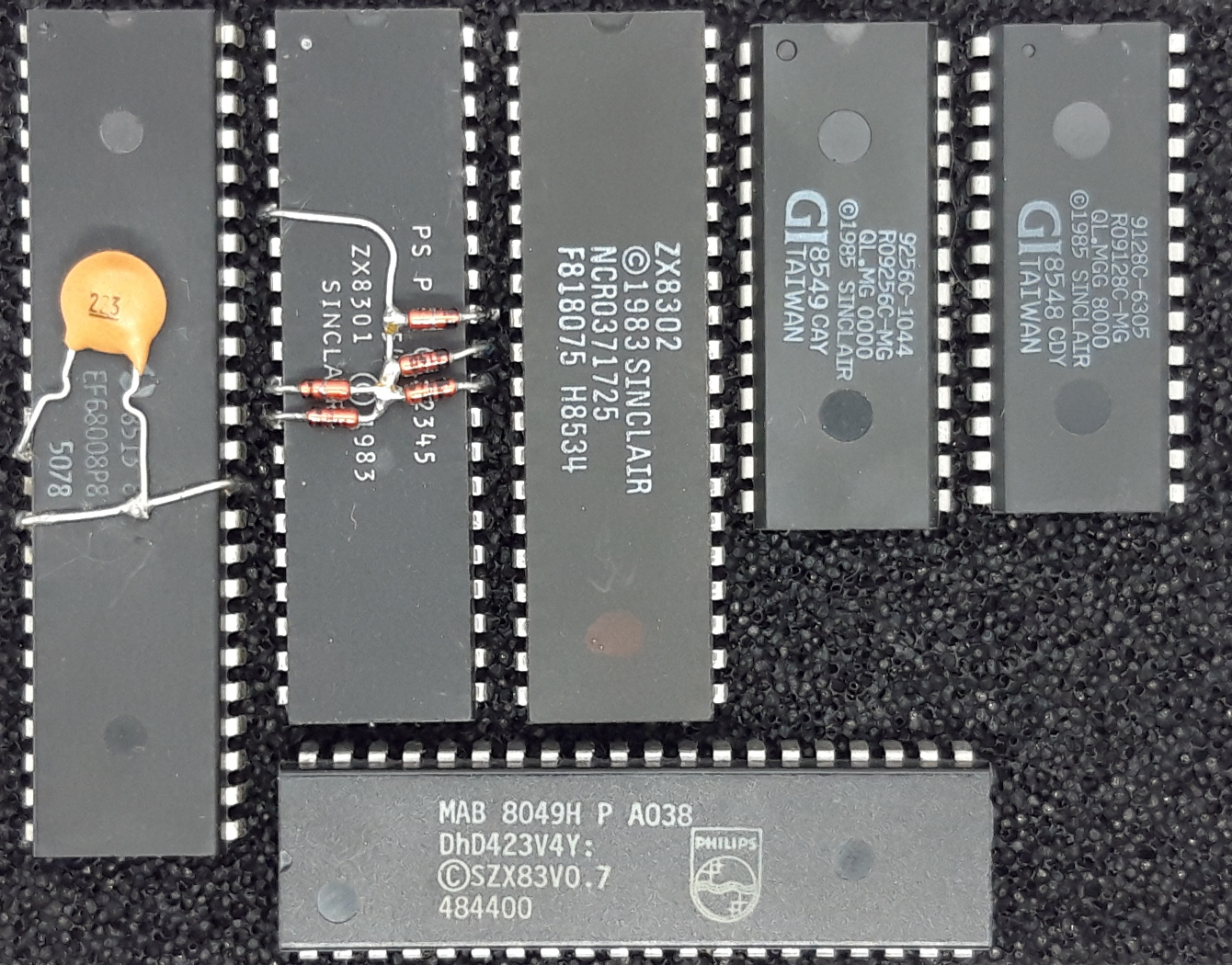

I personally only bother adding diodes to the ZX8301 when it's a German QL (or US one, but not seen one of those yet) as on those Samsung models it was a factory fitted mod. Others, inc all the UK ones, never had them. And I've destroyed ZX8301's with or without diodes, so I don't think it's a magic cure to make them indestructible.
Here's a pic of a German chipset showing the 1N4148 diode arrangement on the ZX8301.
