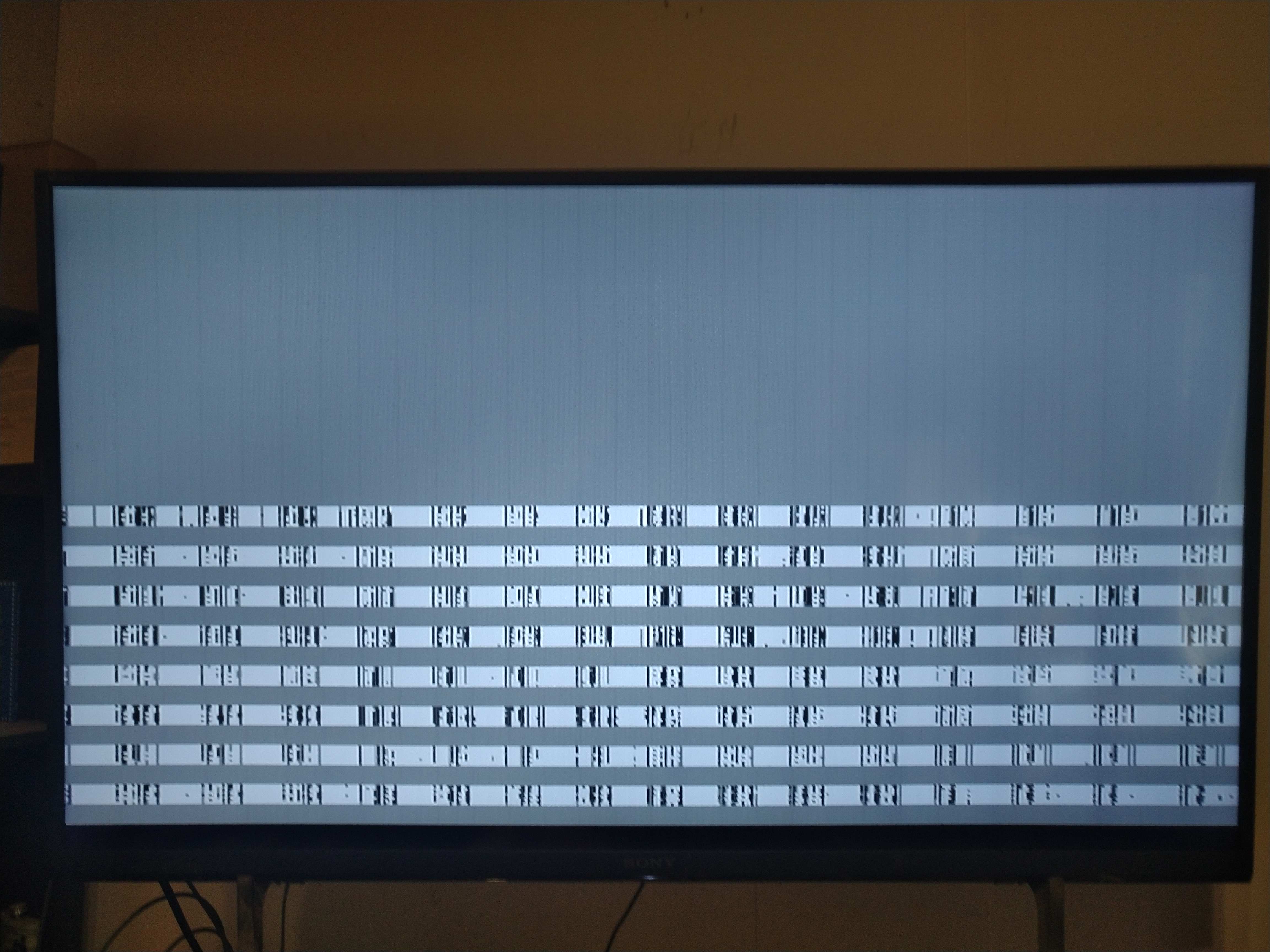

Hi everyone,
Today my QL failed, showing this on boot up:
I’m using a Minerva ROM but it is not showing a RAM error.
Any suggestions re trouble shooting would be appreciated.
Mark

Is it always the same exact pattern or there is some variation every time you plug it in ?
François
mselkin
Posts: 85
Re: My QL failed
Post by mselkin »
It’s a different pattern.
I can here the speaker click if I press a key so that little processor is working. If I leave the power on, the screen turns black after a few seconds. That could be Minerva entering F2?
Sent from my iPhone using Tapatalk

Hi Mark,
Does the QL then behave as expected? I mean beside the corrupted display?
Try to enter:
beep 10000,10000
or
Paper 7
CLS
If this simple code works as expected my guess is video error. But I am far away from being a QL Expert.
Maybe this is helpful, see paragraph 2.2 ff
http://sinclairql.net/srv/qlsm4.html#s4
Rgs,
Stephan
Posts: 1687
Re: My QL failed
That looks like minerva is running and has tried to print a ram error. And you are generating a valid video signal, my money would be on a failed address or data line somewhere around the ram (bad chip, multiplexer chip fail etc)
Ruptor
Posts: 420
Location: London
Re: My QL failed
Post by Ruptor »
XorA wrote:That looks like minerva is running and has tried to print a ram error. And you are generating a valid video signal, my money would be on a failed address or data line somewhere around the ram (bad chip, multiplexer chip fail etc)
Yes and the little dashes under each line are telling us something but I don't know enough about the memory display. Mine had lines that is longer dashes caused by one dead ram chip. I think the memory error number display area is big so even if one ram chip is dead you can still see the address but best get input from an expert.

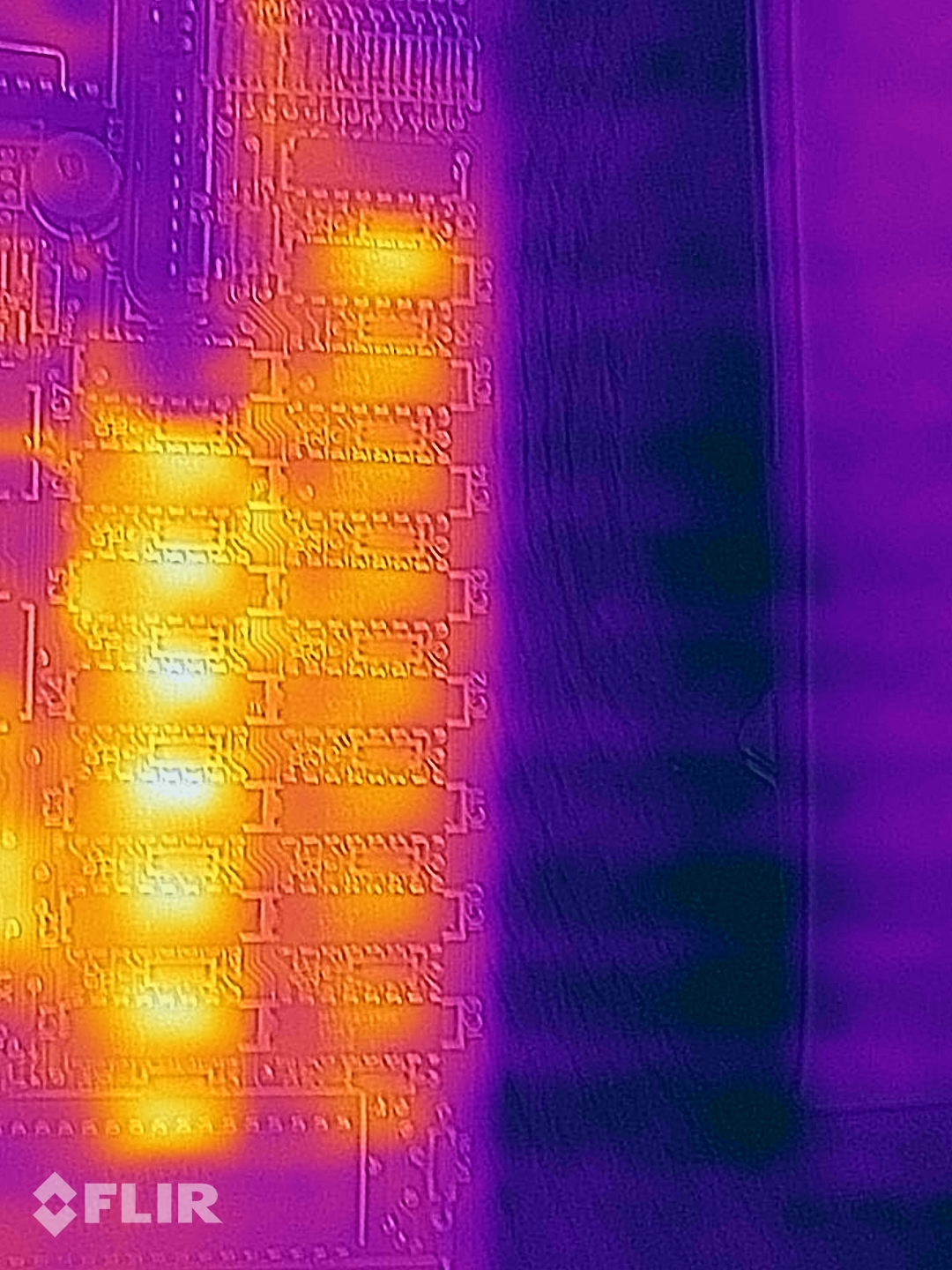

As it may be a RAM issue I used my phones thermal imaging camera to monitor the temps of the chips.
None seemed hot but I note IC7 & IC8 stayed cold.
So not working or is this normal?
Edit: Examining more closely it was just a parallax with the camera and all the RAM chips appear evenly heating.
I note IC 19 & IC 20 are a lot cooler than the others and it was suggested 19,20 & 21 can cause trouble. So perhaps I should look at those.
