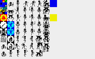

Attached you find an overview of the sprites from the game: I do not foresee any problem (just yet) in converting this to QL (color wise). As such, are there any suggested QL graphics conversion tools for Windows/OSX ?

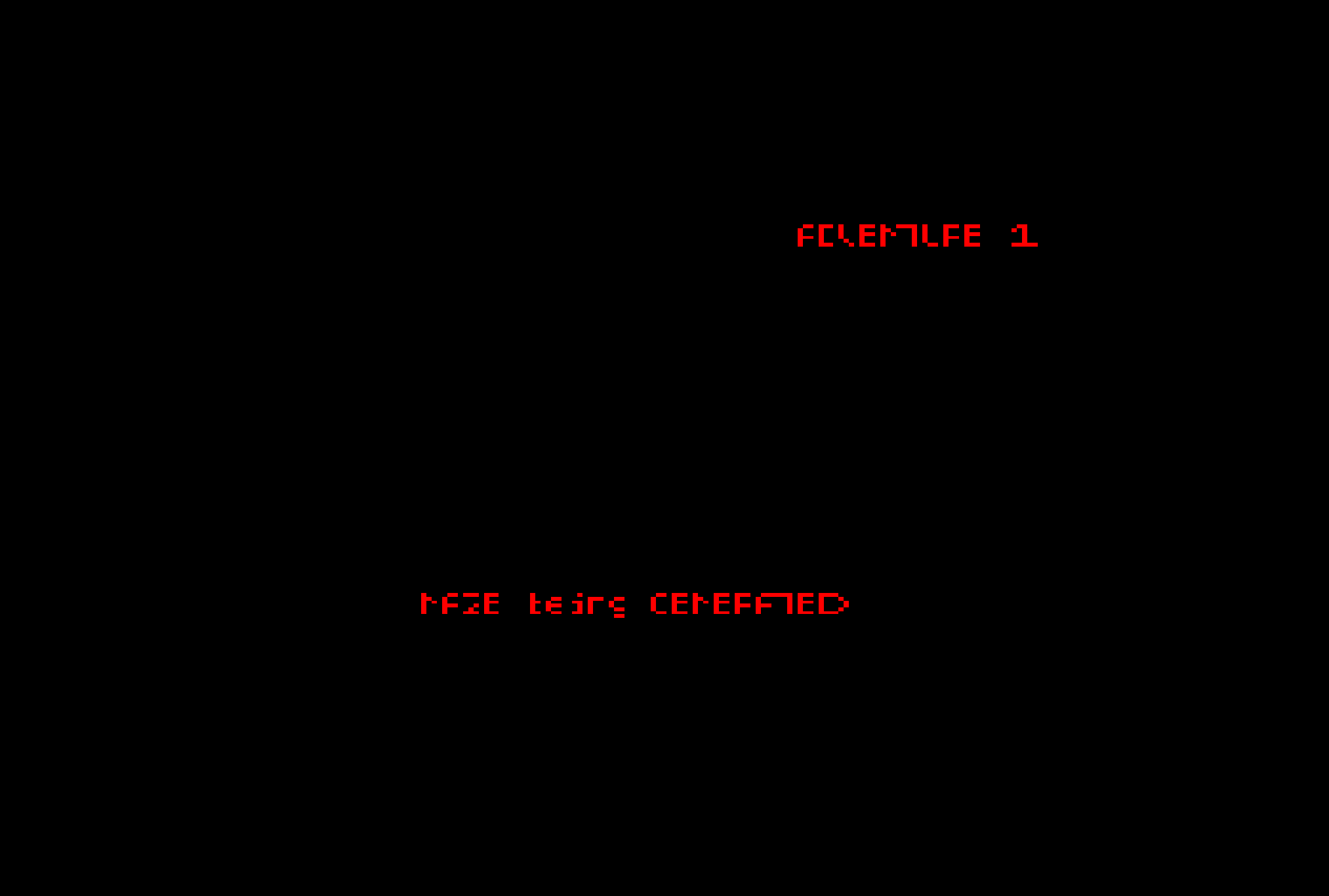

First small success. Drawing text on the QL using ZX Spectrum basic code that has been converted to M68K and ported for QL

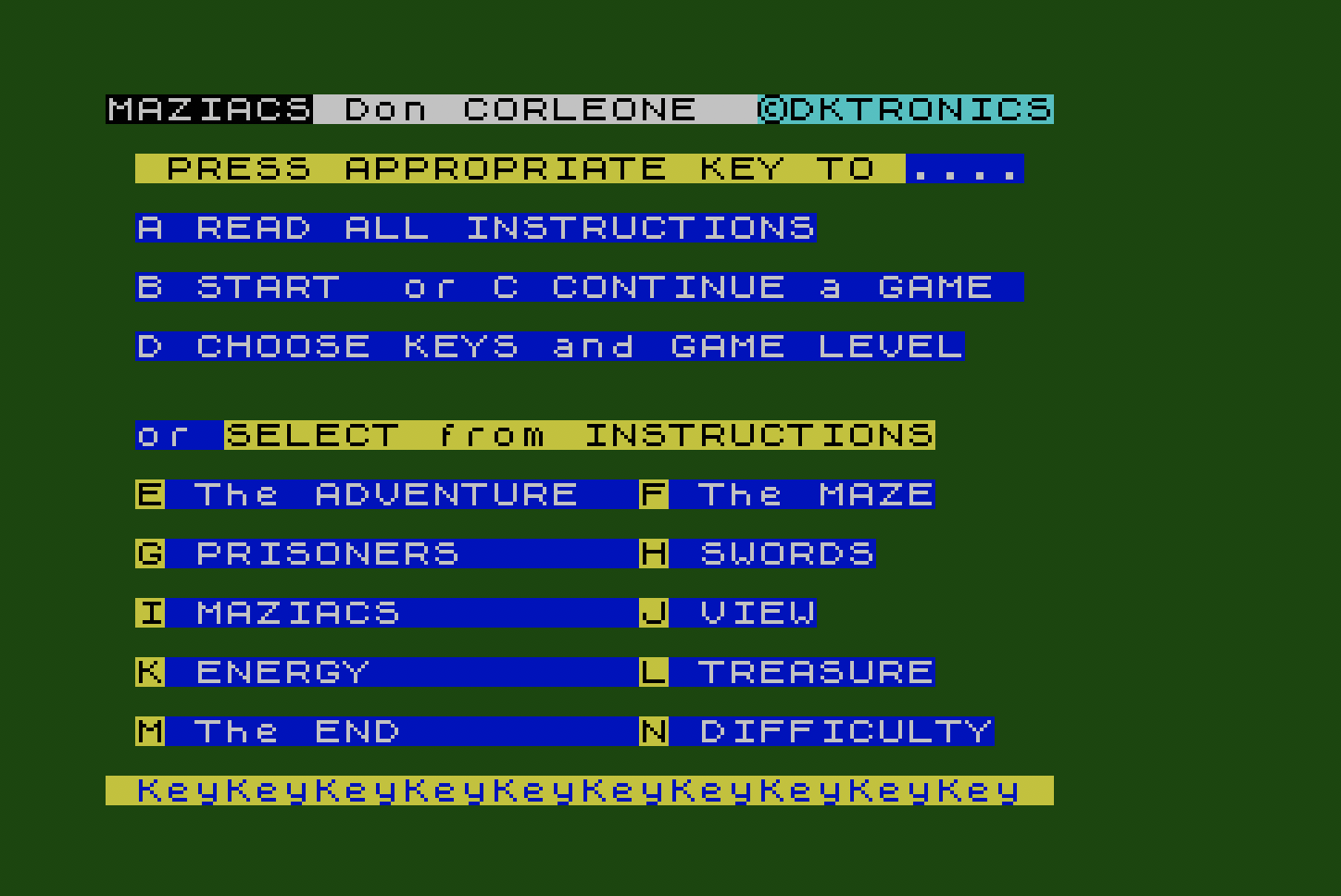

In comparison the Atari ST version I of the same actual code:

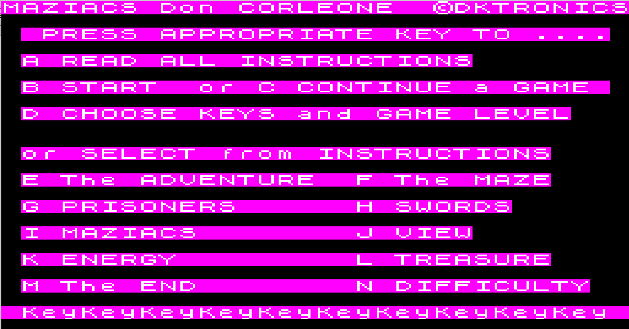

Time to get into the whole paper and ink stuff to adapt the actual graphics. And the actual ZX screen

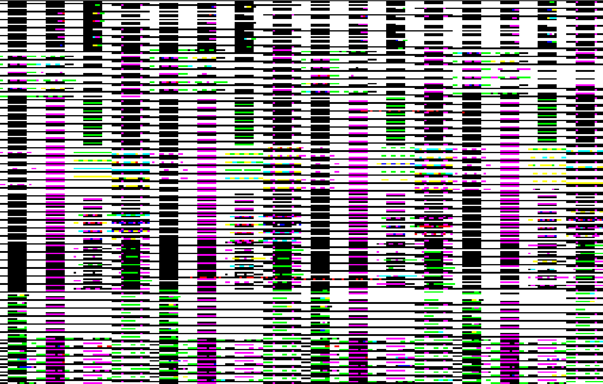

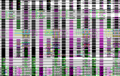

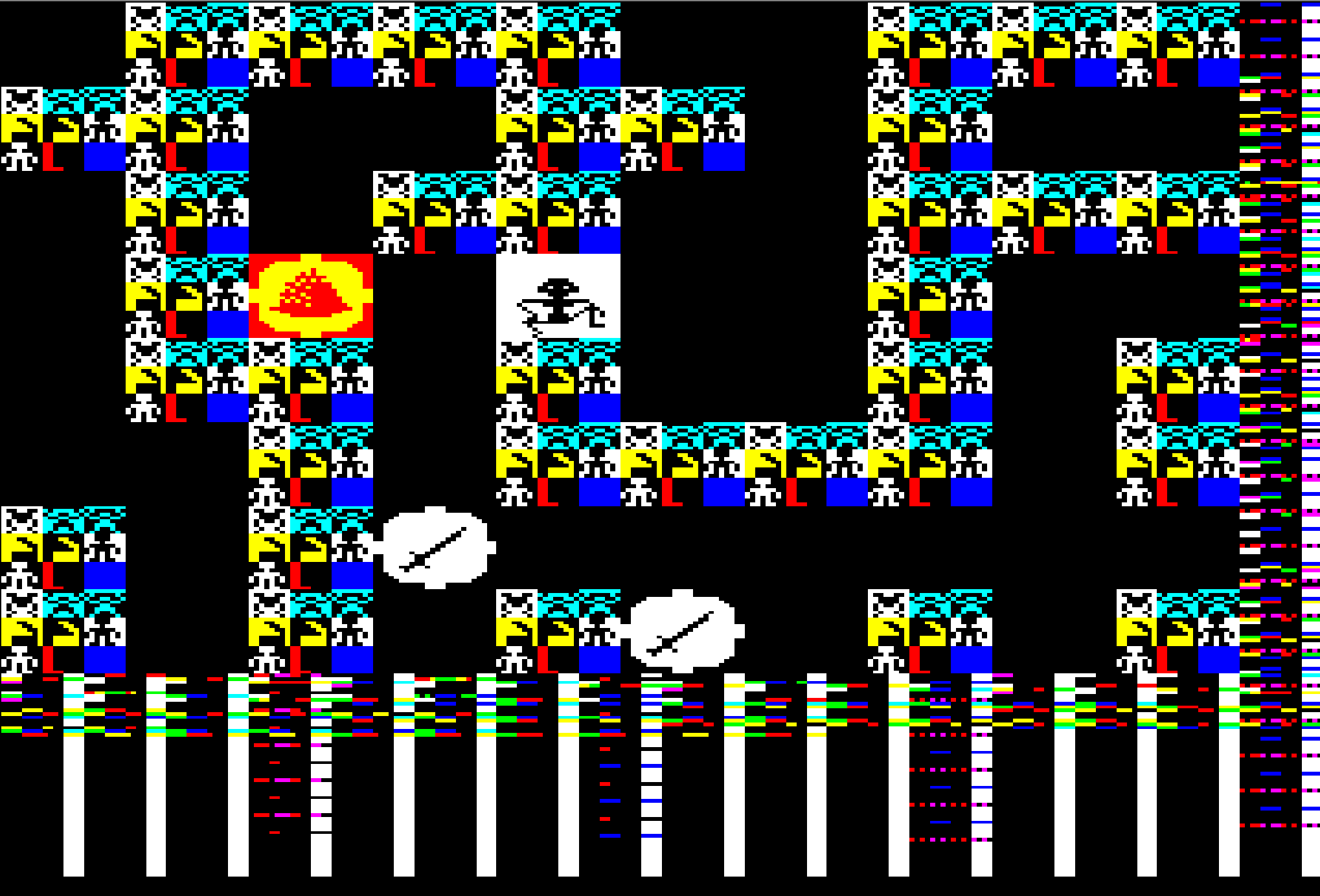

Little update. I managed to get the maze generation working; because the port seems to rely on a time-tick for this generation.... I hacked something around it, to improve later. So now we can generate a playable maze and it drops into gamemode (in 384kb QL emulation mode), but the screen is one big garbled mess due to not having the QL display output ported yet:
And the gameplay:

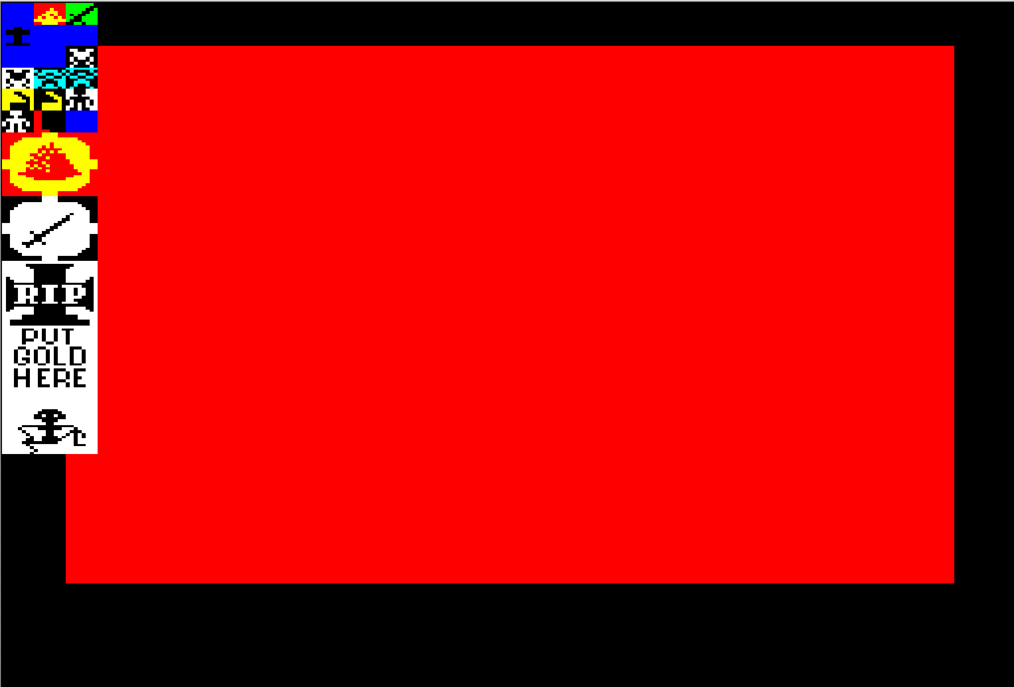

So I made a start in converting the tiles for QL display. Currently it uses a 1:1 conversion of data, but considering a lot of tiles are only a single color, I think this is where I can optimize for space as well (get a 1:4 compression ration for most of the single color tiles):

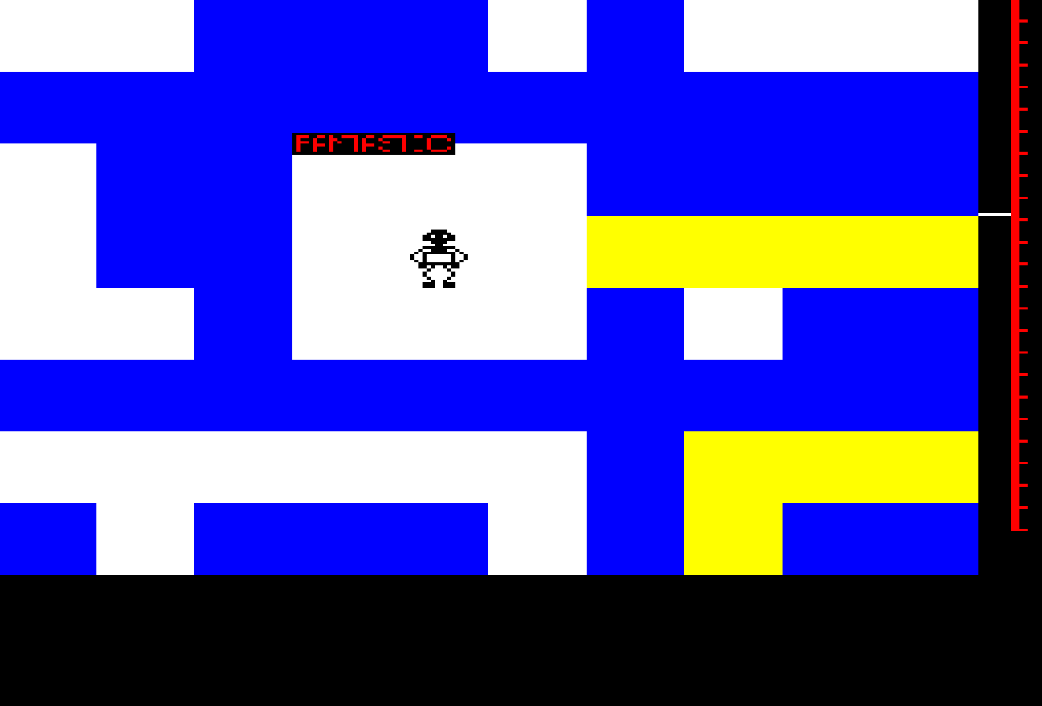

Small update on the tiles and drawing method; its complete now for the gameplay. Also reworked the maze generation, and now the game is playable and winnable.
The 256x192 ratio from the original ZX game makes it feel a bit stretched in width on the QL, so I stretched the tiles a bit vertically, but Im not sure yet if this is the way to go.
Nonetheless, progress!
