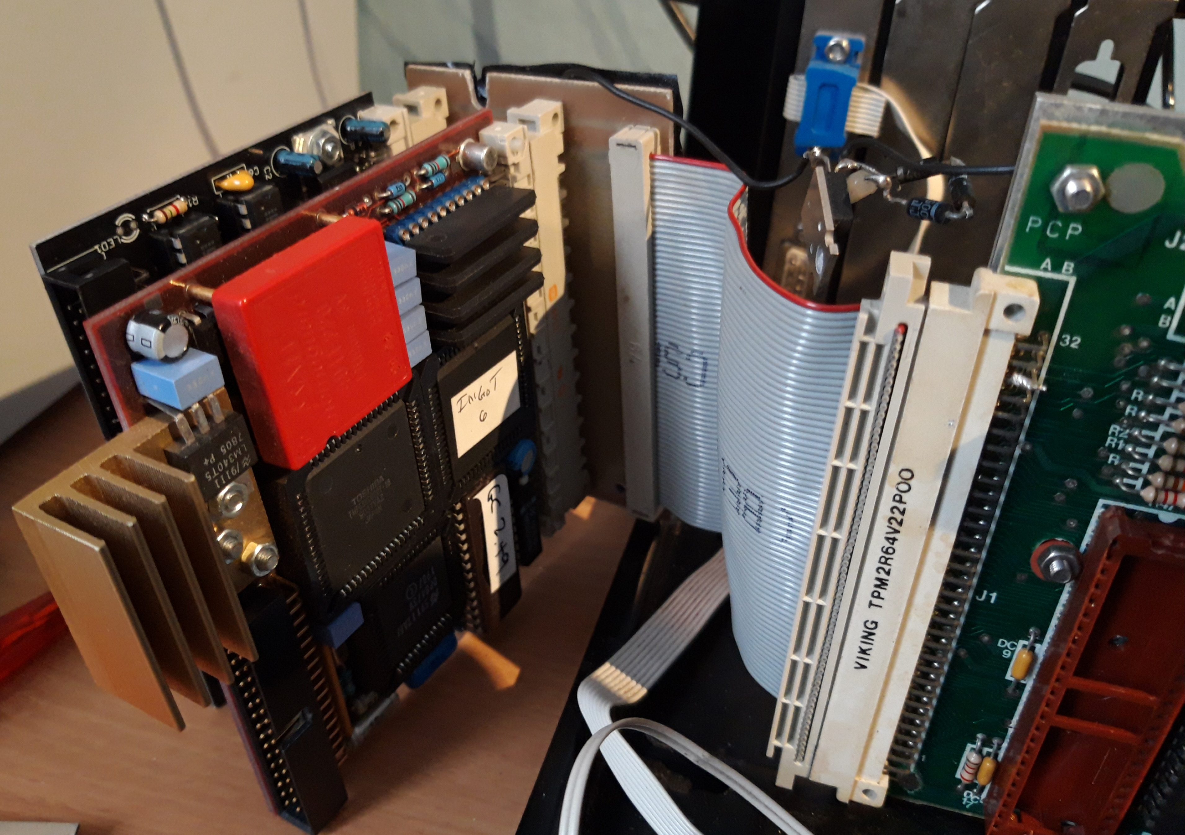

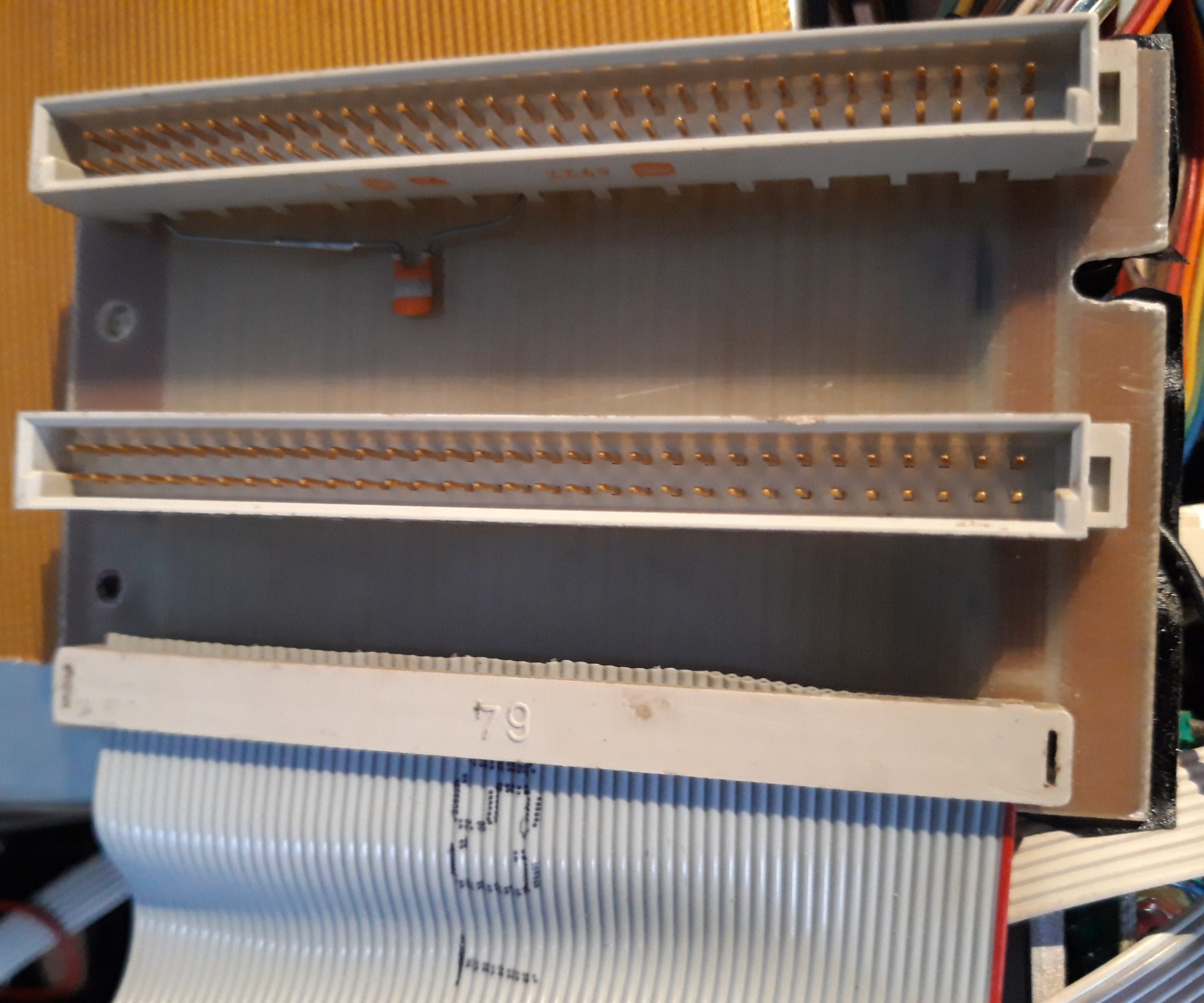

My old custom cased QL has an old backplane with 2 connectors. Originally one connector contained a Gold Card (original) and the other an ABC Elektronik MFM HDD card. And both did work together fine previously.
The MFM drive and/or the ABC card (or the OMTI card that the ABC card is plugged in to) stopped working. HDD not recognised. So instead of messing around with the very large and very loud 20mb MFM drive, I got a QubIDE kit from Tetroid. I built that and got it working with a real IDE HDD on my other QL which has a Tetroid backplane and original SGC. Created/formatted a partition, win1_ present etc.. all fine.
Popped it all into the custom cased QL and it simply doesn't seem to recognise it but sees the GC fine. Swapped the cards over and the GC is there again but the QubIDE still doesn't show up on the boot screen. The backplane has a separate 9v being fed into it, which works. Without the GC (had to put the 68008 back in for that) the system recognises the QuibIDE but is unable to link to win1_, which may or may not be related. So both slots work, both cards work, just not together. QubIDE is set to the correct address for use with a GC.
What can I do to trouble shoot and what have I overlooked/forgotten?!
(other specs: There is nothing on the ext ROM socket. It does have a Tetroid ROM switcher, but the upper tk2 part is turned off so shouldn't be in the way. It has Qimi and D-ren k/b addons. I noticed that with the 68008 plugged in that it doesn't boot at all with the GC plugged in, I get a white screen - at least I think it's a white screen - I'm using a green monochrome monitor).

Yes. The 'main' QL has it about 3 feet long with backplane and SGC. The cased one has a GC. Due to access in the case, I can't actually plug a card in direct to the m/b port without actually removing the m/b, which is a bit of a pain.Derek_Stewart wrote:Hi,
The description says SGC on setup outside the case, inside it is a GC. Are you using two separate cards?

Just a thought, Is your 9v supply OK. If it's has a lot of ripple, then the combined load of the two cards could cause the bottom of the ripples to drop too low for the 5v regulators to handle.
The smoothing capacitors on the output line could be drying out with age.

I bet the 9v line is too low. The previous owner has a transistor and some diodes fitted which take a 12v from elsewhere on the QL down to 9v. It must have worked fine for years lile that, but it's likely that the transistor has failed I suppose.
