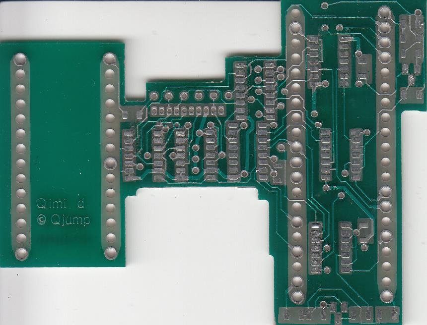

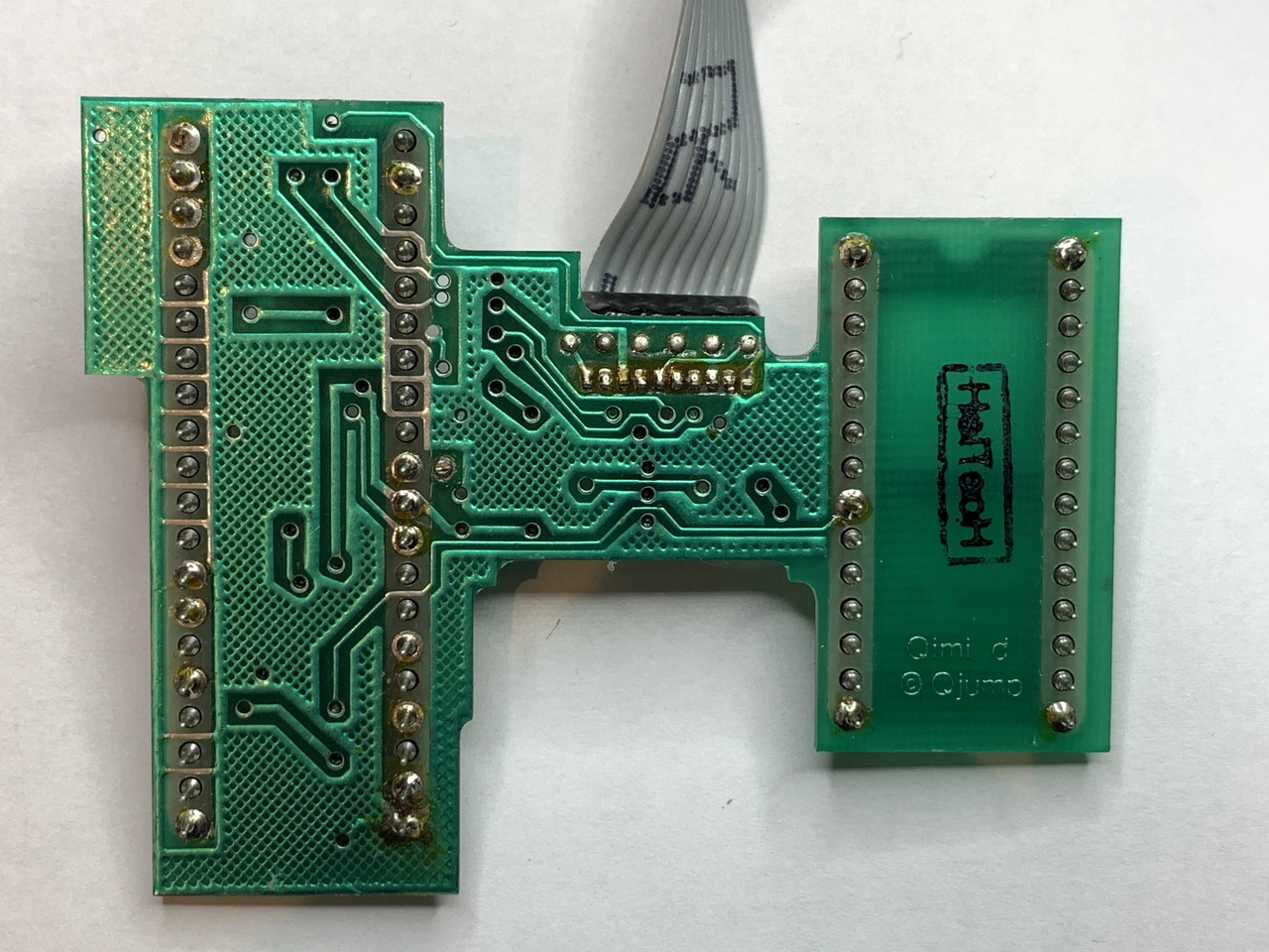

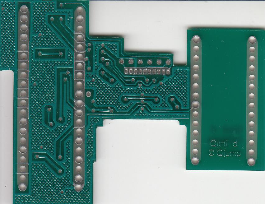

I am trying to repair a pretty beaten up QIMI interface. Some of the soldering is very ugly with solder bridges (intentional ???) missing pins etc.
Before plugin it, I want to make sure everything is as it should be... Does anybody have a good hires picture of the top and, more importantly, the bottom of the board ? There is a picture in the wiki but it is very low res. There is also a schematic on Dilwyn’s hardware page that will probably comes handy.
Thank you.

If no one has one already out of a QL system I could probably remove mine tomorrow and do pics. The whole system is in a custom XT case. Two birds with one stone - I do keep meaning to fit a QubIDE and IDE harddrive (the MFM one died).
Re: QIMI interface repair
There's (allegedly) some photos of a QIMI pcb (both sides) in this document, not checked it to see what the quality is like though. http://www.dilwyn.me.uk/docs/hardware/ql-platinen.pdf
I don't know if the QJump and Quanta versions of QIMI had the same PCB layout - the QJump ones have the name QJump on the PCB, but I don't know about the Quanta ones.

Thank you Marcel and Dilwyn for the PCB pictures, that is exactly what I was looking for.

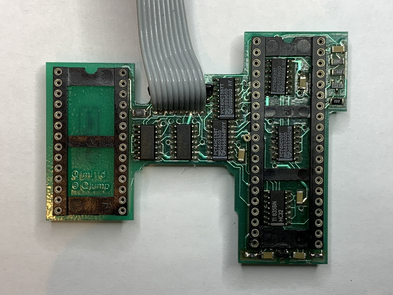

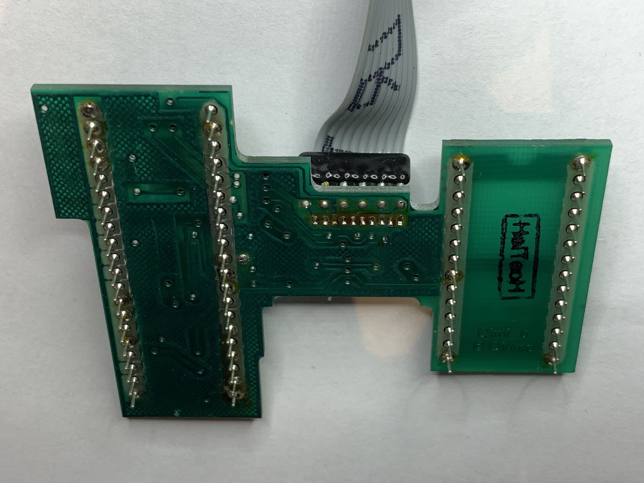

Chr$, if you ever open your Goldcard QL box, I would also be interested to have pictures of the populated board. For example my QIMI is missing the pin that goes into the top right ZX8302 socket hole. I have serious doubts it was designed that way... unless pin#40 of the zx8302 serves no purpose.
if memory serves me - pin 40 was the battery feed to the ZX8302 clock. That pin on the QL is just connected to 5v - so probably not present, so that the battery can power the RTC.

I checked my 5 QIMI interfaces, one had pin 40 on the 8302 connection with no pin and tspe over it.
I will have check if this works.

Actually one of my QIMI seems to work. Yay! Not the best solder work that I've ever seen but good enough apparently.
Pin 40 of the ZX socket is cut under the board
