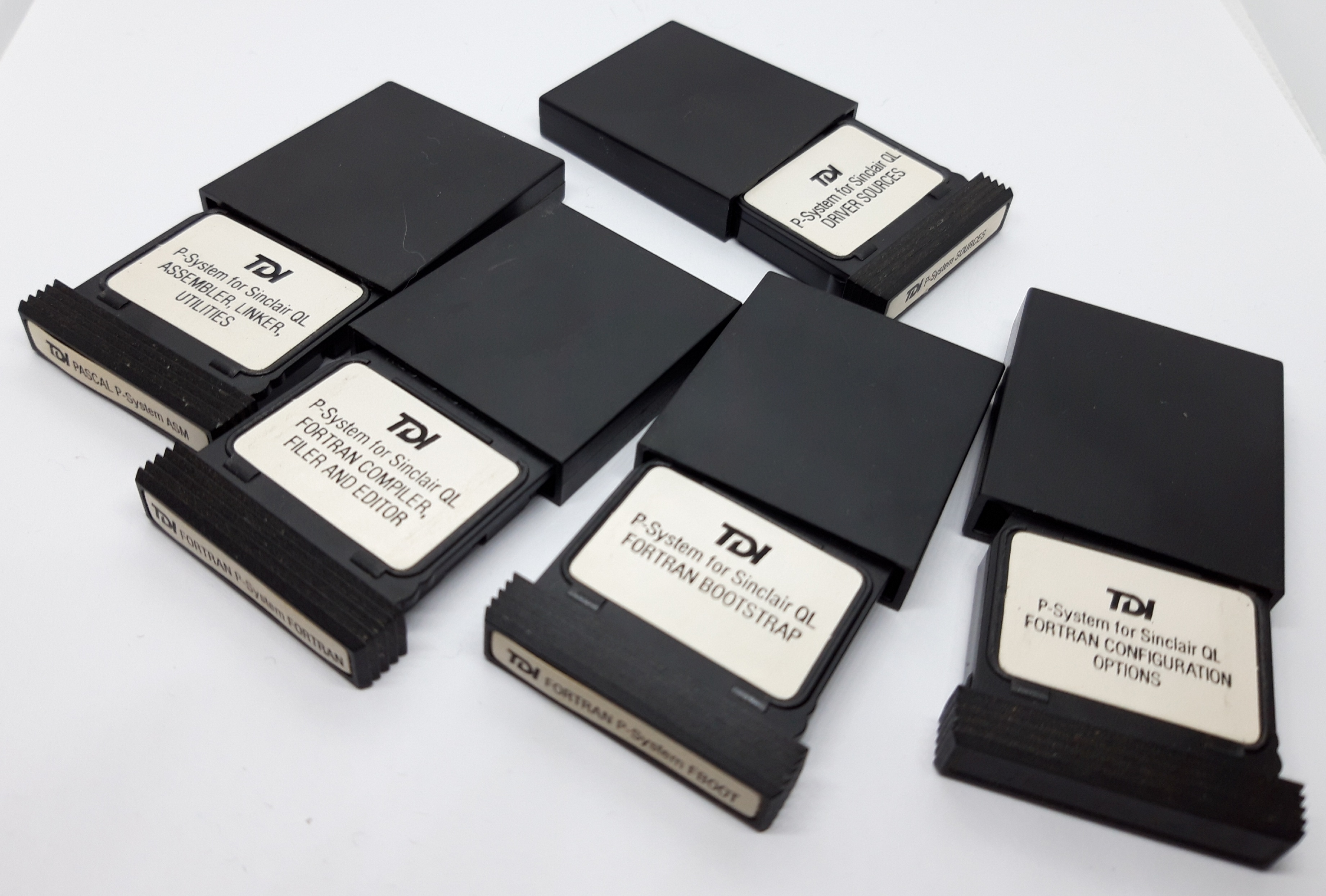

I have these, recently purchased from a seller in Germany. He had 10 in total but I was only able to nab 5 of them, so there are another 5 of a similar flavour out there somewhere.

I have no idea which TDI product these carts were originally part of. I have no paperwork or packaging. For posterity, as these are listed as MIA on the wiki, here are some details:
1. front label: TDI PASCAL P-System ASM, top label: ASSEMBLER, LINKER, UTILITIES, cartname: asm, contents: one 'psystem' file 102848 bytes in length.
2. front label: TDI FORTRAN P-System FORTRAN, top label: FORTRAN COMPILER, FILER AND EDITOR, cartname: fortran, contents: one 'psystem' file 105920 bytes in length.
3. front label: missing, top label: FORTRAN CONFIGURATION OPTIONS, cartname: fmisc, contents: one 'psystem' file 102336 bytes in length.
4. front label: TDI P-System SOURCES, top label: DRIVE SOURCES, cartname: sources, contents: one 'psystem' file 104896 bytes in length.

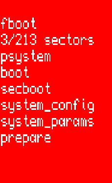

5. front label: TDI FORTRAN P-System FBOOT, top label: FORTRAN BOOTSTRAP, cartname: fboot, contents (see image):

All the cartridges have a few bad sectors. One sector in the first one is also completely missing from the dump... the sector header must be corrupted.
Unfortunately, the partial reads of the bad sectors don't look empty, in the sense that they contain varied data rather than a single value or short repeating pattern.
I'll try the Merge function, but at the moment it only works for cartridges with identical sector maps. If that's not the case, I'll need to add some logic.
