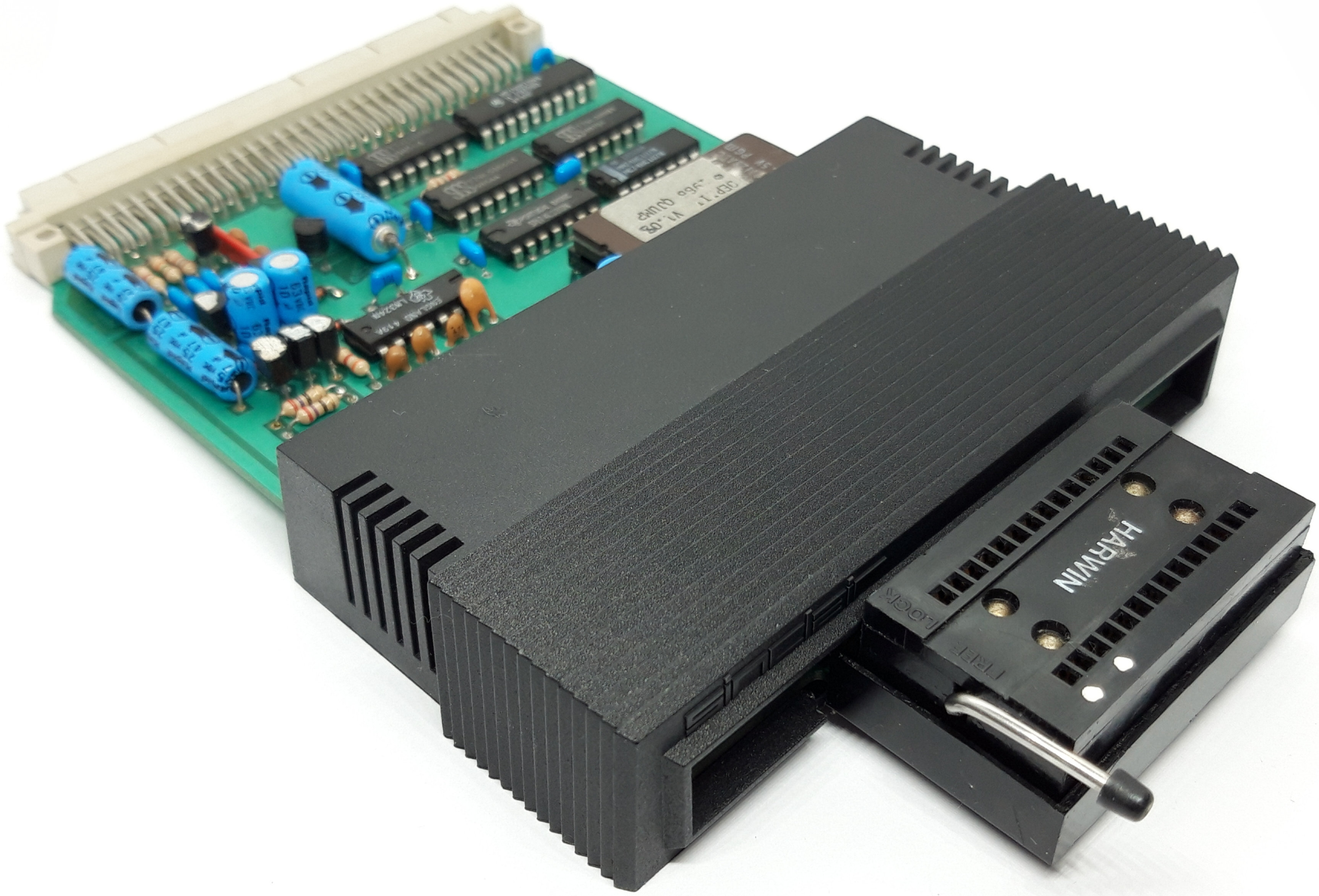

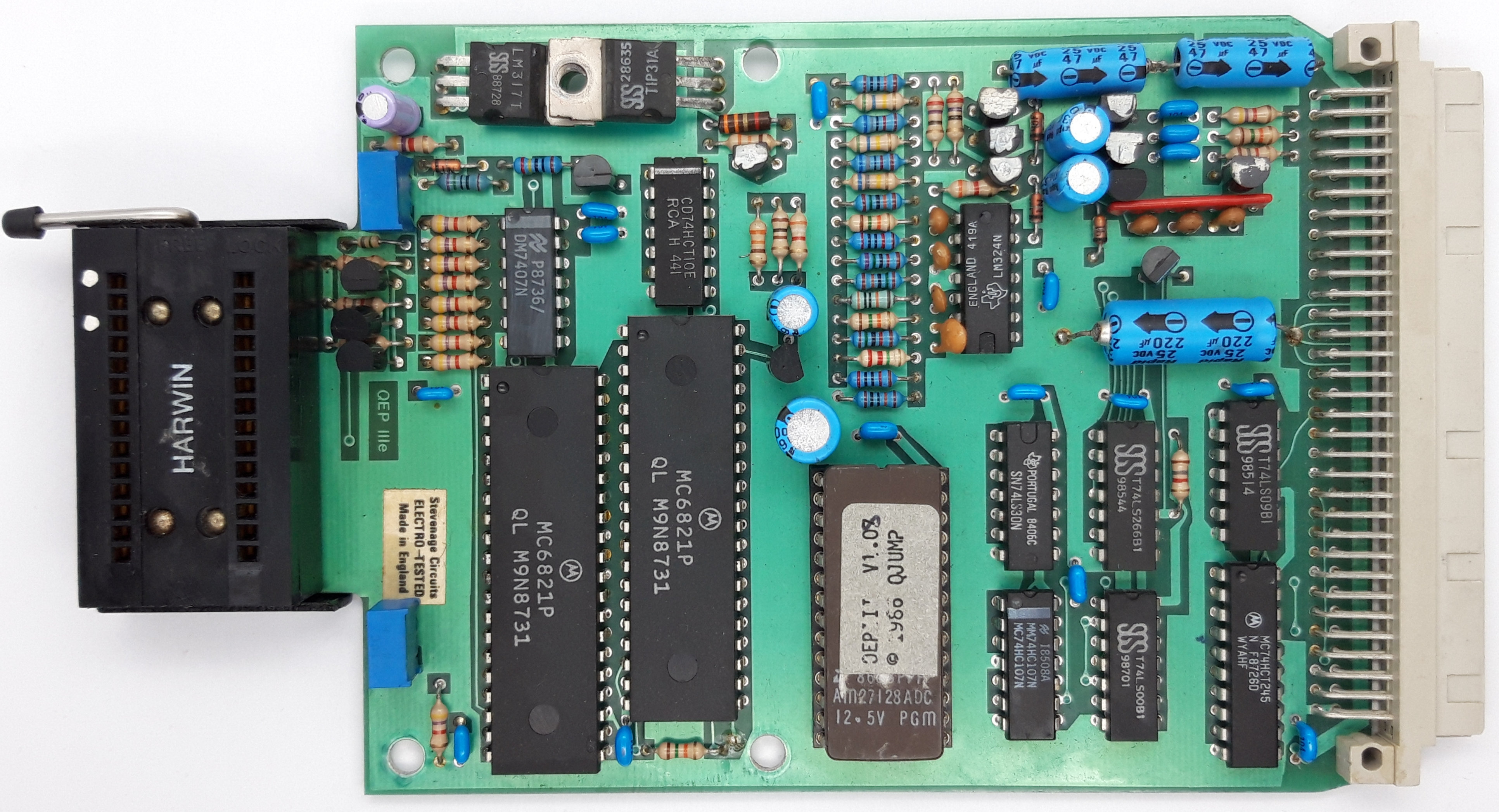

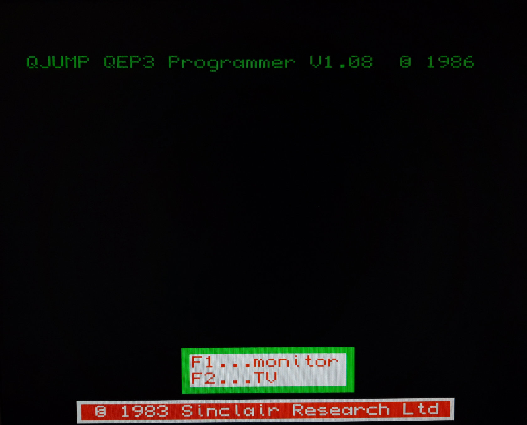

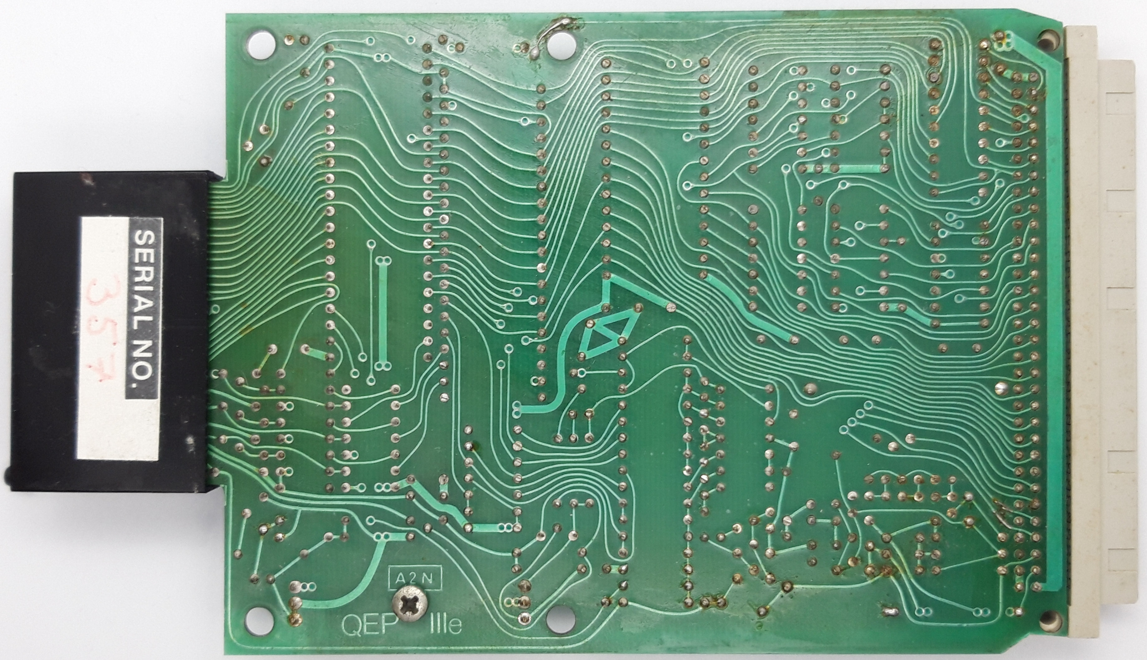

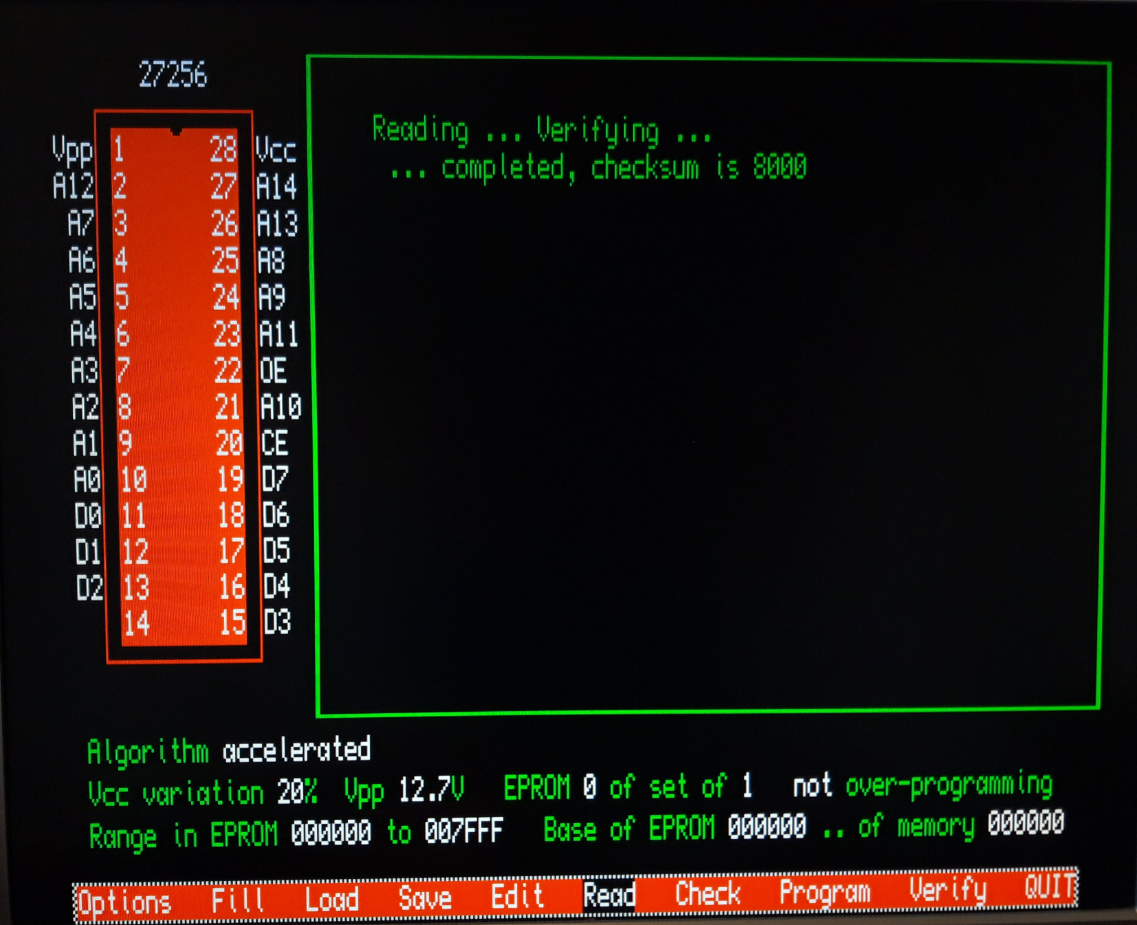

A recent acquisition. Here are some pics etc. It seems to work; at least so far I have read 27256 and 2764 EPROMS but haven't programmed anything yet. It didn't want to read anything at all while plugged in to a bus plain with an SGC and TDI, but is fine on its own. I haven't been able to get it to read/check a 2564 yet, which is a shame as the compatibility with the 2564 (which requires 25v) was something I was hoping for, as none of the modern EPROM programmers can burn 25v chips. The ZX Interface 1 uses a 2564.
It has a green PCB with hand-drawn traces, the plastic shroud is Sinclair branded. As you can see in the pics of the top of the PCB (taken without the heatsink), the 2 Motorola MC6821P chips have 'QL' on them.
Front angle (SINCLAIR branding): Bottom of PCB: Top of PCB (heatsink removed): It is recognised!: Reading a 27256: Perhaps my 2564's are dodgy.
