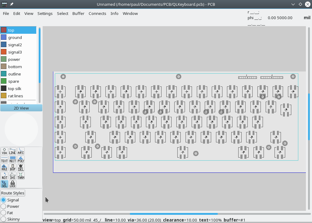

My route was more simple and requires no mods I think to just replace the metal plate with a PCB. However I am an electronics engineer and we are known for always getting the size of the box wrong. I measured things up and think a pcb with surface mount switches as pictured would fit. It looked like a simple task with comparable cost to a new membrane so it seemed a no brainer. Then the woes started and have been running over the last three weeks. My old PCB software decided not to work any more after I had spent time positioning the mounting so I thought rather than fix the software I would kill two birds with one stone and learn how to use gEDA because it looked like you could import a Gerber layout easily and I use Linux these days. It turns out gEDA is full of bugs on Linux and I am now stuck in the middle I have made the foot print of the switch, placed them but can't get a netlist in to PCB to route it. Part of the reason for trying gEDA is it has autorouting and facilities that I thought would be ideal for the simple keyboard layout. I have spent too much time messing around with it now so I think I will go back to my old software. I ended up manually editing the netlist and the PCB file that are all text files to make all the components line up but still the PCB doesn't want to connect the parts with the netlist. All the instructions for PCB say you might need to go to the command line that has more options that doesn't exactly make gEDA a suite it is more a collection of unintegrated programs on Linux. :( At least I stopped myself from throwing the computer or myself out the window from frutstration. The switches were 100 for £5 and click although there are silent ones of the same size that might prove better if the rubber under the keys folds before clicking the switch but I won't know until I try it. If the PCB ends up being £10 the total cost would be £15 plus labour so a bargain for me for a keyboard that doesn't rot. :)

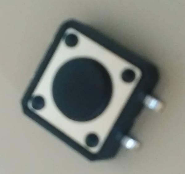

I bought the switches from here
https://www.ebay.co.uk/itm/12x12mm-Tact ... 2749.l2649
and I did get a datasheet for what I thought was the switch but it isn't on this computer so I will post it tomorrow if I didn't toast it in the upgrades like I did with some other stuff.
The whole point of me doing a noddy PCB was so I could learn how to work Kicad whicih I can't do if you do the PCB. :roll: I did the footprint for the switch in PCB under EDA but I don't have that installed so can't open the attached file to check if it is the final one. I arranged the footprint so it could take 12mm and 6mm switches as well as click or squidgy for flexibility and because I wasn't sure if the QL membrane was man enough to push the click one or stay capable of doing it. I call this a noddy keyboard because it was never intended to be a daily used unit since I know these click switches don't last that long and don't compare to Cherry ones. however I envisaged the squidgy ones would last and might be a better unit at a similar price. I the squidgy switches worked like a membrane then the PCB would be a viable membrane replacement with practically no cutting of the QL box I thought but there is is still the electronics engineer doing the mechanical engineering element. :lol: The standard joke being "don't let the electronics bloke pick the box it will be either was too big or small".
Are you sure you have all the holes and the keys in the right place on your board?

I struggled a little with gEDA, mainly due thd tutorials being out of date. I liked PCB-RND, rather PCB.
Imainly use KiCad, which installs quite easily and is a more obvious way of doing the CAD work flow. But that said, I can see rgd gEDA workflow is nearly the same, except all the applications are separate and is more suited to the Linux command line to issue to edit the schematic, generate netlist, create PCBs, generate Gerber files.
The KiCad Gerber viewer, gerbv allows importing of Gerber files and can generate a pcb project file that PCB-NEW can load. This defines the PCB track structure, but does not have Netlist, so there are no associated parts, to link to schematic.
This sort of reverse engineeri g of PCB project, is outlined in Altium Designer, which I have copy running on a Windows PC, but I hardly use Windows, as Linux does most things for me.
I will look at the keyboard switch footprint, I was going replace the membrane with switches on a PCB attached to the bottom of the keyboard case, so as with your idea, no cutting of the case, as with the Schon keyboard.
