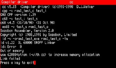

I try to run the simplest program "Hello world" , in C68 ansi C, I got the message
ld:Error 0
Out of memory
Use 620004ption (- with cc)
To increase memory allocation.
My Ql has trump card 896K and 720K floppy.
I cannot find this option in QC8 manual.
Any help?

Hi Michael,
Can you post the C68 source file and the command line you used to compile the C68 file.
The simple hello world programme should be compiled by entering the command:
EX cc;"-v hello_world_c -o hello_world_exe -lm"

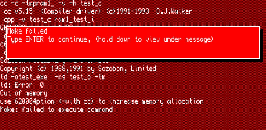

Here is the code
#include <stdio_h>
#include <math_h>
#include <stdlib_h>
#include <time_h>
main(){
printf("Hello world\n");
return 0;
In QPC2 it works perfect but in real Ql and Qemulator does not.

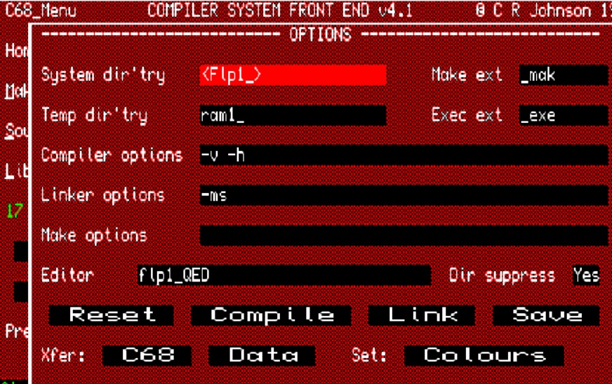

I've not used C68_Menu, so I don't know if it has any issues. To eliminate it as a source, please use C68 from the command line and see if you get the same compile error.
BTW, you don't need math_h or time_h for this simple program.
Tim

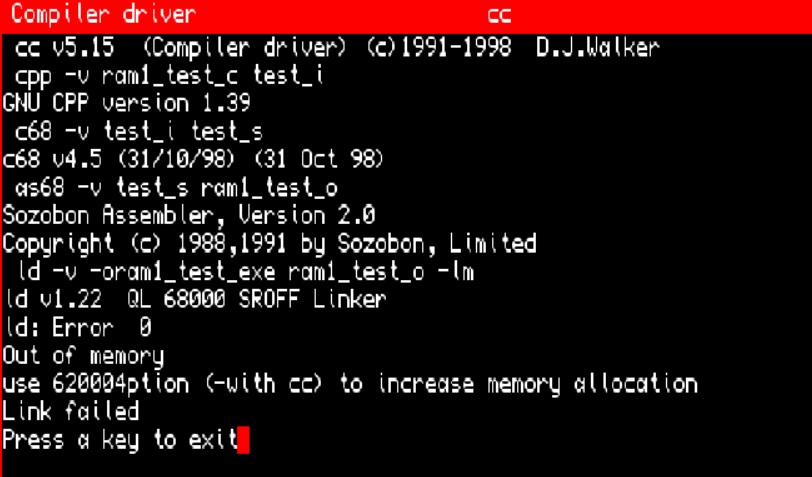

I set my Tetroid Trump Card up and was able to repeat the error message.
The clue to the solution of the problem is at the end of the linking operation.
The Linker is running out of programme space to complete the operation. I you read the LD part of the C68 manual, at the end of the section, there are a description of memory buffer options.
The -bufp is the required option to use, I tried 32K which maybe too much.
The ammended command line is :
EX cc;"-v hello_world_c -ohello_world_exe -bufp32K -lm"
this now compiles on the Trump Card correctly, to exrcute the the co piled programme:
EX hello_world_exe
The LD options can be set in the command line or the environmental variables, see documentation for this.

Well, I'm a bit puzzled that a simple program like the example here should need extra memory for the linker. I've never had to add memory for the linker, ever, and I've compiled some hefty programs on a BBQL - the Quanta Library Guide is one of mine, for example.
I wonder what's going on?

I compiled the "Hello_World" programme on a Q68 running SMSQ/E v3.36, which did not need the increase in the linker programme buffer.
I tried increading the linker buffer, with the -bufl option. Which did not work, only uding the -bufp opyion to 32K enabled the programme to compile on the QL under JS Rom.
I thought, maybe the problem is JS Rom problem, so installed Minerva v1.98, but compiling the C68 programme would not compile till the bufp option wss increased. Strange it is not required on SMSQ/E.
