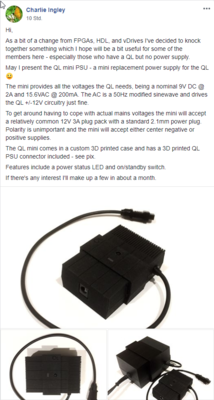

As many here are not member of the QL facebook group I relay Charlie Ingley's new power supply prototype. Looks to cool to not share ;)

Will the 50Hz screw up 60Hz QL's? It looks like from what I read it should be fine for electronics as long as the voltage is but what about things that require timing like microdrive motors or the oscillator?

Timing is not derived from the AC voltage, that is all from the crystal.

In the QL, the AC feed is immediately rectified into DC. This derives +12V and -12V. The DC feed is immediately regulated to 5V for running the system. There's nothing in the QL that relies on the AC frequency. A QL will happily work on AC from about 38 Hz up to around 225-260Hz without problems.
Charlie Ingley's solution is interesting. It creates a modified sine wave, even though there's no need to do so. An AC square wave would be more efficient. However, a modified sine wave raises the noise floor of the switching frequency above anything that might push through the elderly caps on the QL.
His goal price is VERY reasonable.

...the ‘modified sine wave’ [used] is basically square but with an extended zero crossing duration.
