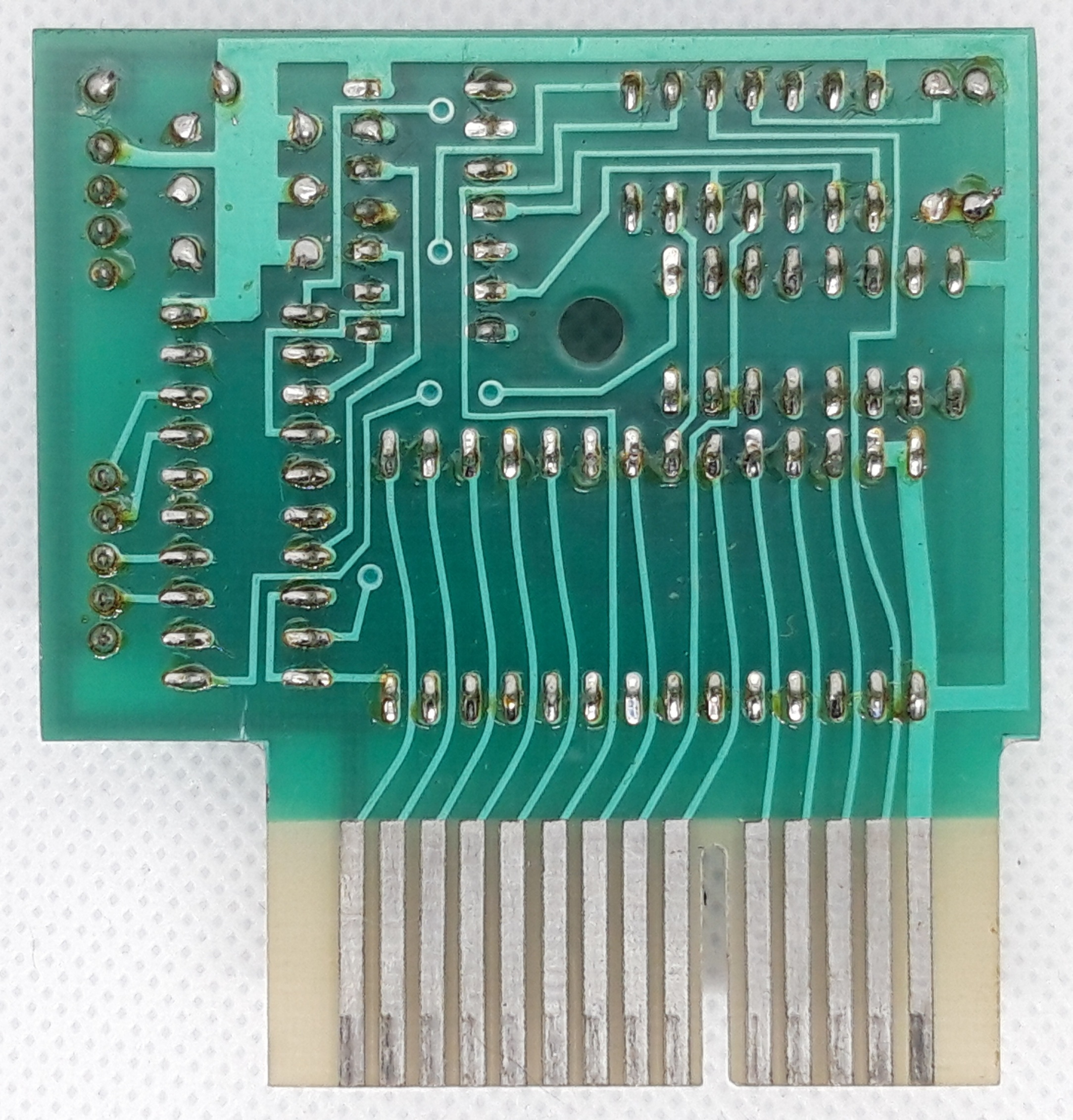

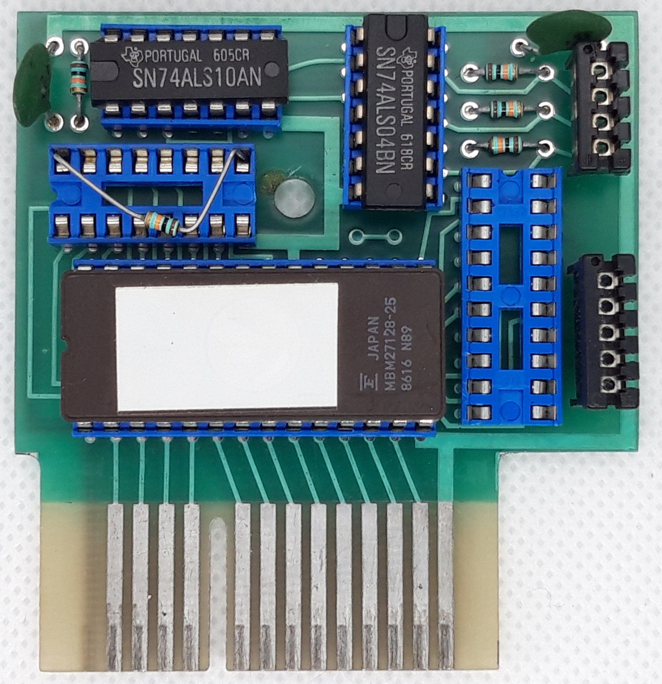

This is what the PCB looks like:
Just a 27128 Eprom, couple of 74X, and stuff.
Am I right in thinking that I could burn something else (e.g. TK2) onto a 27X Eprom, plug it in and run it from this? Or is the circuitry in some way specific/unique to the MICE device?

It is a 16K eprom, which will be mapped into the upper portion of ROM space between 0x0c000 and 0x0FFFF (so above the 48K OS ROM), but it must also map some hardware I/O in that space too for the mouse

I was wondering what the two empty IC sockets was for. Found a circuit diagram on the first German link above.
One's the address decoder, which has been bypassed. The other one looks like more inputs. More mouse buttons?

So my Mice device was the version that never had a mouse! I see.
