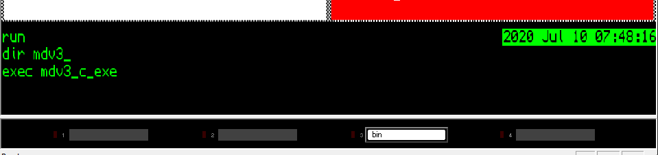

I've found this assembler example in the Adrian Dickens "QL Advanced User Guide" book and was able to compile it successfully with vasm.
However when I run it using Qemulator it hangs and shows nothing. What's wrong with it?

Did VASM produce an executable programme, I assembled this clock programme with QMAC and output an executable file.

Derek_Stewart wrote:Hi,
Yes it did, I used it successfully for my other "experiments" (borrowed from Keith Hello World https://www.youtube.com/watch?v=xRNiethed1w)
I run my code using a standard procedure similar to this snippet:
5 CLS
10 start=RESPR(32768)
20 LBYTES mdv3_bl_bin,start
30 CALL start
Did you succeed to run it?

Wow, respect tofro, you are my hero and I've learned a lot :idea:!
I have done all you proposed and the clock works now 8-) :
Thx, Adam

Derek_Stewart wrote:Did VASM produce an executable programme, I assembled this clock programme with QMAC and output an executable file.
After explanation by tofro I now understood you question :D and you were right, vasm is not able to produce an executable programme... I had to convert my binary first.
