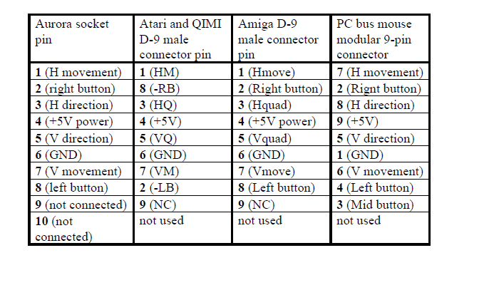

In the Aurora manual there is a nice lovely section on the mouse port numbering - but it has left me even more confused than ever!
I understand the IDC header numbering goes odd down one side of the connector and even down the other side - so the idc cable would then be 1-2-3-4-5-6 and so on, (only first 8 connected)
BUT - when it gets to the 9 pin D shell - the numbering for Amiga and Atari mouse don't seem to match completely with what I've seen on the various forums for each mouse type.
I see on Marcels site that you can switch between Atari and Amiga by just swapping one and 3 over from the 9 pin perspective (which is effectively swapping 1 and 5 from the Aurora connector?)
Does anyone know if that will also work for the cocolino Mouse adaptor that converts PS/2 mouse to Amiga format?

Keep in mind that conventional D-connectors existed before the idea was thought up of making IDC versions that could connect to IDC cable. Hence the numbering gets a bit confusing.
Atari, Amiga, Acorn and some early PC mice are ‘bus’ mice. Two TTL digital lines are encoded with square waves for each direction, (so two lines for the X direction, and two lines for the Y direction) plus the button inputs and +5V and 0V/GND.
But the various different manufacturers were not consistent in their pin allocation. With the Atari and Amiga, just two signals need swapping around to change from the Atari pin-out to the Amiga pin-out or vice-a-versa.
The same would apply to any standards converter that goes from PS/2 or USB to an Atari pin-out or to Amiga pin-out if you wanted to use said converter on a different system from the original intended system.

Looks like it's pins 1 and 4 that need to be swapped for Amiga Mouse - which would be 1 and 7 on the IDC cable H and V movement swapped for Amiga
so straight through IDC is for Atari - not Amiga as documented in the Aurora manual...
