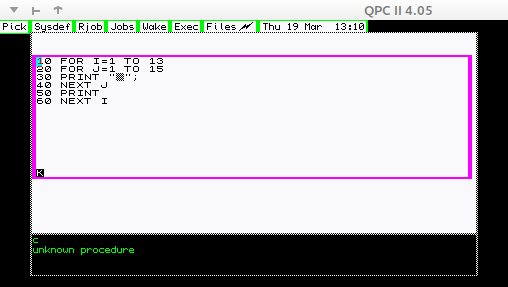

BTW, I finally figure out how to convert a .wav file to a .p file and then into text. The last part there are two tools, one is a command line one called zxtools.exe which yields the text below and uses the special escape characters for graphics.
   10 FOR I=1 TO 14
   20 FOR J=1 TO 15
   30 PRINT "\##";
   40 NEXT J
   50 PRINT
   60 NEXT I

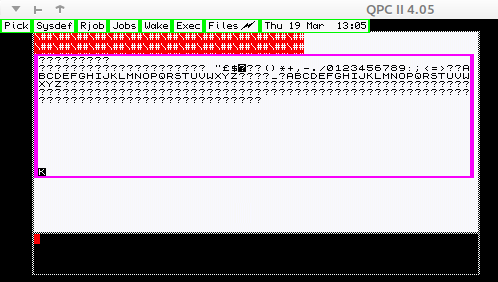

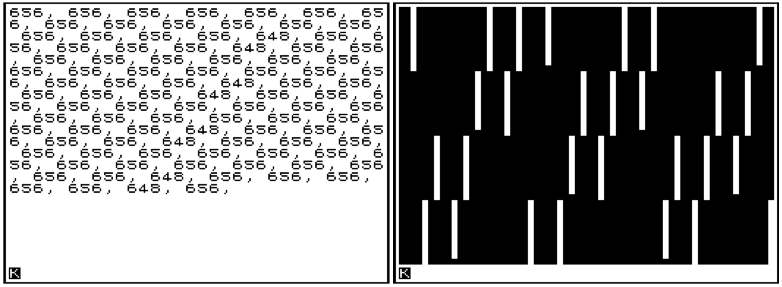

So I spent a little time looking at the ZX81 characters and it looks like at most the letters, numbers, and symbols are 7x7 (always leaving the first row and last column free):
I created a mask (enlarged 4x below) and it looks like only 40 pixels are activated so using 5 bytes to store each letter, number, and symbol should work:
My initial attempt will be to do this using the block function since then I can quickly get it up and running, see how slow it is and look to making it speedier. I realize that likely I may have to do some assembly coding to muck with the character set but for now I just want to get my BASIC interpreter to look like a ZX81, even if it's slow.
Posts: 1606
Re: ZXSimulator
Ok, I have the character set working (this excludes the 11 graphics characters). Not optimal speed-wise but only 5 bytes for 64 bits of information storage-wise (270 bytes). Give it a try and you'll see the ZX81 displayed. Next I'll integrate it into the BASIC interpreter just to see how fast it runs displaying the new font.
test2.zip
(4.39 KiB) Downloaded 499 times

Posts: 1606
Re: ZXSimulator
Here is the full ZX81 character set test program, both executable and Digital 'C' source code. To recompile it you simply type (assuming a win1_ device that it is all located in):
exec win1_cc;"win1_test3_c"
exec win1_cg;"win1_test3 win1_test3 -nc"
test3.zip
(5.26 KiB) Downloaded 513 times
The code below (included in zip file). You'll see that for the inverted 64 character (the ZX81 has 128) I just flipped the paper and ink values from 7/0 to 0/7. The only place I didn't do that for is the simple block ones since it was faster drawing the combination of 4 solid quarter-blocks than playing with inverse video.

This is modeled after the following escape codes, graphics, and formatting conventions for inverse video and graphics characters:
http://freestuff.grok.co.uk/zxtext2p/index.html
Next I will work on merging it to the BASIC interpreter to see what the first draft will look like. I think I only have integer BASIC implemented on the QL so it will initially be more of an ZX80 simulator before I get the rest working. Still, can't wait to write a simple ZX80/81 BASIC program and see it run on the QL under this.
Posts: 1606
Re: ZXSimulator
Here is version 1.0 of ZXSimulator -- first piece of new QL software during COVID-19 self social distancing :-). It's pretty slow right now but is only 38K in size, so pretty small footprint and runs easily on an unexpanded QL.
zx.zip
(20.74 KiB) Downloaded 524 times
You can load the following code via (assumes file resides on MDV2): LOAD "MDV2_TEST_BAS"
10 for i=1 to 13
20 FOR J=1 TO 15
30 PRINT "\##";
40 NEXT J
50 PRINT
60 NEXT I
If you LIST you you will see that ZXSimulator transforms it into the ZX81 character set (i.e. the "\##").
Still lots of work to do and the BASIC does not presently match up with the ZX81 BASIC so expect the unexpected. Any feedback and/or help is appreciated.

Question, when I ran the test_bas program, it does give a checkerboard pattern, but it doesn't look like the old ZX-81 checkerboard patter I remember, I wonder if it's correct? This is the listing from inside the ZX emulator, running in QPC 4.05, on Linux Mint 19.3 64bit:
I did a quick test too, printing all the ZX-81 characterset from 0 to 255, this is what I got but I see none of the special "graphics" characters in there, should I have seen them, or is that a "still to come"?
