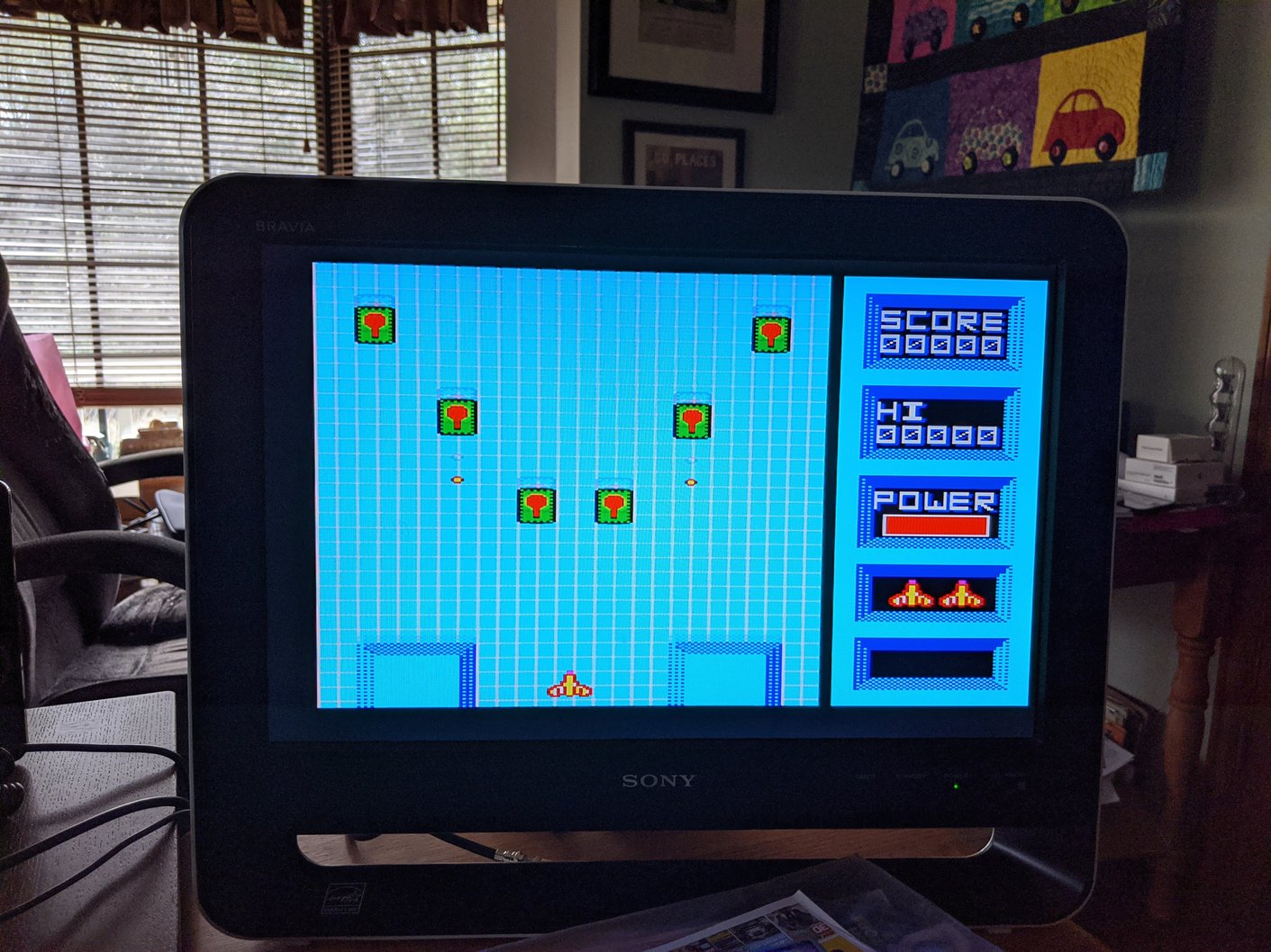

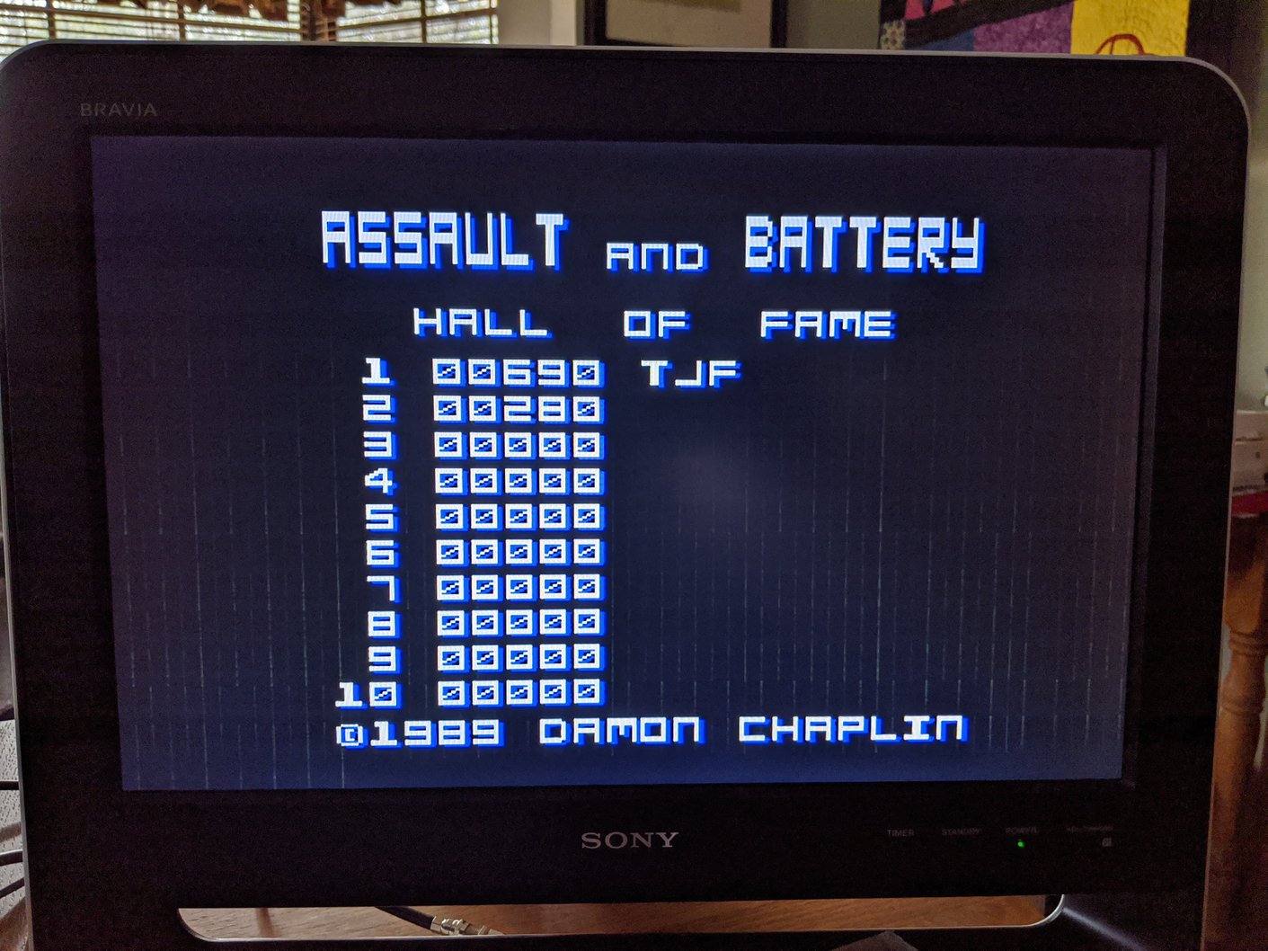

Ha... so with at least Assault, I changed the code to mdv3_ and she runs...
Almost seems I need to get this vMap device. Unless I want to change every program.
Shoot.

My first official game played on QL is Assault.
LOL
TJ
