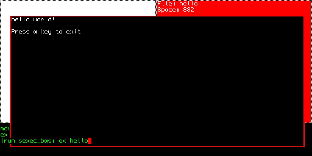

Seems almost there.
pi@raspberrypi:~/ql/qdos $ qdos-gcc hello.c -o hello
hello: dataspace 882 (372)
pi@raspberrypi:~/ql/qdos $ cmp hello x86/hello
pi@raspberrypi:~/ql/qdos $ cp hello ~/mdv2
hello executable
hello executable
Testing further...
Tom
