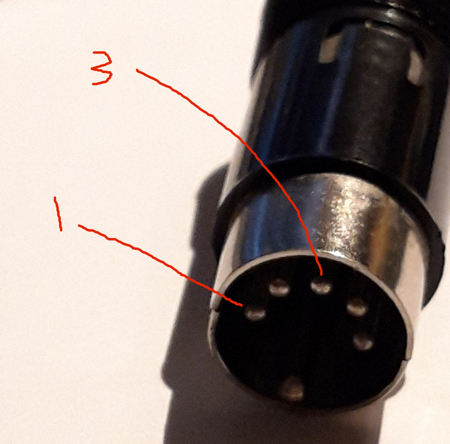

No, on my Spanish mono composite vid lead the signal is connected to pin 1 of the RGB plug and the gnd to pin 3.bwinkel67 wrote: Yes, that would be great. I'm guessing it is using pin 3 and pin 2.

I'm a bit confused. Pin 2 is ground on the RGB plug so the only combos ought to be 1+2 or 3+2. What does 1+3 give you since that connects (according to the plug diagram) composite PAL and composite monochrome?Chr$ wrote:No, on my Spanish mono composite vid lead the signal is connected to pin 1 of the RGB plug and the gnd to pin 3.bwinkel67 wrote: Yes, that would be great. I'm guessing it is using pin 3 and pin 2.

Unless European's were different. In case there is any confusion on the pin numbering....
I checked again just now. 1 goes to the centre of the RCA type comp plug, 3 to the outer ring.
