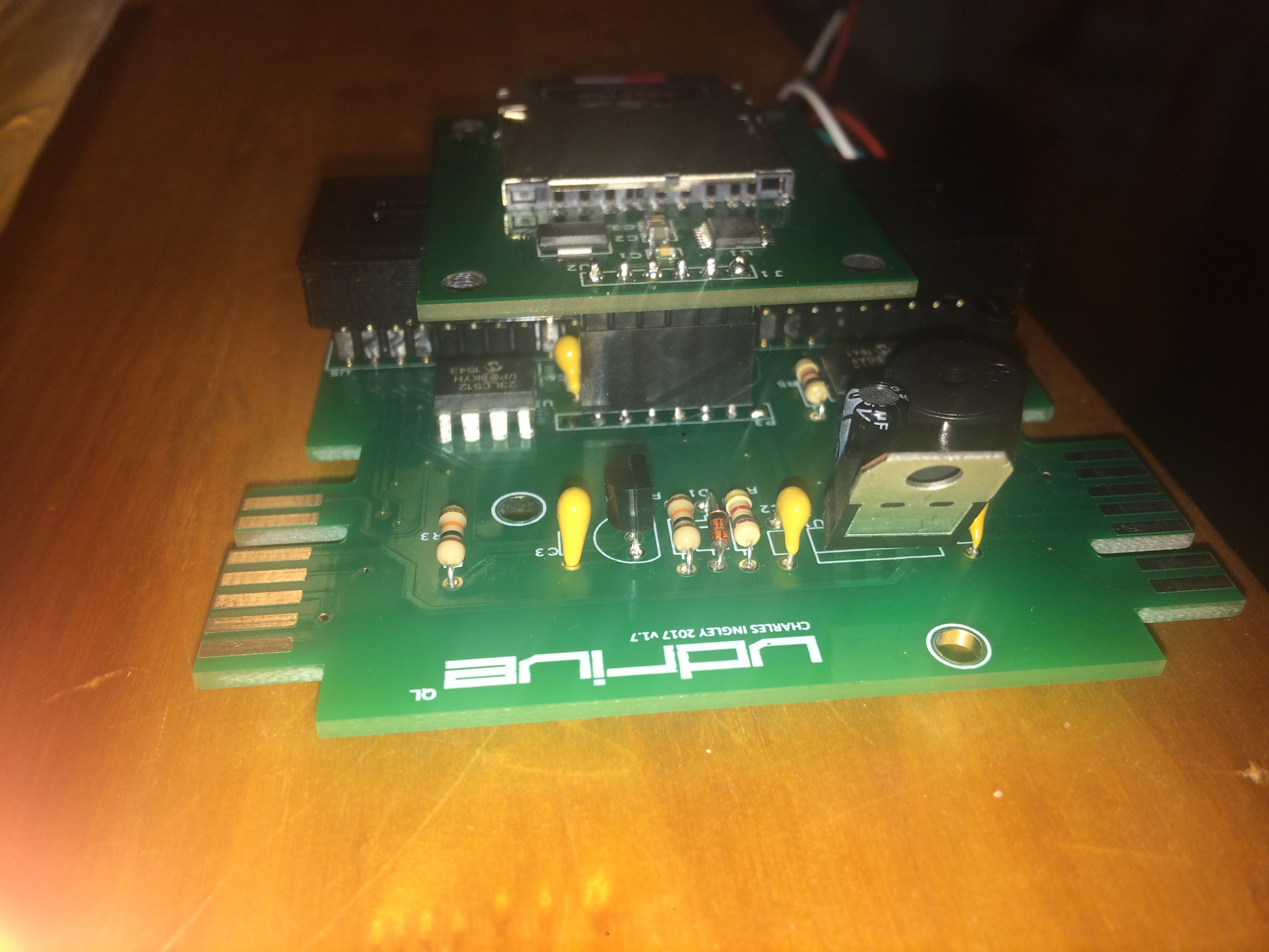

Though I have found the vDrive to be perfect SD card interface for the QL (say so long to those mechanical microdrives and those disappointed 2nd and 3rd passes that lead to that "bad or changed medium" message) I didn't like it's bulky design. I realize it was done this way to mount into exiting external cases but I was looking for something a bit more streamlined. Maybe have it look more like a miniature floppy drive similar to the SD2IEC that you can get from The Future was 8-bit for the Commodore 64 -- though obviously bigger (I don't own a C64 but keep seeing them pop on on retro sites).

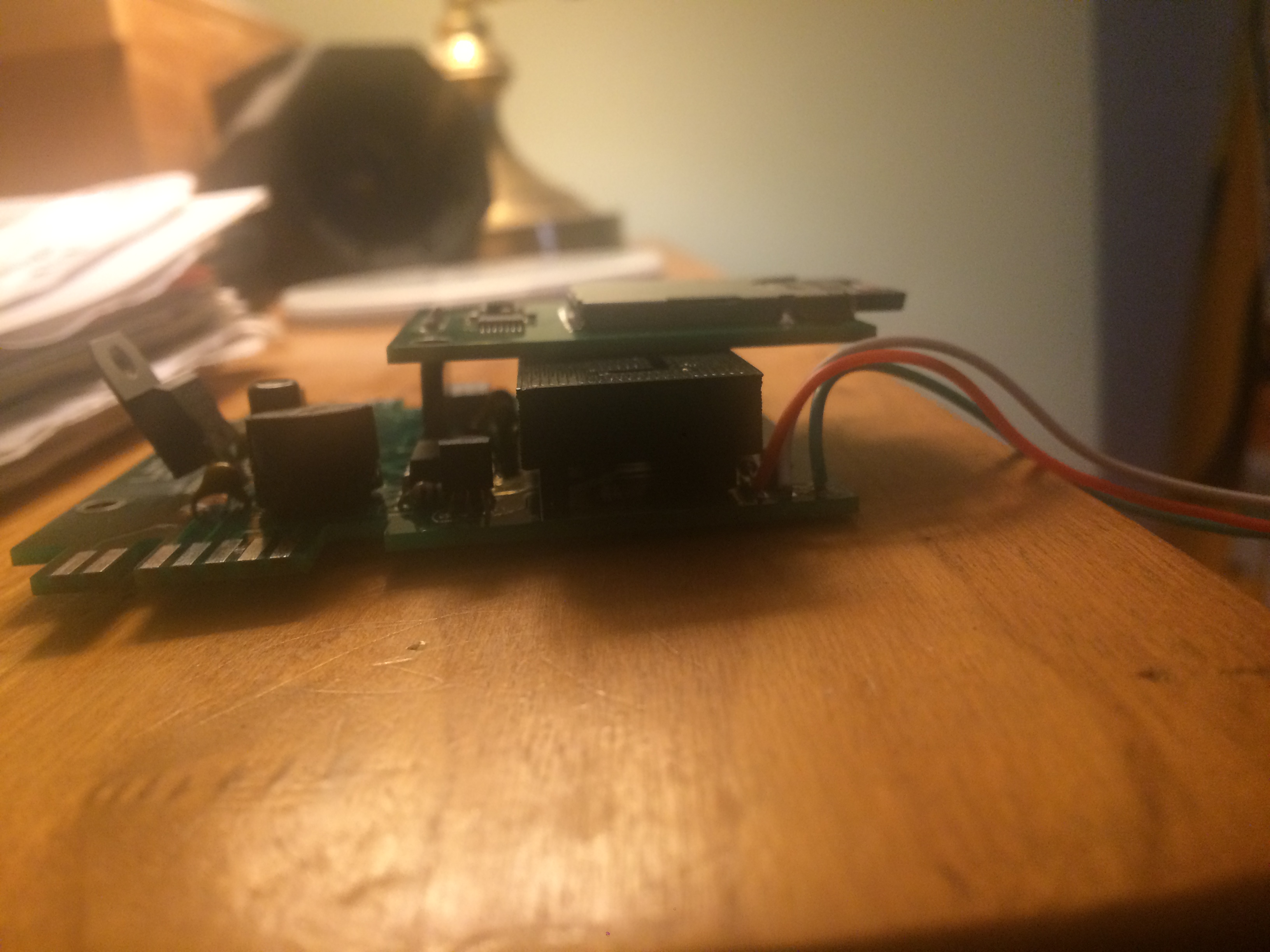

So I did a mod on the vDrive, taking the raised 6-pin socket off the main board and replacing it with a normal one. Note that if you stack two 6-pin sockets you basically get the old configuration back and can still mount it into an original case as was designed (so it's easily reversible if you want to give it a go). I now want to design a case for it in black with the QL theme and textures. Any recommendation of software to use for the modeling? I have access to lots of 3-d printers but haven't designed my own model.
Note that I plan to make the case flippable so that either you can sit it next to the QL or have it up-side-down on top of it (the accompanying ribbon cable is just the right length to do that). So the plan is to have tiny rubber feet (and indention for each) on both sides. In case this is confusing, I've included some pictures.

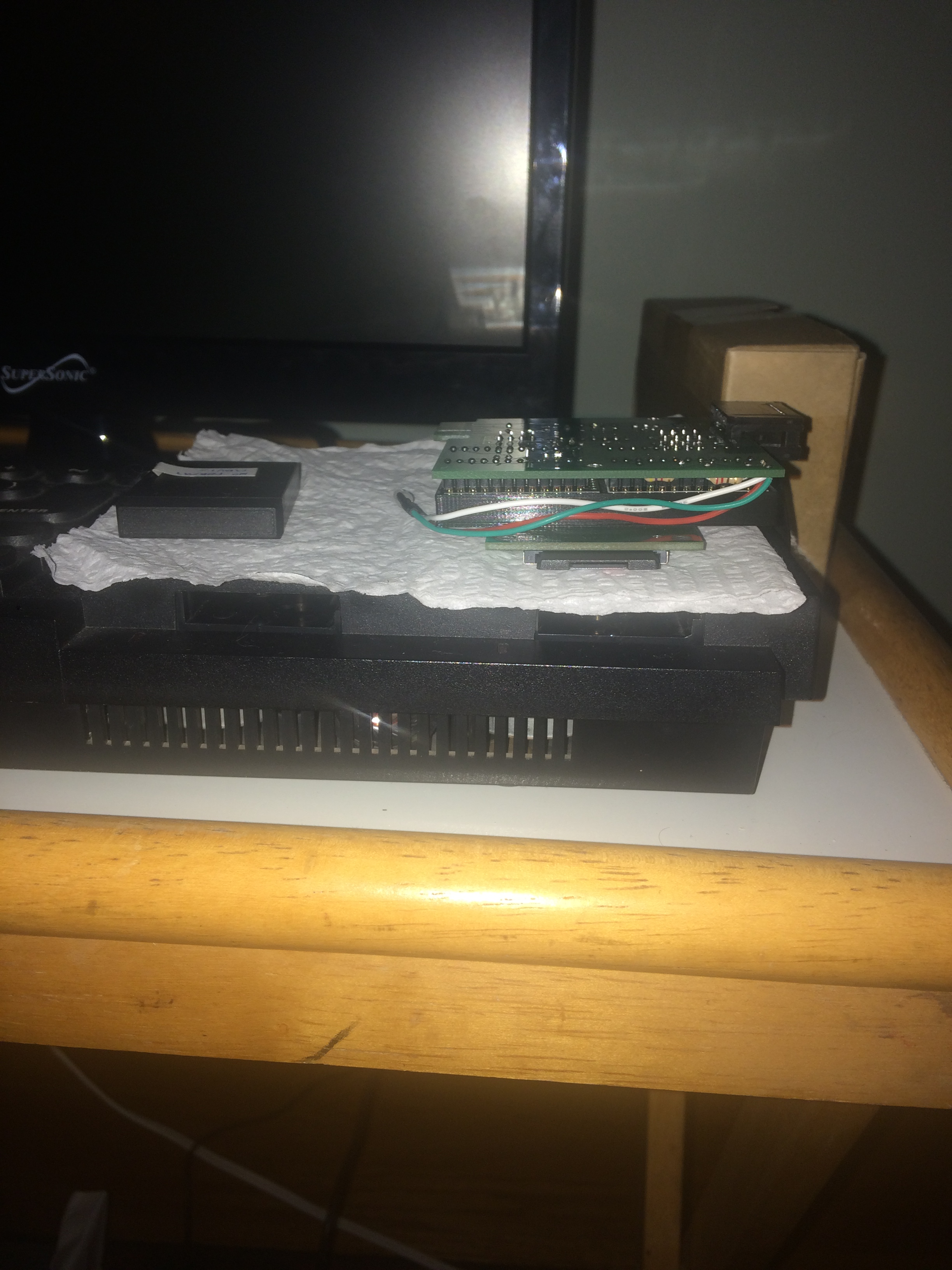

Here are some pics...the first two are of the vDrive mod and the last shows you how it sits neatly on top of the old microdrives...albeit up-side-down. I may mod it again with cables instead of 6-pin connectors so I can have it right-side-up on top of the microdrives (and up-side-down sitting next to it) -- i.e. put the daughter board on the other side of the main board but right-side-up. Any feedback to help me make up my mind would also be wlecomel as I'm on the fence on what the best configuration would be. I also recommend the vDrive if you haven't gotten it, even if you use the QBIDE interface for solid state drives.

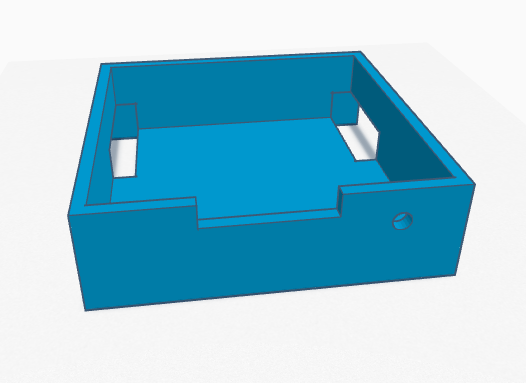

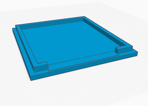

First crack of the bottom of the vDrive case (I ended up using Tinkercad which exports STL files). It would simply have a top that just covers it flush with a few millimeter internal lip to compression fit it shut. Once I have that I will think about adding features and wording to give it that QL feel. I will add 3 to 4 millimeter mounts on the inside to screw the board in with short metal screws.
The front might change as I'm not sure how the daughterboard will interact so the front slot/hole might need to be lower and become wider. I may also want to add a feature on the inside of the front to rest the daughterboard on and give it stability. I'll do it incrementally. I will first need to print this (not until next week when I'm back on campus) and then adjust and refine.
But the process in Tinkercad wasn't bad and I can see myself creating a bigger case for the Q68 pretty quickly, esp once I get all the nitty-gritty details of this down.
Any suggestions or feedback is appreciated...note though that I do want to keep it as small as possible. Plus I want to be able to flip it upside down so that's why I'm keeping it a square shape (or symmetric might be a better word). I don't like that there is so much blank real estate below the front slot/hole so maybe I'll make that bigger to have it look a little better.

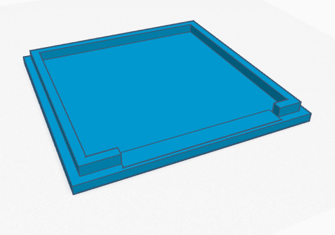

[EDIT: created the top part]

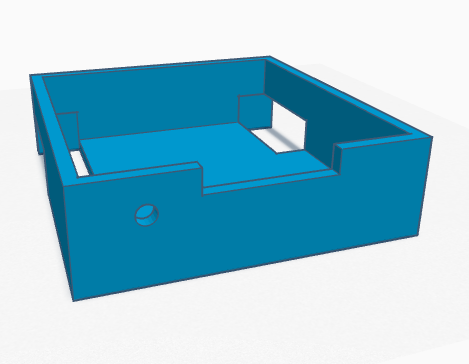

Also, I think I finalized my first draft. Shrunk the case a bit more after re-measuring the circuit board and moved the hole for the light to the other side since I had the slot centered wrong (mirroring can be confusing). I will print and fit the board early next week and then add mounting posts to the design to hold it in with screws and maybe a small lip to hold the daughter board. I did add 1 millimeter recessed 5 millimeters wide depressions on both top and bottom of the case to hold rubber feet (I want them pretty low profile).
What's left is to add some design elements...I'm thinking maybe some 1 millimeter recessed grid lines on one side of the case to form a grill ala QL case and perhaps some text, etc...that part may take a bit of time. I will say that Tinkercad is easy to use -- let's hope the STL files will convert to print.
