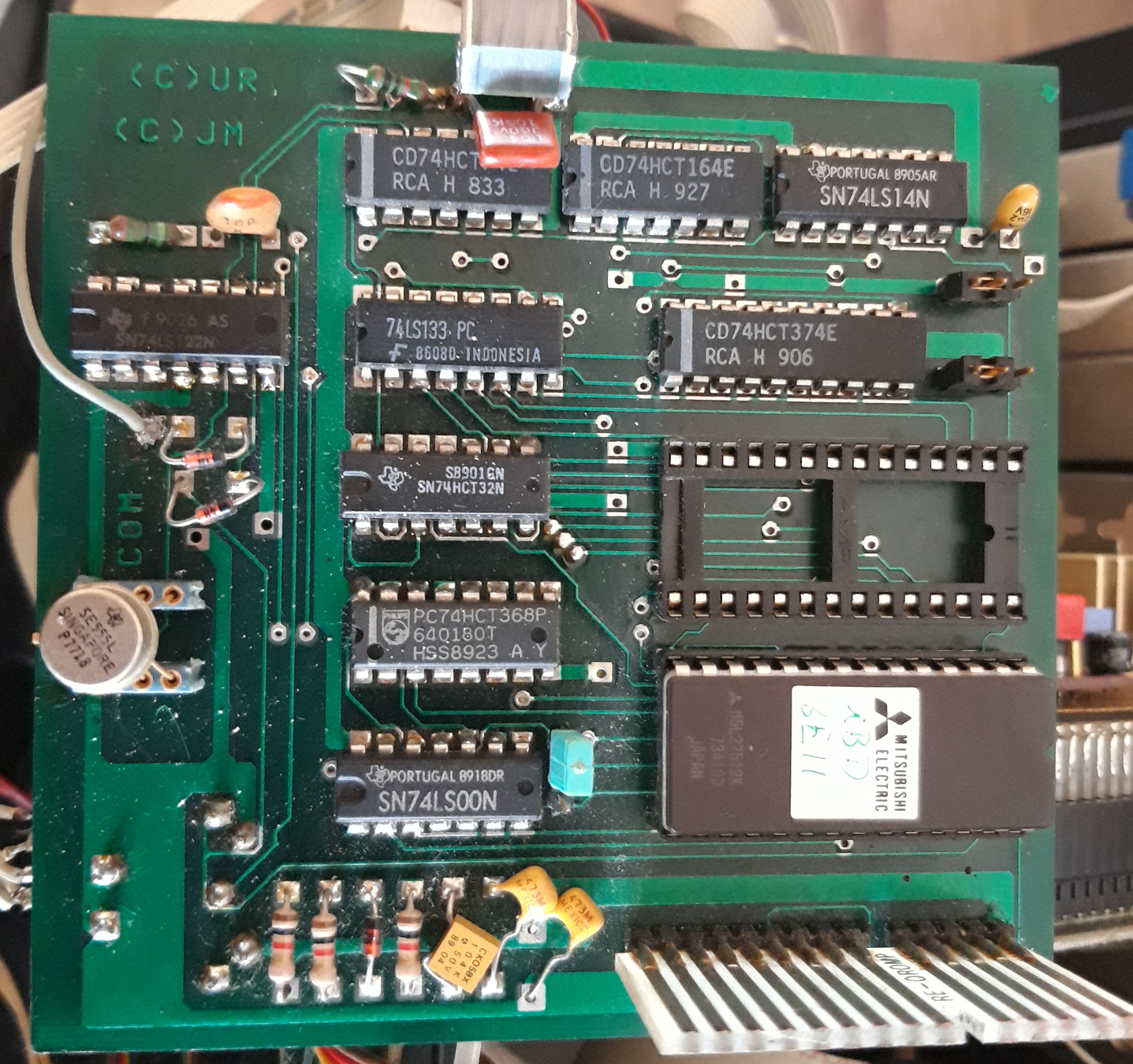

Basically, my custom QL beast that I acquired recently has this keyboard connector connected to the ROM port:
It has an AT (I assume it's AT and not XT because among the paperwork I got with the beast, there was a receipt for this k/b adapter and it's listed as AT) socket on it, on the other side on the board in the bottom left, and when I plug a keyboard into it (it's a ps/2 keyboard with an AT DIN5 adapter) and power up the system all 3 of the lights on the k/b illuminate briefly. The QL does its thing and I get the normal F1/F2 choice screen.
But then no response from either F1 or F2. I've tried 2 different keyboards and 3 different ps/2 to AT adapters.
The keyboard interface is German and called a 'Re-Tast V1.1'. The copyright initials are JM (Jochen Merz I suspect) and UR. The grey wire to the left, above where it says 'COM' is soldered to B3 on the expansion port (which is D1).
Anyone got any ideas about what I can try? There are 3x 3 pin jumpers on the board but I've left those how I found them, because obviously it was working in this state originally. I wonder if all my PS/2 to AT adapters are junk. It's annoying that I can't get past the F1/F2 to explore this very modded machine.

this is an ABC-Keyboard Interface. The UR initials stand for Ulrich Rosowski, I believe. Manual is here.
I used to have one years ago and I am almost sure it wants to see an XT type keyboard (and the above manual seems to confirm that).
Merry Christmas!

This is the so called ABC Electronic/Gigasoft Keyboard Interface. I no longer have ne at hand, so cannot really help.
There are some pictures of other such units available, maybe you see differences which can help you.
https://wiki.theqlforum.com/doku.php?id=qlwiki:keyboards
http://sinclairql.net/pic/ under Expansions
Fröhliche Weihnachten!

Some early AT keyboards had a switch to select XT mode. Of course that won’t help if all you have are PS/2 keyboards...
If you search the ‘net you will find that there are three keyboard protocols for the five pin DIN system. It should also be possible to use a microcontroller to carry out a conversion.
Mark
Mark

Here is an XT to AT & PS2 adapter if you want to build one.
http://www.vcfed.org/forum/showthread.p ... -converter
XT keyboards are just too old for me to ever have been involved with them. It might be worth taking a very close look at your interface board for cracked solder joints and squashed components that might be shorting out looking at your picture. The yellow capacitor wire is almost touching another pad and the ROM slot PCB sticking up looks like it might have cracked solder joints perhaps due to holding the weight of the main board. Also give the board a once over for dry solder joints since it looks hand soldered and not that consistent.
Happy Christmas!
Happy Christmas!
