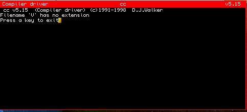

I am just trying out C68 for first time in a while and using QPC2 emulator with the latest Black Phoenix set up .
I cannot get started as when I put a basic 'Hello World' together with QD and then try both C68menu and the command line EX CC; (etc) i get the preprocessor error - filename 'V' has no extension - and the process fails. I'm certain this is a real newbie error but can anyone explain or perhaps point me to the listing of errors which can arise within C68?

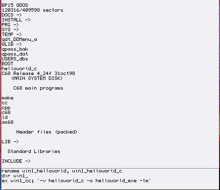

Hi Derek
I tried what you suggested and attach the input and output screenshots. I had both Data_use and Prog_use set to win1_, not that that was really necessary since all in the win1_ directory anyway.
Is it that I am trying this in an extended environment? Should I try with my Q68 in a minerva or base QL environment?
Yours
Kevin

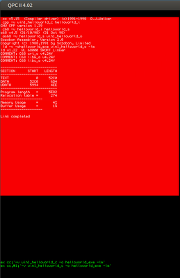

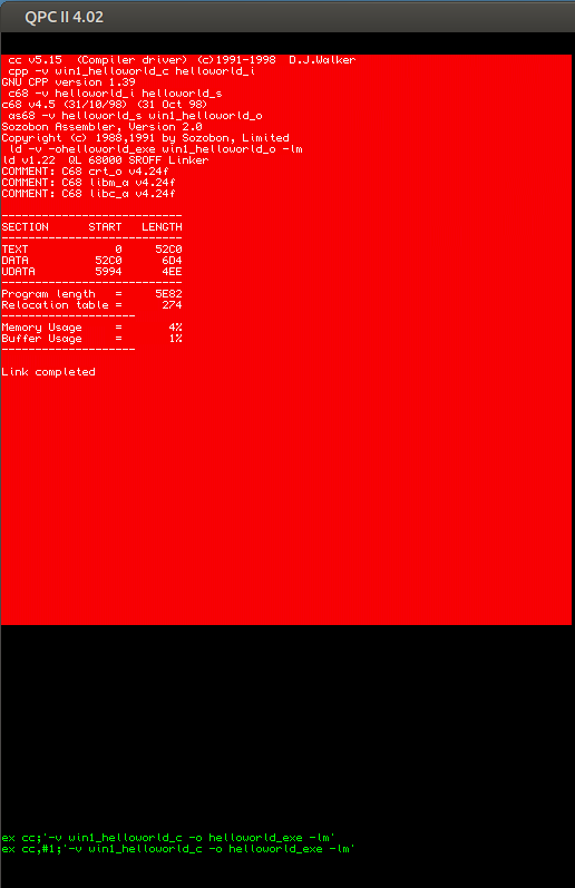

- Posts: 4796
Re: C68 newbie issue?
Hi Kevin,
I checked my C68 installation, which looks to be the same version as yours.
I tried the command:
DATA_USE win1_c68_
PROG_USE win1_c68_
EX cc;'-v win1_helloworld_c -o win1_helloworld_exe -lm'
See this screen shot: I think you have not specified the device on the source code file.
