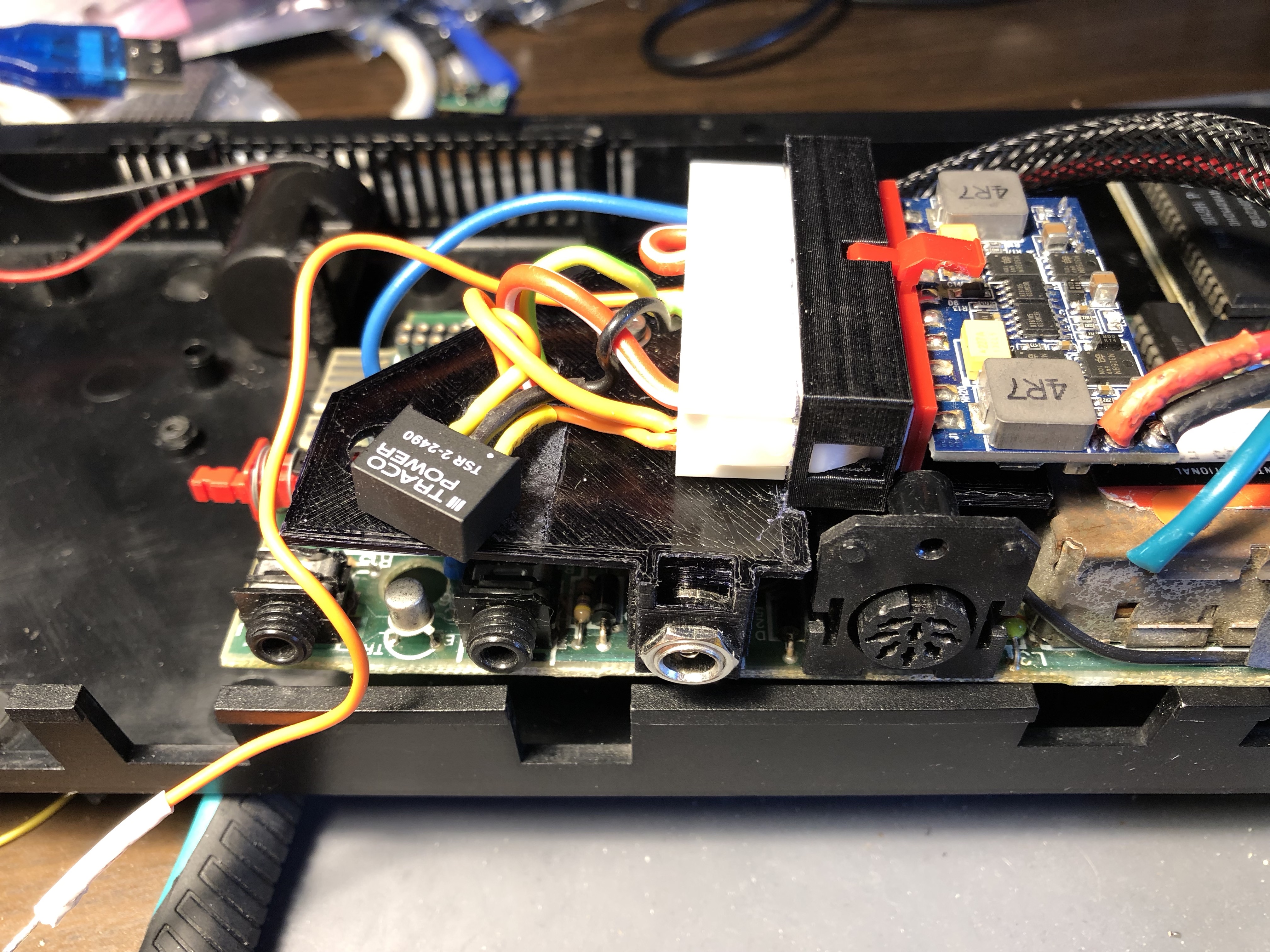

Thanks for all your input, guys. Yes I did have to add a TracoPower TSR 2-2490 to the mix. I found an injection point for 9V elsewhere on the board, since I made myself a nifty 3d printed stand for the QL fryer...
So yes, it is powered I can measure the 9V on the regulator leg of the MDV.
