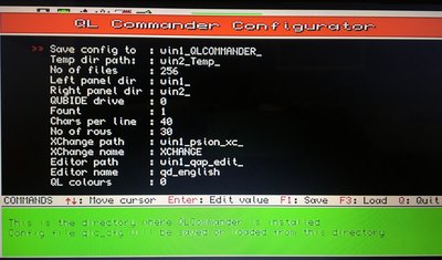

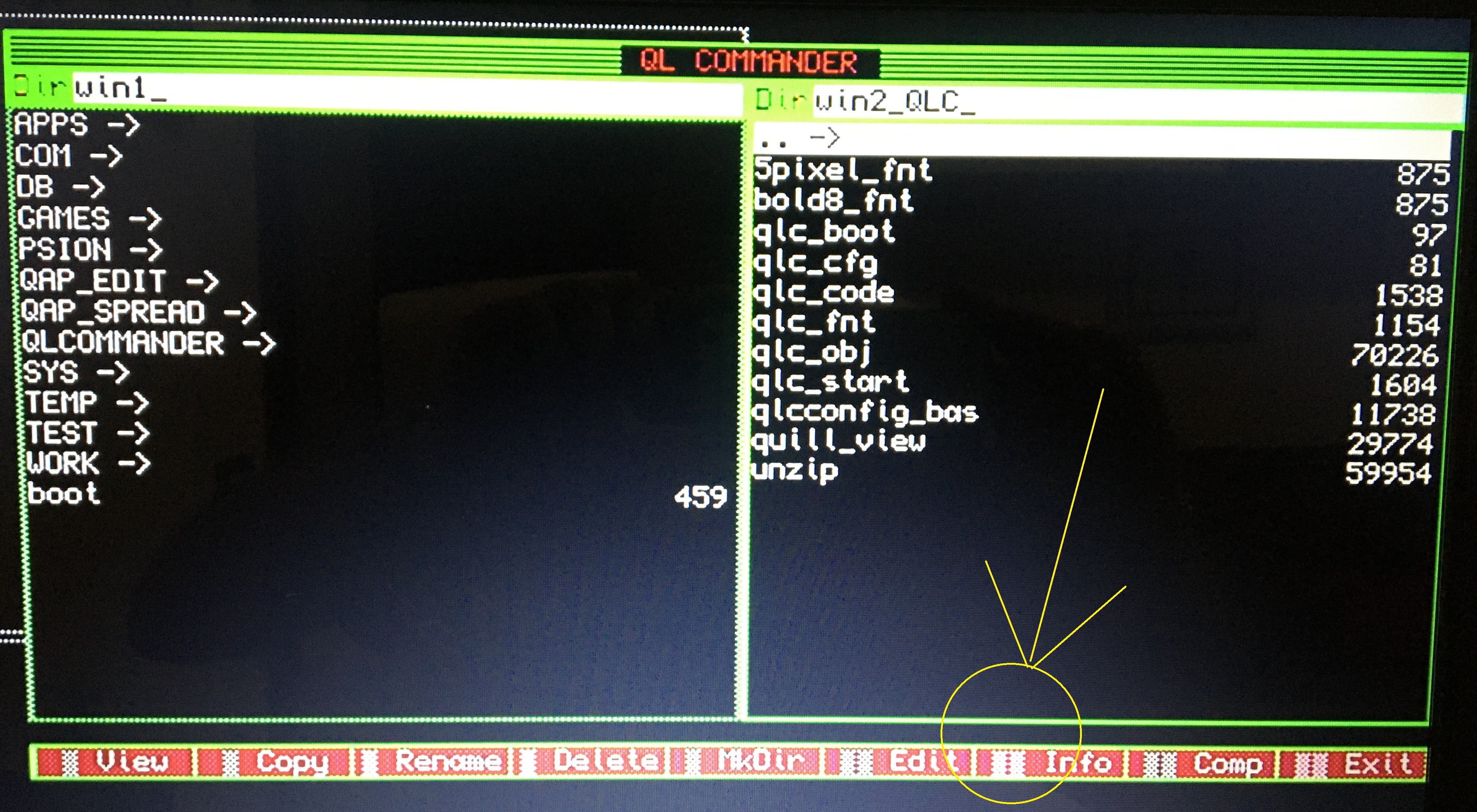

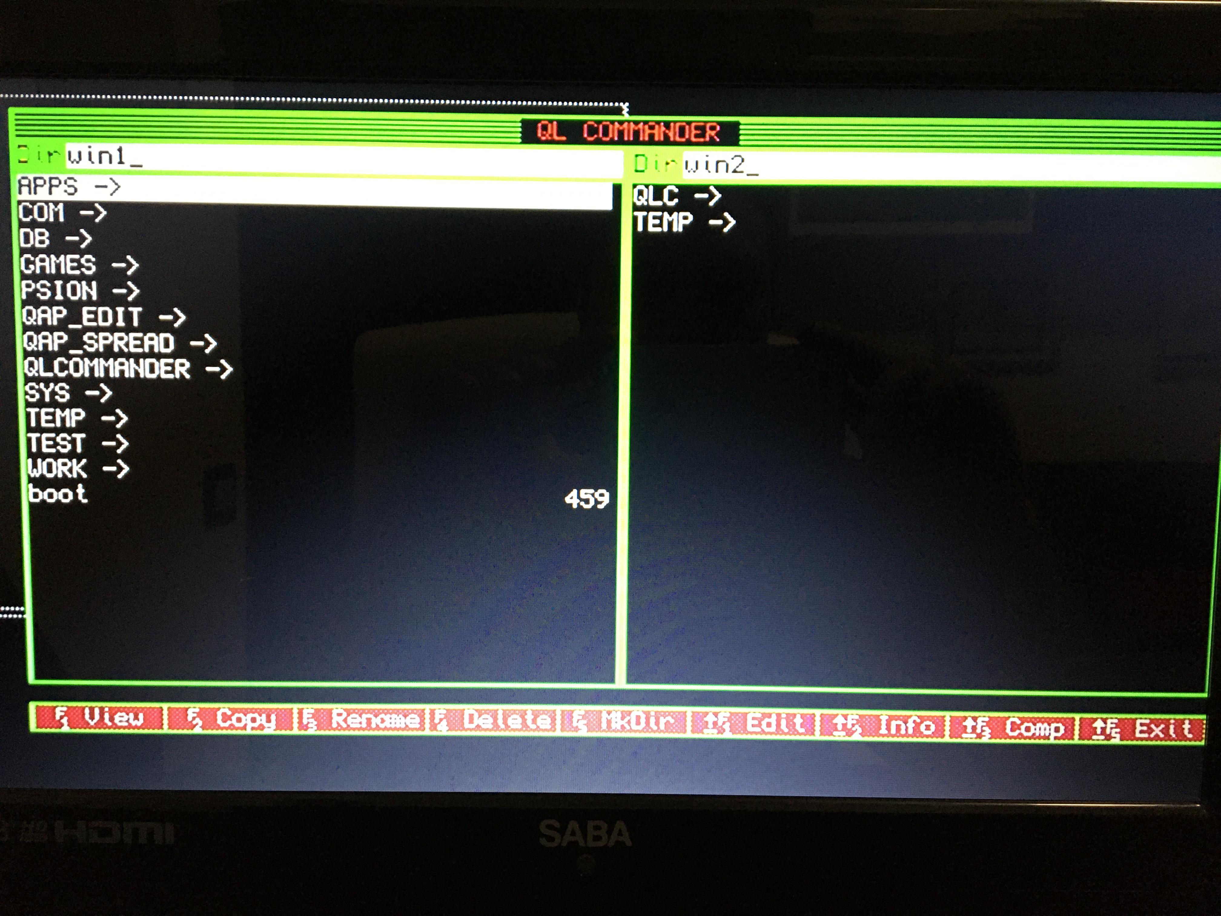

With QL Commander, I'm not able to see the symbols near the function keys on the bottom of the window (see pictures).

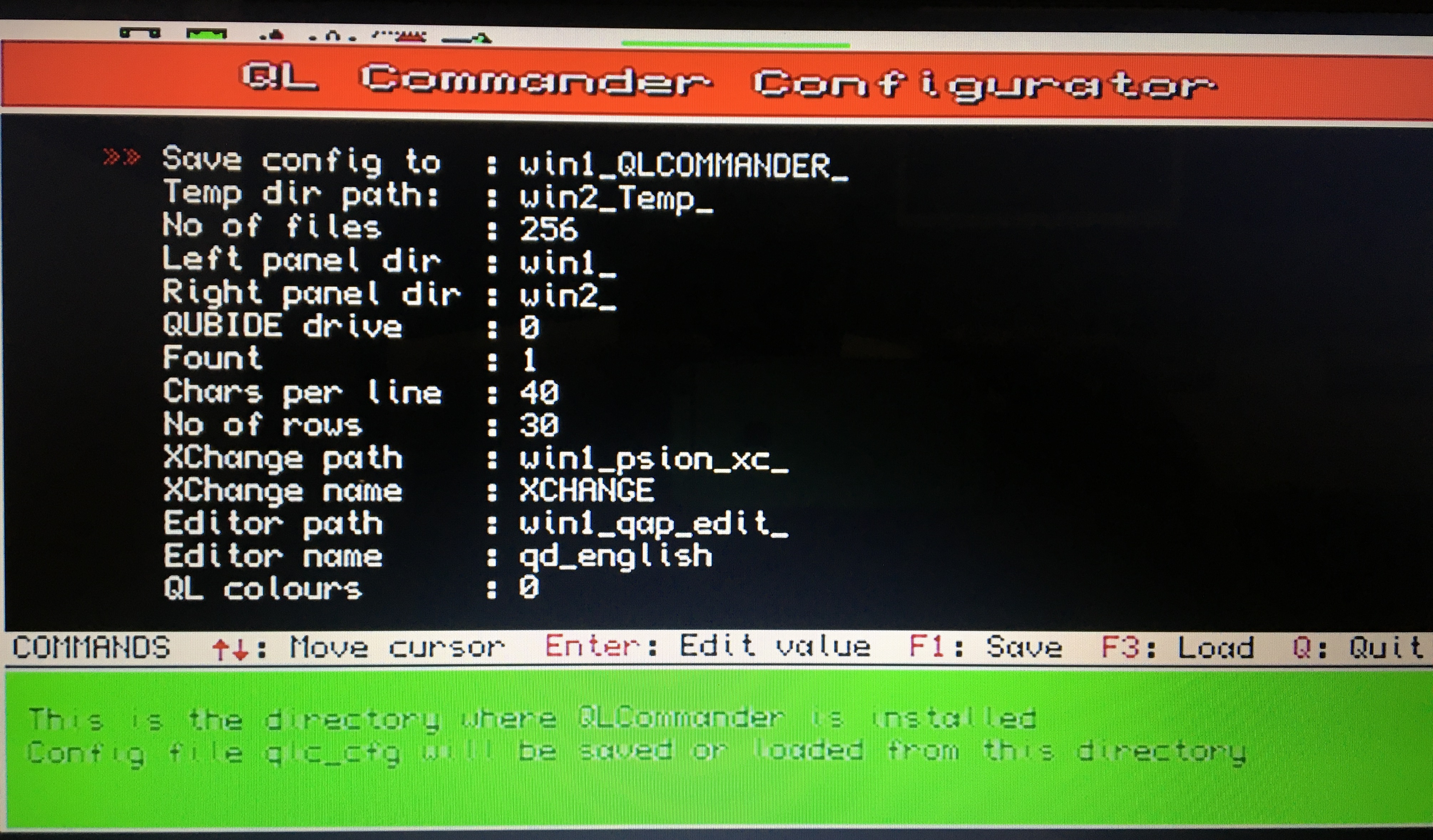

I attached the configuration parameters.
Any suggestions is really appreciated!

At start QLCommander checks the command line for the parameter that defines the home directory and device
In your case you should start QLC with : EX win2_QLC_qlc_obj;win2_qlc_
My guess is that Launchpad starts it without the command line parameter - and QLCommander looks for the default device and directory (that is win1_QLCommander_) and it cannot find in that directory the custom fonts used by the program - and that is why the title font is not the bold font and the commands line is missing the symbols.
Also you must save the config file in the same directory as the program files (see page 3 in the manual) !
So you have 2 options
1. Configure Launchpad to start QLC with the correct command line parameter
2. If launchpad cannot use parameters (I have never used it, so I do not know how it works) then move the program to Win1_QLCommander _
