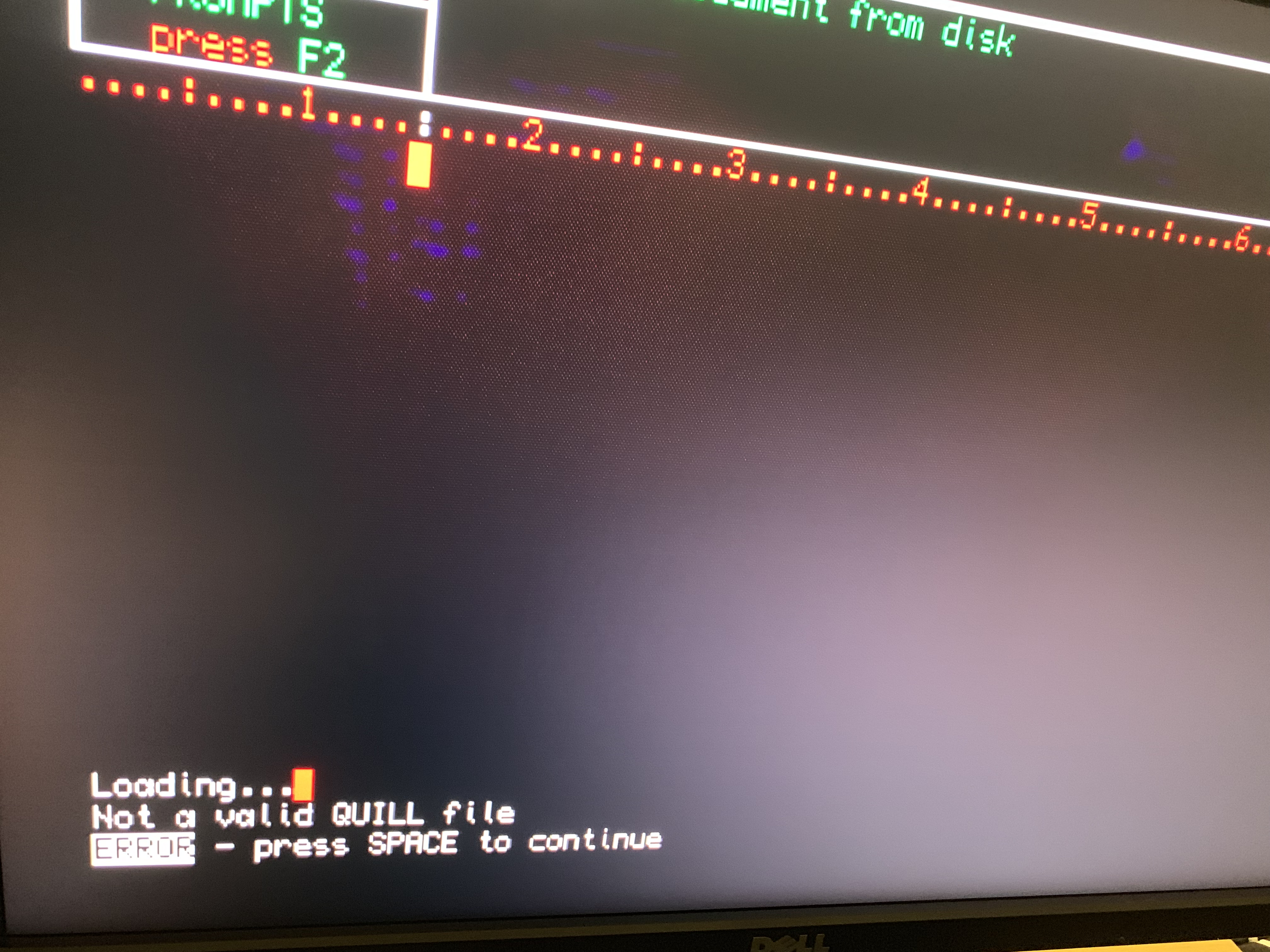

Attached here is my a manual for Sign Designer. Sign designer says the manual is a quill document but when I try to load in Quill I get NOT A QUILL DOCUMENT

Tobias,
I tried in the Xchange version of Quill and get the same error as you can see from my screen shot.
Can you please save it in Quill exchange and send it to me and I can see if it will load.

Just a thought - how are you getting the Quill document onto the QL?
Are you using the HABI file transfer program? I think (but could be wrong) you need to transfer the headers on a Quill document for Quill to accept them...

If you copy the first few bytes of the file to the screen, what do you get? Theres a header area at the start, 20 bytes, and will have chr$(0), chr$(20), vrm1q - or very similar. Might be worth writing a quick SuperBASIC program to dump out the first 20 bytes? In character and numeric form, maybe we will notice something.
Use Open_in to be sure it's read only.
