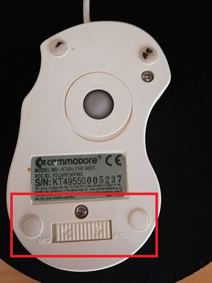

Hi genetika,
I have an old serial mouse and it works correctly with SerMouse (v. 1.02) and JS ROM (Minerva or Hermes is not necessary). But my old mouse has two modes, PC mode and MS mode (activated with a switch on the bottom). With MS mode it doesn't work, with PC mode it works fine. I think that all usual serial mouse for standar PC-Windows are "MS mode" and it not work with SerMouse.
My mouse is this:
stephen_usher
Posts: 595
Location: Oxford, UK.
Re: Rs232 serial mouse for QL
Post by stephen_usher »
The "MS" mode, is "Mouse Systems", which uses a different protocol and supports three rather than two buttons. The driver which came with it would allow the PC to run it in either mode.
Most PC mice used the original protocol but some added to it to allow scroll wheels etc.

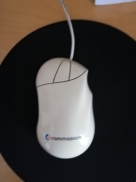

Posts: 4828
I have a few serial switchable mouses or is it mice...
Including the featured Commodore.
If anyone wants one for the cost of postage send me a PM.
