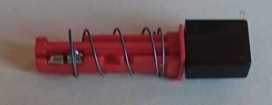

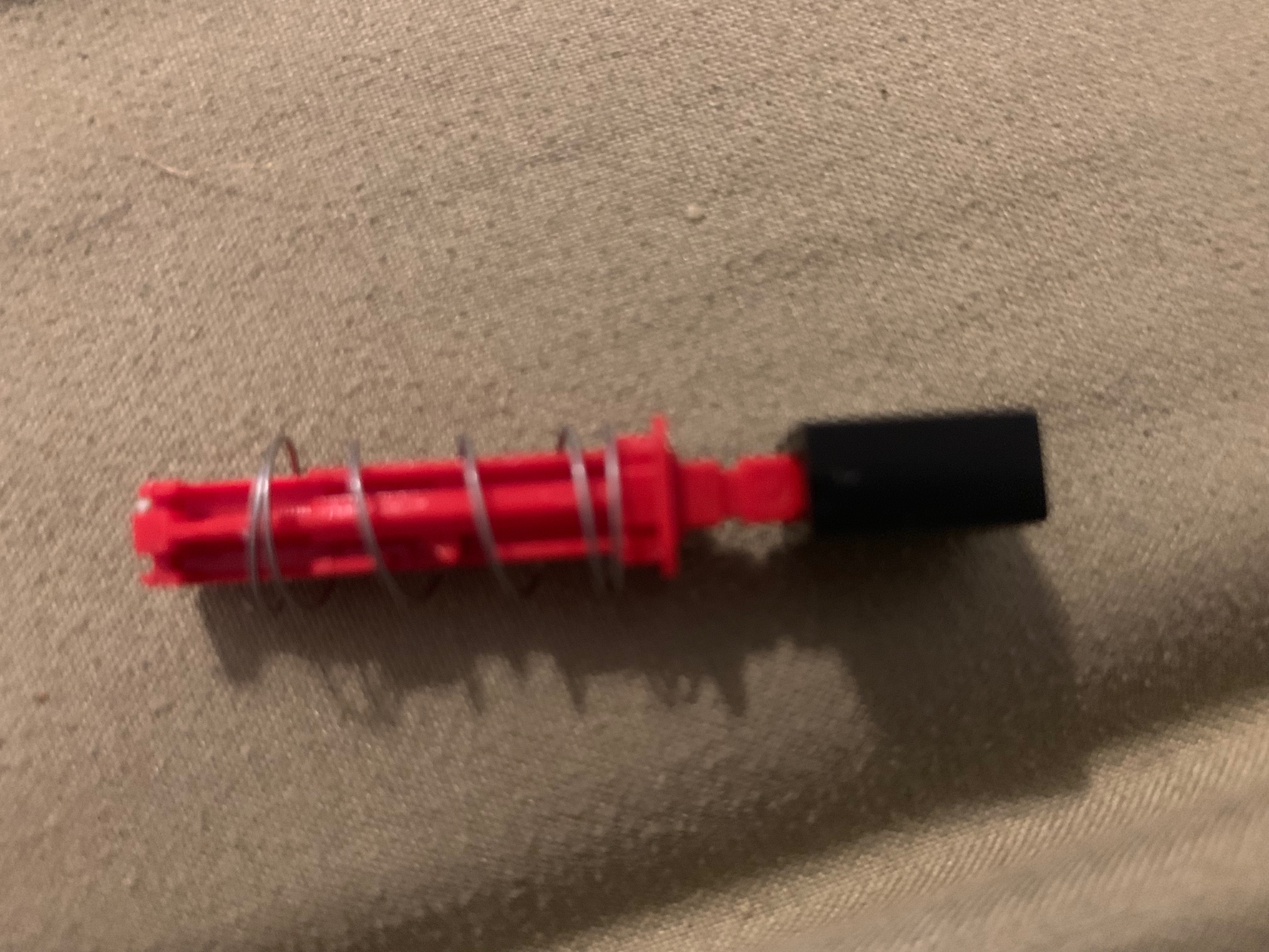

Ok Folks mystery solved,
Once I took apart the reset switch I knew immediately what the problem was.
Anyone want to venture a guess?
I put in a new switch and now its working. So now the only thing left is to wait for my new MDV1 and 2 to arrive and I will have a brand new QL

Re: Reset Switch
[quote="retro_collector"]Ok Folks mystery solved,
Anyone want to venture a guess?/quote]
The little piece of copper was missing...

Re: Reset Switch
Good news you have found the fault. This what I was saying in amother thread.
The copper insert that makes contact with the reset circuit, sometimes the contact is missing or damaged due to incorrect installation.
No amount of oil would fixed this fault.
