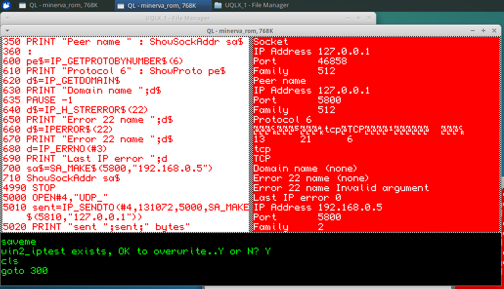

Now I have a Linux box that I can run UQLX in. I have finally got around to trying my IPBasic extensions in Linux.
I have found quite a few things that don't act as expected, and need to looked into.
But something I have noticed which I am not sure whether it is a bug in either QPC2, or UQLX.
Or something about Windows/Linux.

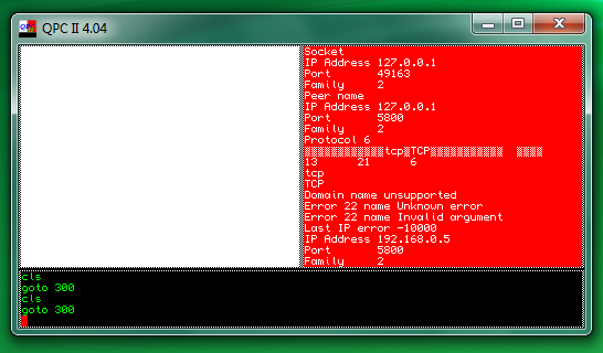

When I use either IP_GETSOCKNAME$ or IP_GETPEERNAME$. Which returns a SockAddr structure, The 'family' part (a word) value is different.
This is couple of screen dumps from QPC2 and UQLX both running my test program. Note the 'Family' values of 2 and 512. The expected value is 2, but in UQLX it's 512 which is the word value swapped around (big endian/little endian?)
So is this an emulator problem, or an issue with Windows/Linux?
I have also included the test programs. Start two copies of the emulator in one PC, LRESPR IPBasic_cde on each, and run the IPTests(erver) on one, and IPTestc(lient) on the other

32bit or 64bit uQlx, as we know 64bit still has many undiscovered variables issues due to terrible use of C types in the original source code.

Pretty sure it's 32 bit. It's an old (Celeron?) Dell PC running Xubuntu.XorA wrote:32bit or 64bit uQlx, as we know 64bit still has many undiscovered variables issues due to terrible use of C types in the original source code.
I may make a test, and set a flag in IPBasic to indicate that the family value need to be swapped around when this problem happens. Or is it safe to assume that if the first byte of the family value is not zero, then the family value needs to be swapped? So basically is the family value ever going to be greater than 255?

Please ignore me if I'm talking bollox, again, but, I did some network programming on Unix and Windows back in the mid 1990s and I seem to remember getting back to front values. Have you neglected to call htons, htonl (host to network short/long) or ntohs/ntohl (network to host short/long) to get the socket address detail in the correct format for the host - big or little endian?
These functions: https://linux.die.net/man/3/htons
It might be ok on Linux or Windows on x86 as they are little endian, but the QL is big endian, and it sounds exactly like the problem I had, back then.
Re: IP Device driver
Norman,NormanDunbar wrote:Please ignore me if I'm talking bollox, again, but, I did some network programming on Unix
Not bollocks. But 68k is big-endian and network byte order is big endian - ntohx() and htonx() are no-ops on proper CPUs like the 68k, and you only really need to swap stuff around on systems like the PC. Very probably, the missing byte swap is somewhere in the x86 code.

I'm working in the IP device driver in QDOS, which I don't think support hton and ntoh.NormanDunbar wrote:Please ignore me if I'm talking bollox, again, but, I did some network programming on Unix and Windows back in the mid 1990s and I seem to remember getting back to front values. Have you neglected to call htons, htonl (host to network short/long) or ntohs/ntohl (network to host short/long) to get the socket address detail in the correct format for the host - big or little endian?
And from QDOS it might be tricky trying to figure out what the architecture of the underlying system the emulator is running in.

Best thing is if we just fix the uQlx source! We don't want "special" versions just for one emulator when its the easiest one to get fixed! I won't have time probably in the coming couple of weeks but anyone is free to post patch to github!Martin_Head wrote:Pretty sure it's 32 bit. It's an old (Celeron?) Dell PC running Xubuntu.XorA wrote:32bit or 64bit uQlx, as we know 64bit still has many undiscovered variables issues due to terrible use of C types in the original source code.
