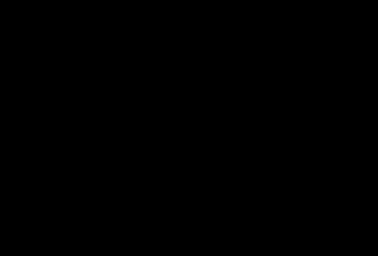

The software is now almost functional, it is starting to render correctly, and is starting to read from keyboard and i/o to the serial port, I recorded a demonstration of what's happening:
The incoming buffer isn't draining properly, for some reason... What's the correct pattern for dealing with I/O ?
I am doing the following in main.c:
io_main:
keyboard_main()
touch_main is currently empty.
What could be going on?
-Thom

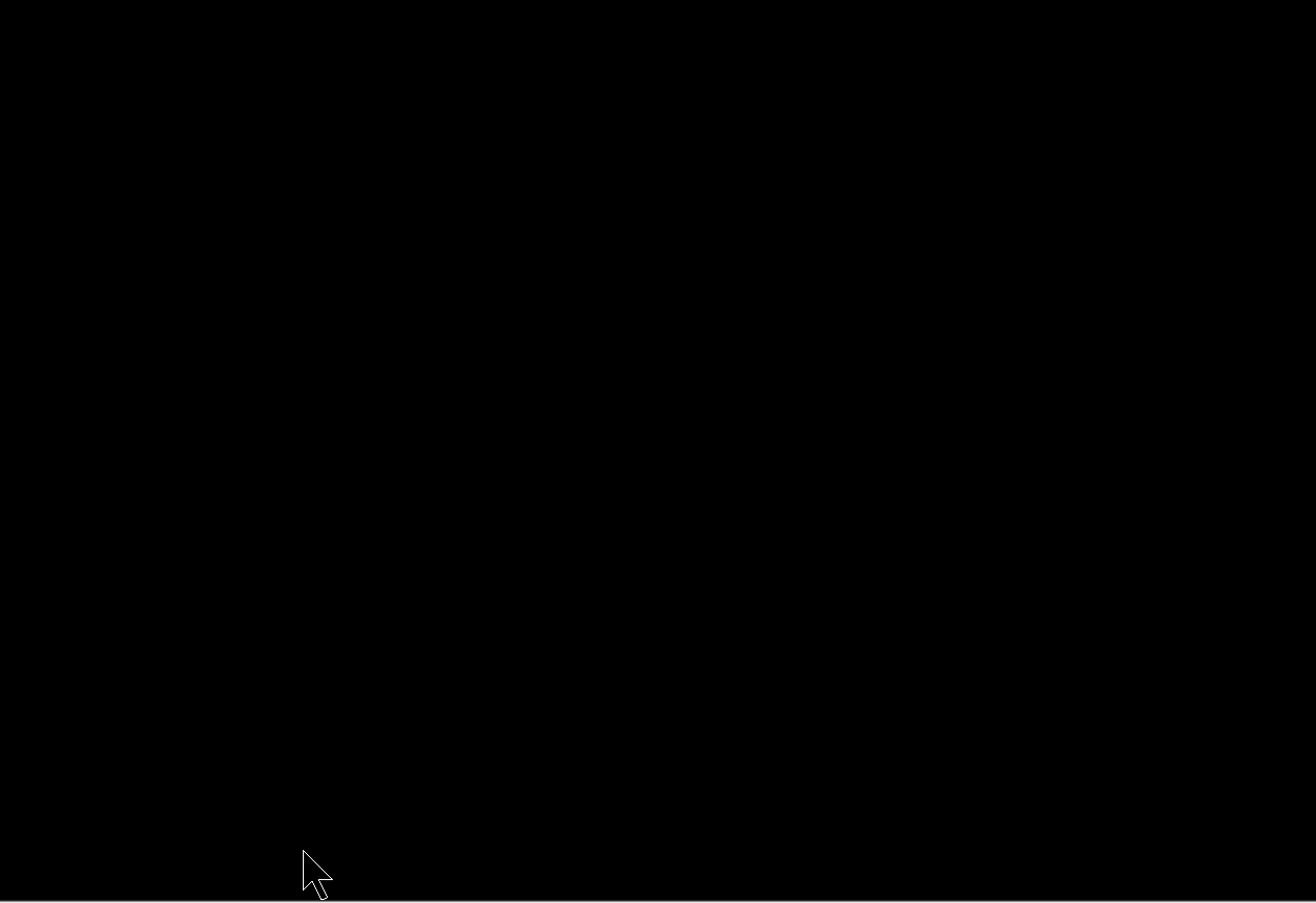

And by removing the io_pend() calls for keyboard and serial i/o, and depending on a zero time-out to simply return a NC, I am able to get the buffer to behave as expected, and am now able to successfully connect into IRATA.ONLINE, without any hiccups, at 9600 baud in Norma QL speed (using RTS/CTS), as to how this fares to a real QL, we'll have to see, would love to buy or borrow a unit for dev testing.
The new bits of code:
Now onto getting the text output fixed, making sure it doesn't wrap or break lines, then implementing the rest of the missing draw modes, implementing the new fonts, implementing font downloading, and finally implementing preferences.
