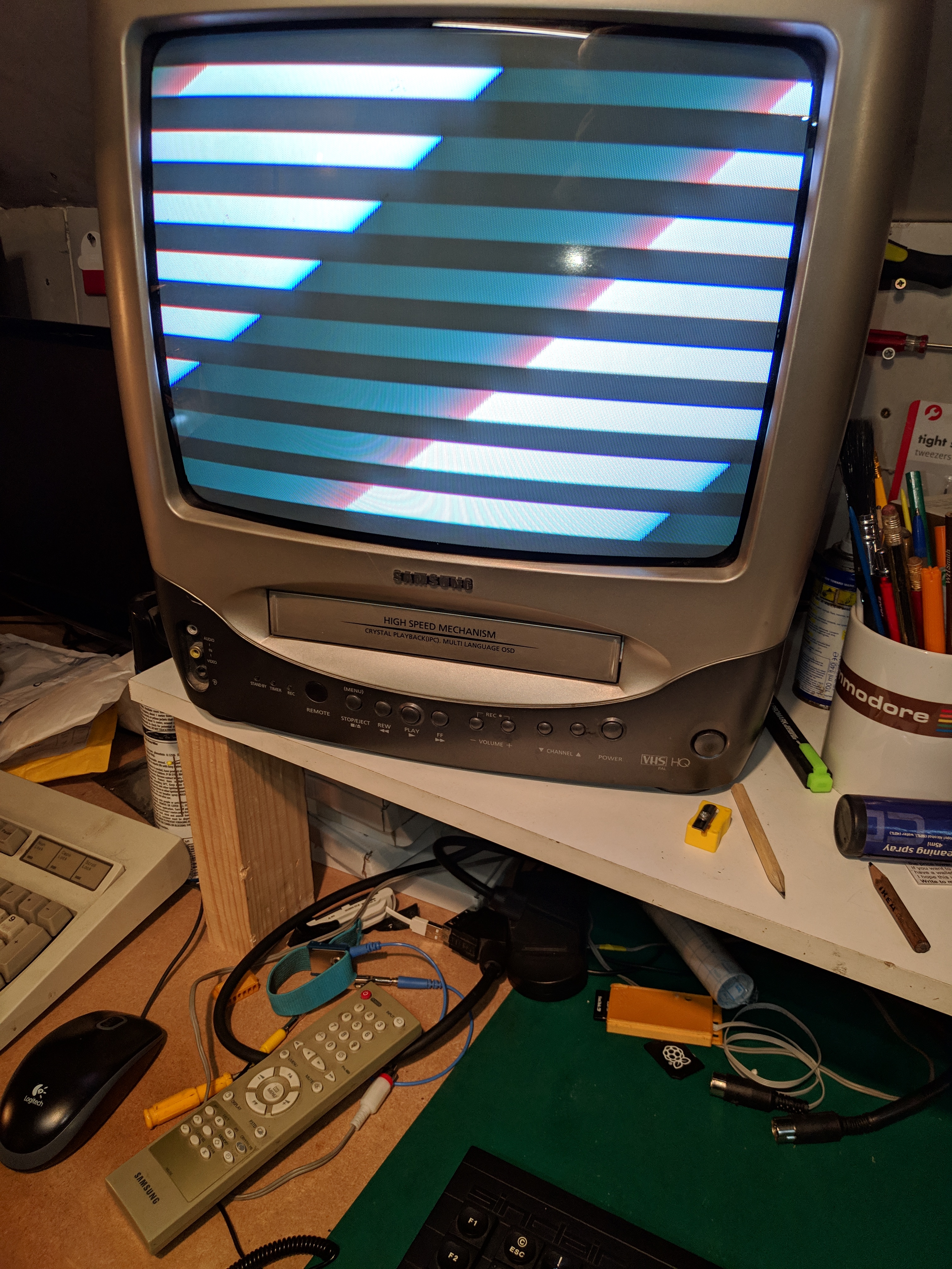

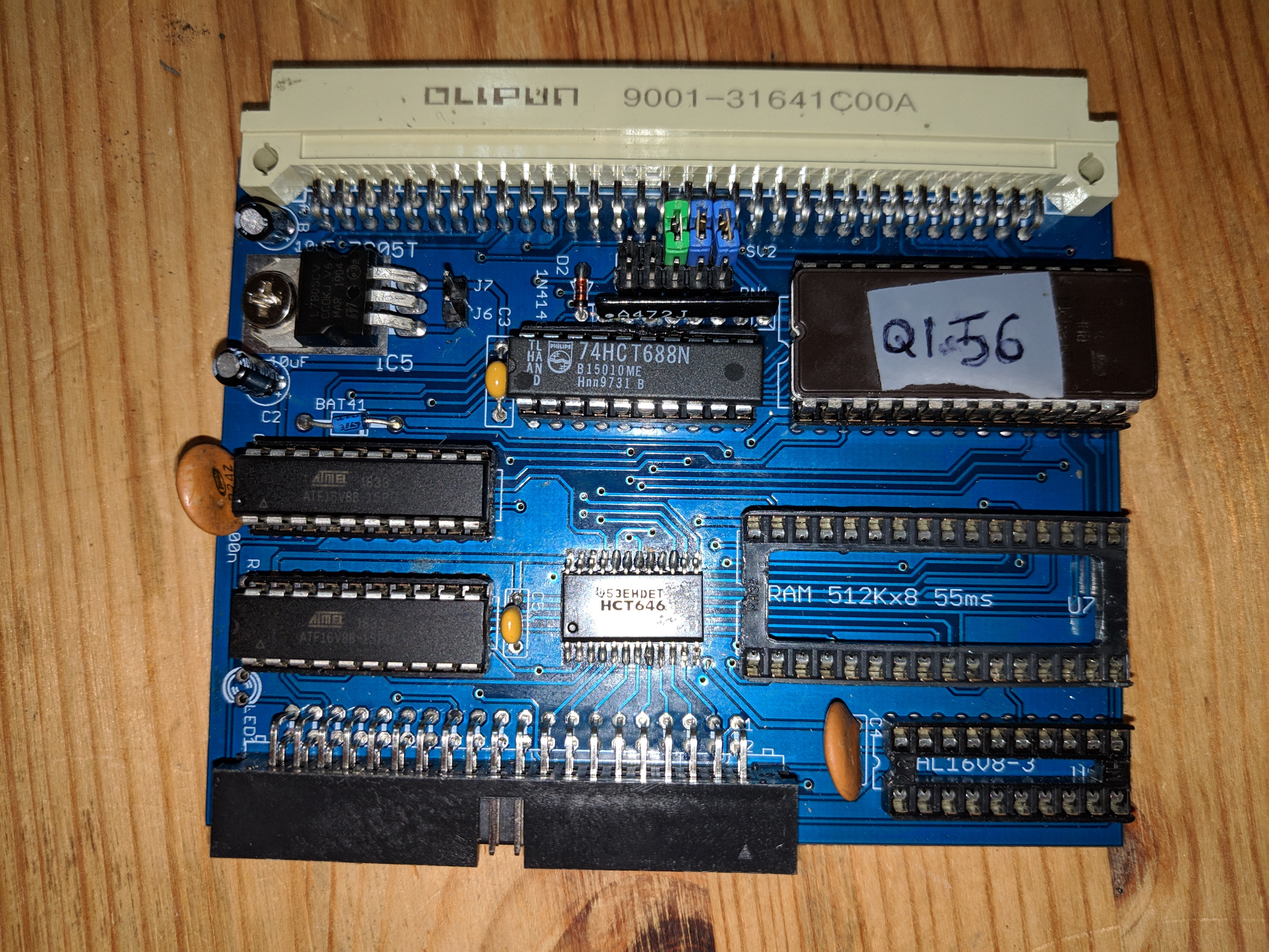

Finally got my DIY QubIDE built however all I get is horizontal black and white bars on boot. QL is stock with no other cards. I've prog'd the Eprom with version 1.56A and removed the ram and 3rd gal to simplify. Also realised that you have to program the gal chips but not sure if I have the correct versions, sourced them from here http://www.retrocomputing.net/parts/sin ... s/docs.htm.
Anyone got any ideas?

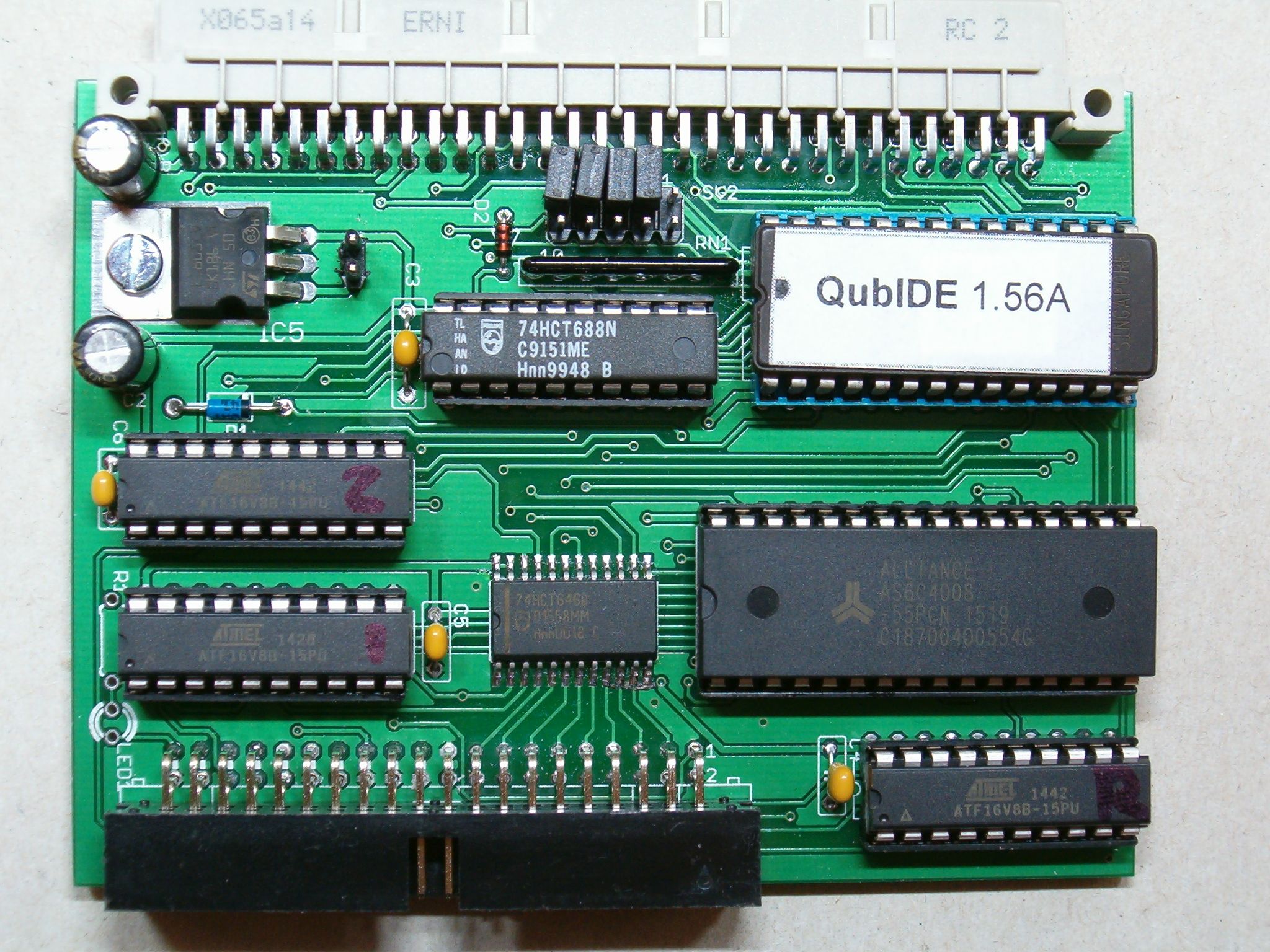

My qubide exactly matches this

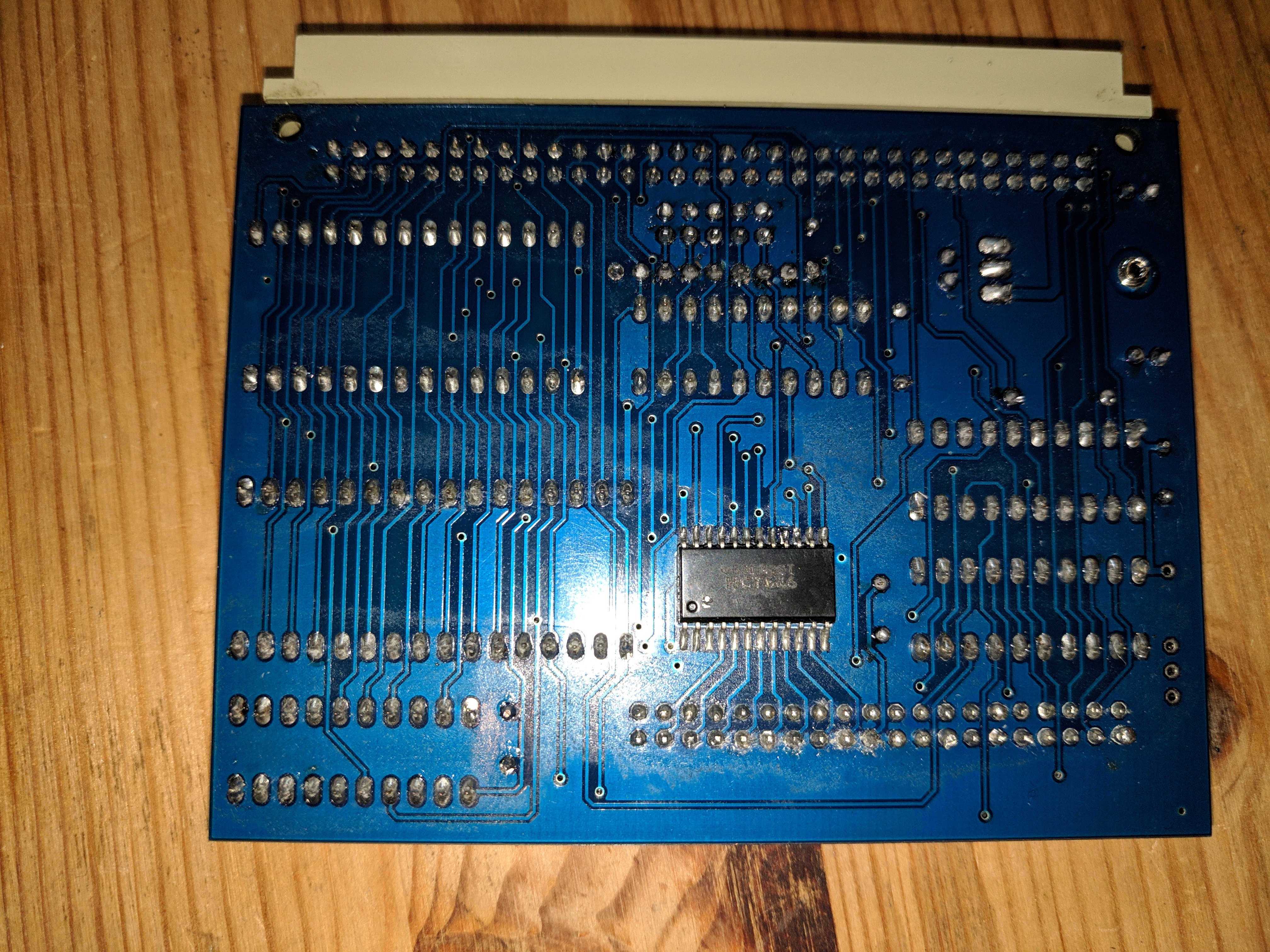

I have built alot of these interfaces, can you upload photo of both sides of the PCB.

Hi Tom
Whilst there may be other problems (the programming of the GALs for one), it seems to me from your photo that the resistor array may be fitted back-to-front.
Pin 1 of the array is typically the 'common' pin and marked with the white 'dot', should be connected to Vcc and marked on the PCB adjacent to the ROM. If I read your photo properly, the white dot is on the left rather than the right (looking from the top-side.)
I may be completely wrong, of course - just a thought and easy enough to switch-around.
Good luck - I'll be assembling my own soon...
M.
M.

I think Martyn is correct, the resistor array is the wrong way around. Pin 1 on the resistor array is next to the Qubide eprom.
If you look closely on the PCB mask, Pin 1 is marked.

Thanks so far guys but after replacing and orienting the resistor array correctly still getting black and white lines?
