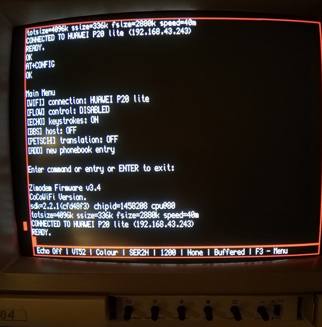

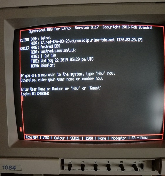

Hi guys.
Yesterday I received "Simulant - Retro Wifi SI (R2)". The package arrived perfectly
I have connected it correctly to my QL and I have configured the wifi connection. I am using QLTerm and the QL communicates perfectly with Simulant - Retro Wifi. But when I connect to a BBS (for example "amstrad.simulant.uk:464") I have a problem that I can't solve. The "welcome greeting" from the host is transmitted correctly, but when I type the login I get a "NO CARRIER" message and the connection with the host ends. This happens when the host is waiting for the login and I press a key on my QL. The same happens with other BBS.
Any ideas?
That is a screenshot.

You have set the Interface to MODAPTER. This only makes sense if you have connected your modem through a Modapter (a device produced by Miracle Systems back in the '80s to connect dumb 1200/75 baud modems to the QL's serial port so they could use the split baud rate). The serial output is modified in such a way that the electronics in the Modapter produce a 75 baud output signal.afx wrote: I have connected it correctly to my QL and I have configured the wifi connection. I am using QLTerm and the QL communicates perfectly with Simulant - Retro Wifi. But when I connect to a BBS (for example "amstrad.simulant.uk:464") I have a problem that I can't solve. The "welcome greeting" from the host is transmitted correctly, but when I type the login I get a "NO CARRIER" message and the connection with the host ends. This happens when the host is waiting for the login and I press a key on my QL. The same happens with other BBS.
If you have a modern intelligent modem or just a serial link, set Interface to Buffered. This uses an 8-bit transparent connection to the serial port.

Hi bixio60, Jan. Thanks for the answers.
I have tried several configurations, QModem. Modaptor, Buffered; and I have also defined> "ECHO Off > Buffered > SER2H > Baud (1200) > None" in Interface menu but the result is always the same.
With the ATI and AT+CONFIG command I get the wifi router IP address.
(What should I define in Flow Control, -in simulant retro-wifi config- ?
