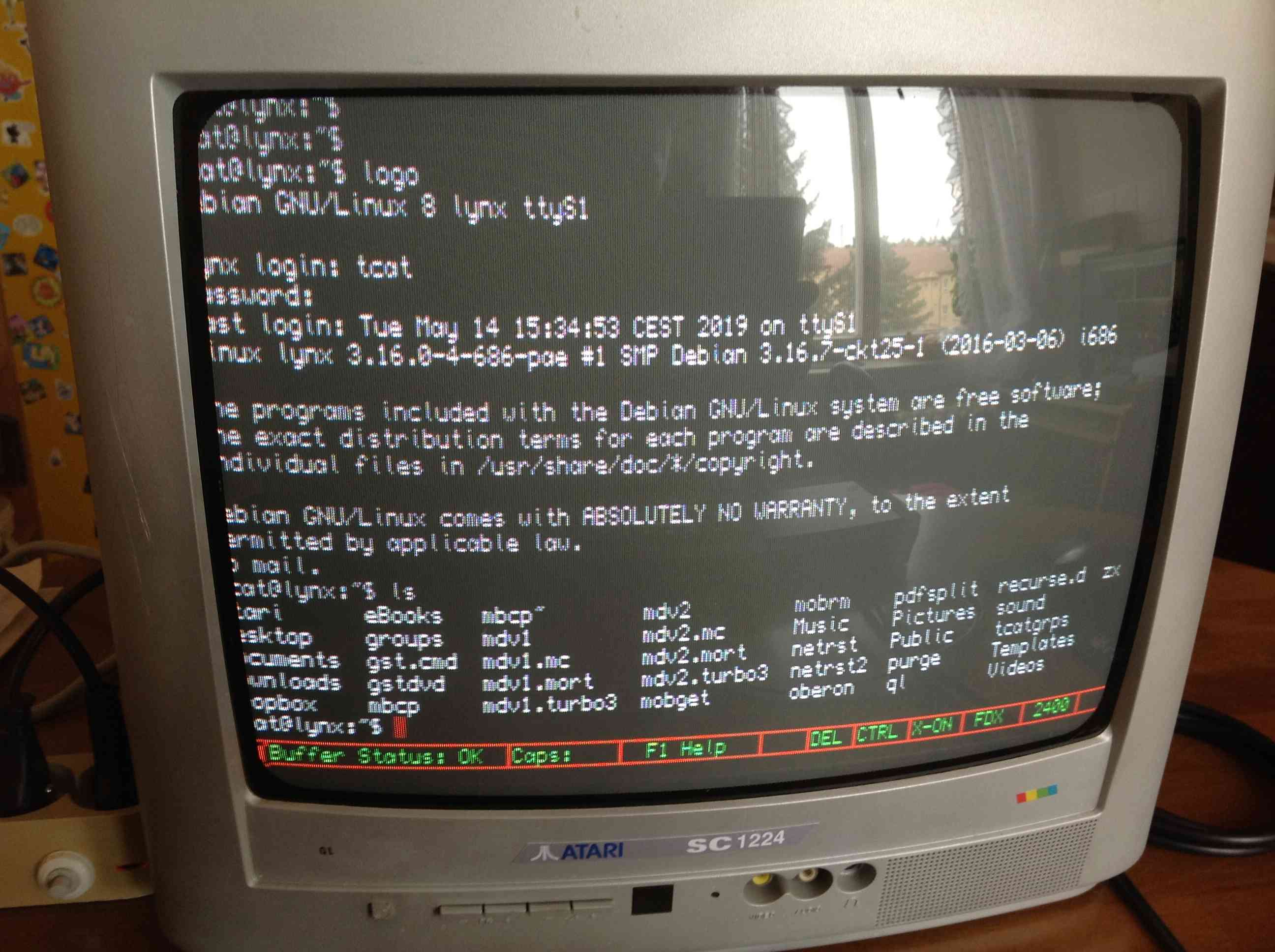

It works, I realised that serial `ttyS1' has to be respawned using `getty' (get tty on serial line).
These settings works here with `terminal-3-53' defaults.
2400 SER2IR XON/OFF
I wish to post `term_scr' as well.
EDIT cannot save to ser2, a quick photo attached. Tom
2400 SER2IR XON/OFF
$ stty -F /dev/ttyS1 2400 cs8 cstopb cooked -crtscts echo
$ /sbin/getty -L ttyS1 vt52 # needs root priviledges
