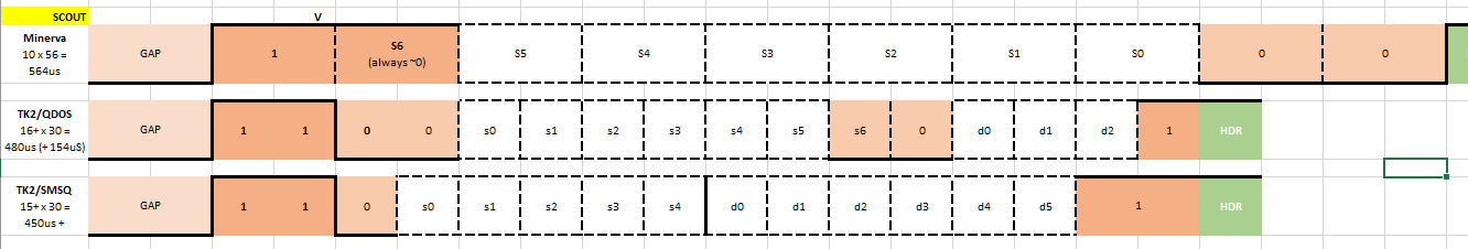

So, the different OS platforms that can 'talk' QL/ZXNET broadly encompass:
All the Hardware-based QL compatibles (bar probably the ST QVME card) have a electrically compatible Network port, including the QXL, Aurora (if I'm not mistaken) and Q68, but it's the variant of the NET driver as one of the four options above that generate the differences in implementation of the protocol - most obviously in the SCOUT phase, which is what we'll discuss here:
The following might be slightly off, but corresponds with my reading of the respective source code and then tested using a logic-analyser empirically. Always happy to be corrected
Once the listener has detected the start of the SCOUT (or, in the case of TK2 and SMSQ, atleast 50 us continuous active) following a period of inactive at least 200 us, the remainder of the SCOUT is skipped using a crude timing loop - the listener will then await active before then looking for the all important START bit, around which the actual data-bit timings are based - and reset upon the next START bit.
Coming back to Jason's question - 'How to detect whether TK2 is sending?'...
There are probably a few valid methods to proceed, but from what I can deduce, the most reliable and simple would be to time the initial active period of the SCOUT before it first goes inactive - anything OVER about 70 us is almost guaranteed to be NOT TK2/SMSQ, both of which always follow the initial active period of c60 us by 1 or 2 inactive bit-times - regardless of SRC/DST encoded values that then follow.
I say 'almost' because there is one possible edge-case of Minerva/QDOS generating a shorter initial active period in the SCOUT - that is when the SRC is configured as station number '64'.
I've seen various comments in the different source code and documentation indicating the valid range of Network Station numbers is 0-63 or 0-64 or even not checked at all. (We can ignore TK2's 'server' pseudo station numbers of 80h+SRC - bit 6 will still only be set if SRC is 64.)
Due to the listener's ignorance to the actual contents of the SCOUT, with a bit of care we could encode something else there and still maintain backwards compatibility... More in a future post, if anyone's still interested...
- Vanilla QDOS (incl. Minerva for this discussion)
QDOS + TK2 (just 'TK2', henceforth) and
SMSQ/TK2 ('SMSQ')
Spectrum+Interface-1 ('ZX')
- Minerva and QDOS both take the approach of encoding only the SRC station number in the SCOUT - inverting the bottom 7-bits of SRC within a 10-bit frame of around 56 us per-bit.
TK2 on the otherhand takes both the SRC (7-bits) and DST (3-bits) station numbers, using positive logic within a 16-bit frame, each of around 30 us each.
SMSQ seems to vary slightly from TK2 by taking 5-bits of SRC and 6-bits of DST but within a 15-bit frame - again around 30 us each.
ZX more closely matches QDOS, using a 9-bit frame of inverted SRC, but at around 54 us bit-time.
