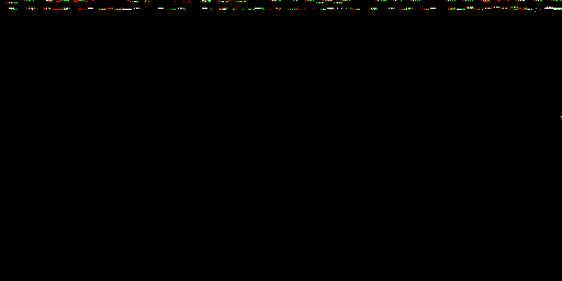

I have visualised 2nd vram (SCREEN-1) on JSROM, that maps over system variables. JSROM machines seem closest to Minerva.
10 REMark HEX(20000)=131072 .. SCREEN0, HEX(28000)=163840 .. SCREEN1
20 FOR s=0 TO 32764 STEP 4: POKE_L s+131072, PEEK_L(s+163840)
30 PAUSE
SCREEN1 @ SYSVARS
SCREEN1 @ SYSVARS
Bottom half seems almost writable by a program, I wish to decompose the rest. At the top I can most likely see system variables, there comes somewhere superbasic area, QDOS stack. I wonder what is that piano keyaboard pattern, that looks very regular?
Can anyone help please, I wish to make --SAFE-- use of the second VRAM (SCREEN1), if possible. Also some of QDOS routines take SCREEN{0,1} as their parameter.
Many thanks.

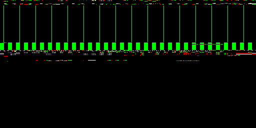

tcat wrote: Bottom half seems almost writable by a program, I wish to decompose the rest. At the top I can most likely see system variables, there comes somewhere superbasic area, QDOS stack. I wonder what is that piano keyaboard pattern, that looks very regular?
The thin lines are the slave block table (8-byte entries, most contain only one byte $01), the blocked pattern is the job table and channel table (4-byte entries, $FF000000 means unused). These tables follow the system variables and supervisor stack (from $28480 onwards). The slave block table's size depends on the amount of RAM, there are two slave blocks for every K RAM above $28000.
Below the tables are the common heap which extends downwards (upwards in terms of memory addresses).
Further down (out of screen memory) you would see SuperBasic, TRNSP and RESPR areas which expand downwards in memory. You won't normally see them on second screen memory unless you're almost out of memory...
Jan.

In other words, looking for a way, both screens{0,1} look like this, with all the tables moved to their new home, with sysvars updated appropriately.
If possible, then we could use QDOS as usuall, as long as we do not write to top 5 lines, where sysvars would now live?
SCREEN0 - SCREEN1 - w/ SYSVARS
Tomas

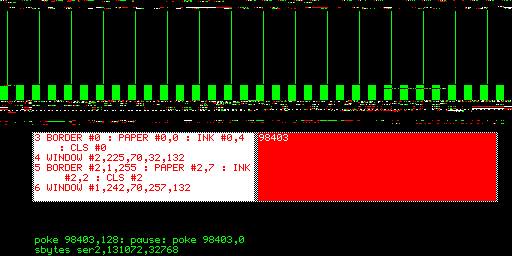

Doing some tests, in SuperBASIC so far.
[1] Resized WINDOWs #1,2 to fit bottom half of the screen.
[2] Copied sysvars, and system tables to screen0, as shown earlier.
Now I can switch to screen1, and back to screen0.
10 REMark HEX(18023) = 98403, master chip (ZX8301) display control
15 REMark bit-7 (1)-screen1, (0)-screen0
20 POKE 98403,128: PAUSE: POKE 98403,0
JS-ROM Basic routines are tied to screen0 only, so when switching to screen1 WINDOWS #1,2 disappear altogether, but after pressing a key, appear again.
SCREEN0-SCREEN1
SCREEN0-SCREEN1
I am surprised to see some visual activity at the top 5-10 lines after switch to screen1, while when at screen0 these lines hold still???
Not necessary.
VideoRAM is not bank switched.
Pointer to start of video memory swaps between two various addresses.
Correct.
Sysvars are in the fixed address (beginning od screen 1), and never in screen 0 area.
