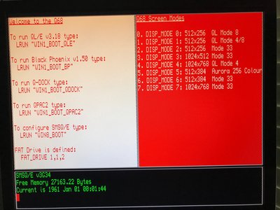

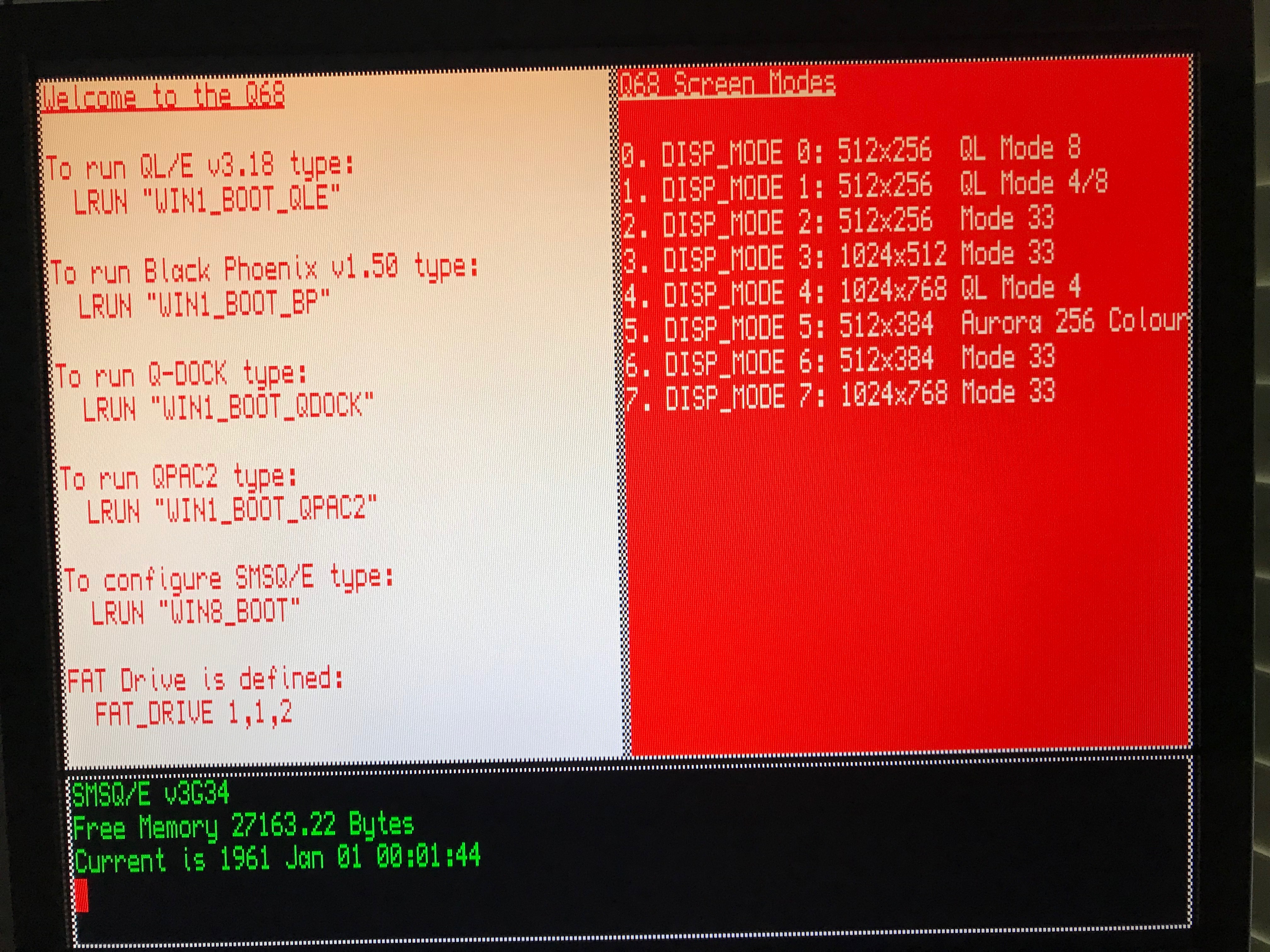

Here's a screenshot from my freshly booted Q68 connected to the Benq BL912:
Q68 to Benq BL912
Q68 to Benq BL912
this looks good to me, and the other disp_modes also display well on this monitor.

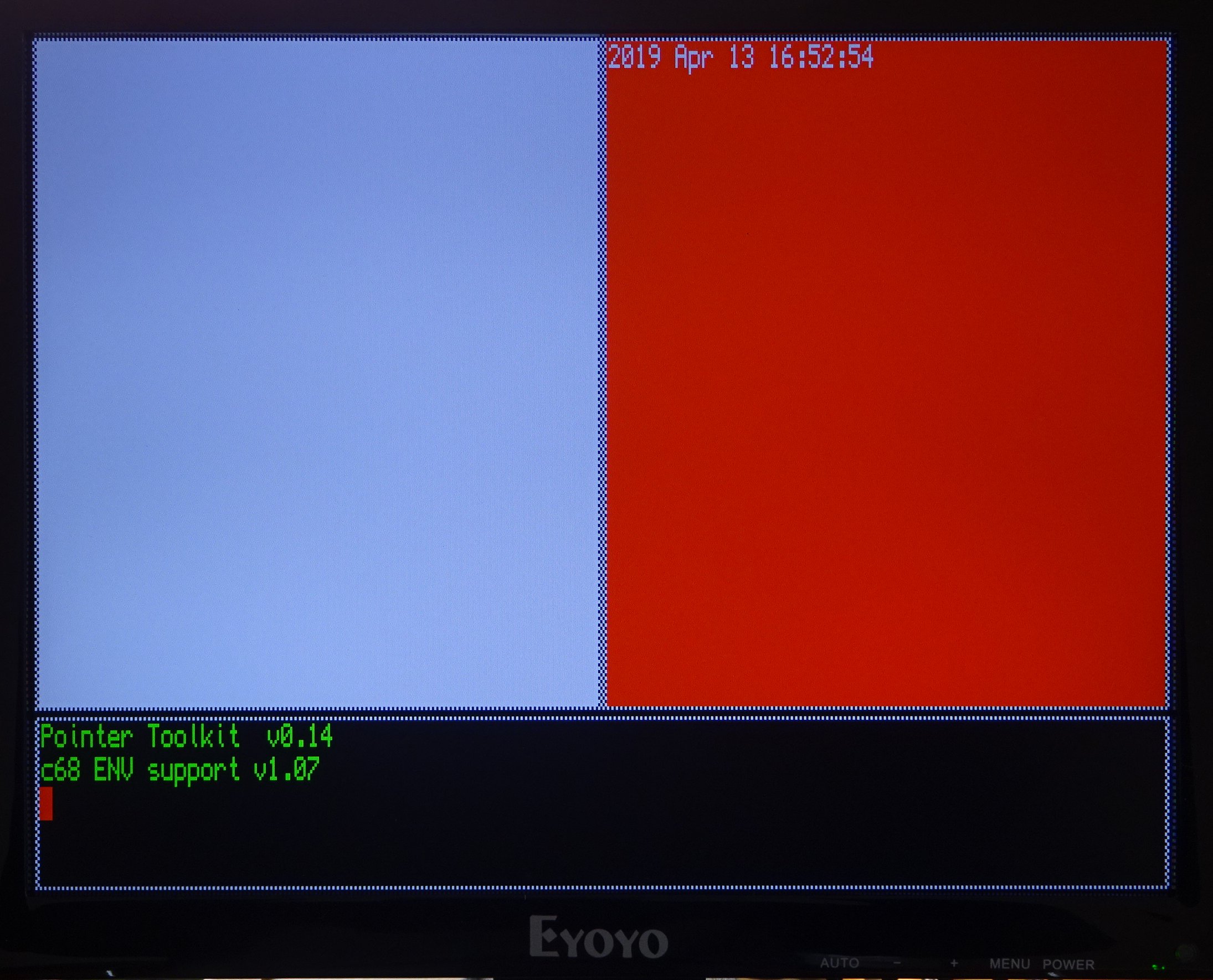

For comparison, here's the Q68 on the EM15A, set to contrast 50 and brightness 40:
Q68 on EM15A
Q68 on EM15A
not bad, but the backlight shine-through (seen in window #0) does spoil things for me.

Nice pictures of the Q68, but the clock is not set to the correct date.
You need to set the date with the SDATE command and then execute the Q68 Set RTC programme:
EX "win1_q68_q68setrtc"
This will set the Q68 Runtime Clock.

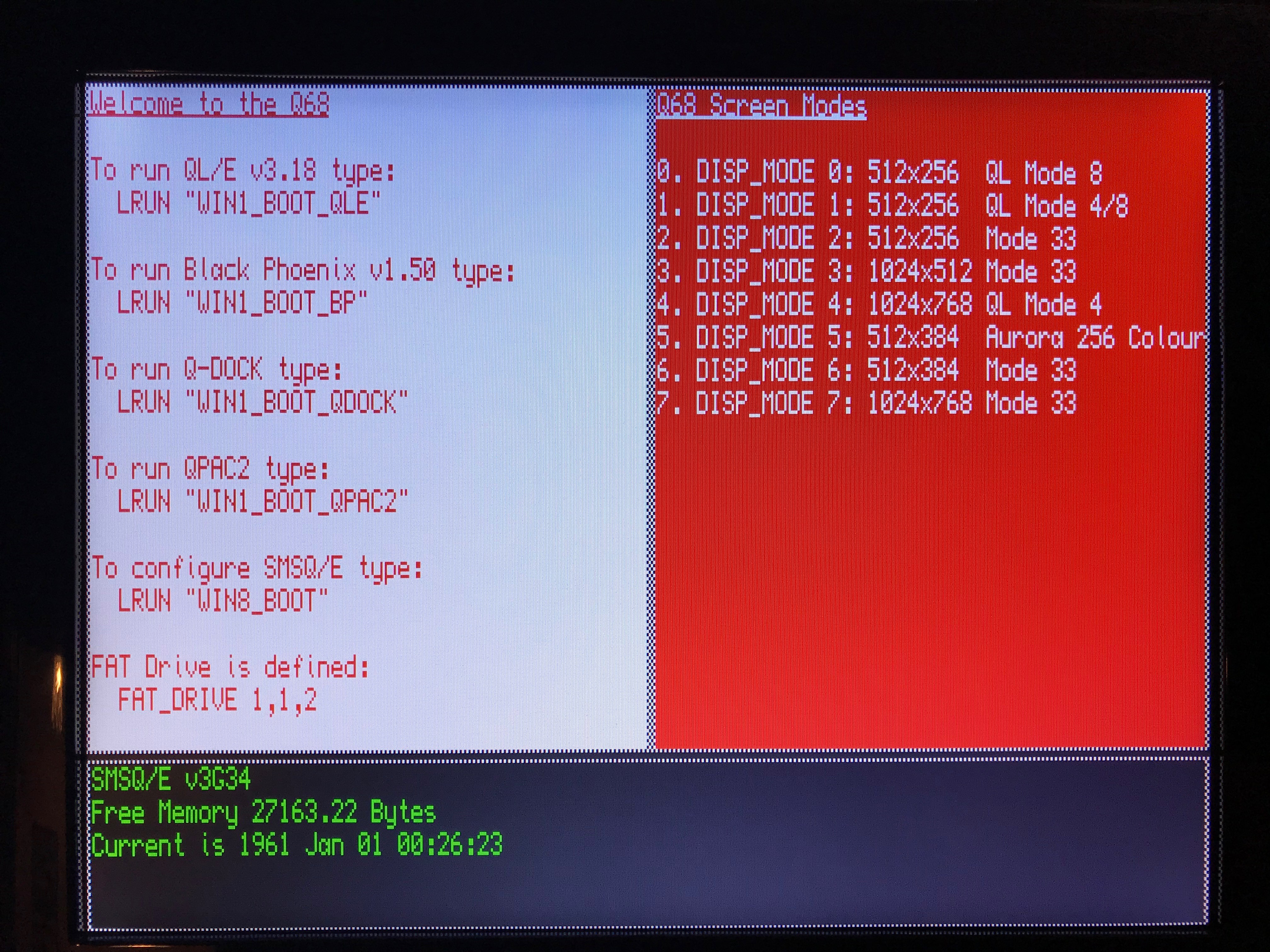

lcww1 wrote:Here's a screenshot from my freshly booted Q68 connected to the Benq BL912:
In that low resolution, the Q68 video controller enlarges every pixel to 2x3=6 pixels, so of course it looks good at first glance.
But if you look closer, you notice that the width of pixels is not constant (showing a 8x8 matrix):
While is is constant with the EM15A:
If you use 1024x768, the height of BL912 pixels will also no longer be constant, or badly blurred, this is just hidden by the fact that 256 scales well to 1024, while 768 does not. So a real test would be if you look at 1024x768.
lcww1 wrote:not bad, but the backlight shine-through (seen in window #0) does spoil things for me.
This is strange, I see no such effect here:
Maybe your EM15A monitor is defective, or there is a large variation in quality. Mine seems to be made in 10/2018.
