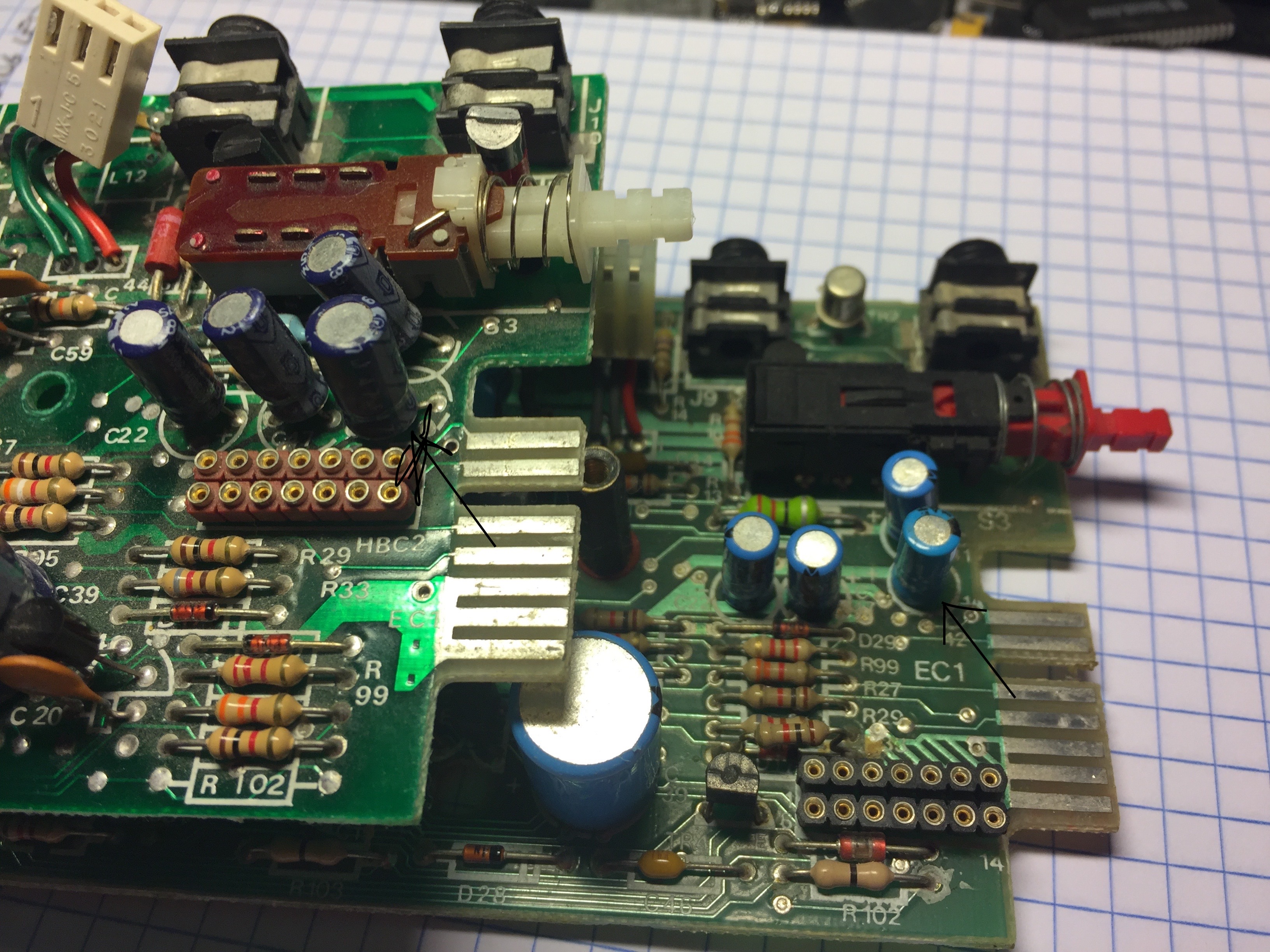

On US QLs, I have had two with failed supply caps. Both times, it was C42, positioned above the right microdrive connector, right by the EC1 port. As a precaution, I recap the 7 caps in that area, plus C4, which site between the ROM port and 8302 on US QLs. They made it 35 years but they may not make it the next 35.

The same cap with the same job is on UK QLs.
Top is US.3 bottom is UK Issue 7
