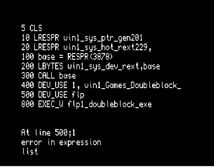

Please beg your advice, I have the doubleblock game.
Which is probably tricked for a floppy disk.
I would like to play this game on win1_ but the boot file is executed by exec_w filename_exe, QL writes me at line10;1
After examining a part of the code, I discovered that I have read other files in this file, and these files are searched on FLP.
Is there any way to force QL to run this game?
I know there are commands data_use and prog_use and possibly others.
Is there any way to force QL to look for WIN1_ and think it's on FLP?
Thanks for your advice, I'm in this newbie :-) and I really can not really program it.

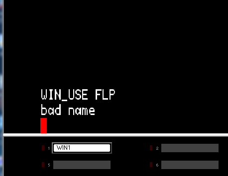

I have already tried it, I test it in q-emulator.
WIN_USE FLP returns me BAD NAME
It looks like it's a bad command.

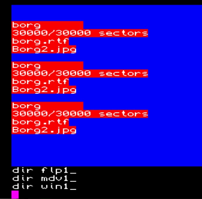

EDIT:
I'm testing in the emulator, no matter if I use dir WIN1_ or dir FLP1_ always see DIR WIN1_

Jack_Free wrote:I have already tried it, I test it in q-emulator.
EDIT:
Which emulator are you using? Q-Emulator, for example, appears to use its own drivers for win, flp, and mdv, which do not support the standard "use name" scheme - even when running SMSQ/E. My Hot Tip is: Try QPC2 or SMSQmulator! They are free and should run most well-written QL compatible software!

Jack_Free wrote:WIN_USE FLP returns me BAD NAME
Just to be 100% certain, you are typing the following:
WIN_USE FLP
or this:
WIN_USE 'FLP'
Because the quotes probably make a difference to the outcome.
This assumes that q-emulator can handle WIN_IUSE of course, as Per has hinted.

Cristian
Posts: 1027
Location: Veneto
Re: Doubleblock game - problem
Post by Cristian »
The Flp_use command is useless, because Qemulator slots 1,2,3... are automatically considered as mdv, flp, win etc. simultaneously (see attached screenshot)

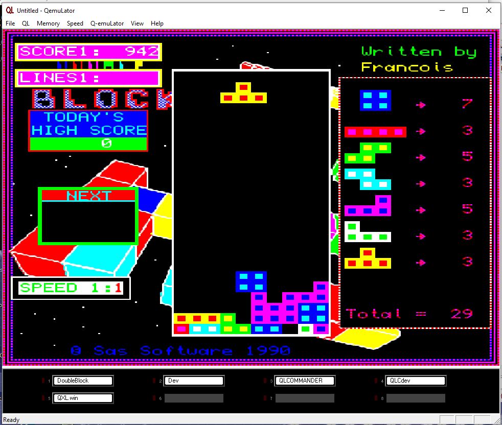

Posts: 1061
I really have no idea what are you doing there - Doubleblock works in QEmulator. I tested both with JS-ROM and with Minerva ROM.
I just mapped the doubleblock directory to QEmulator drive 1 (which is seen by the emulator as flp1_, win1_ and mdv1_ at the same time)
The boot file has a single line: 10 EXEC_W flp1_doubleblock_exe.
