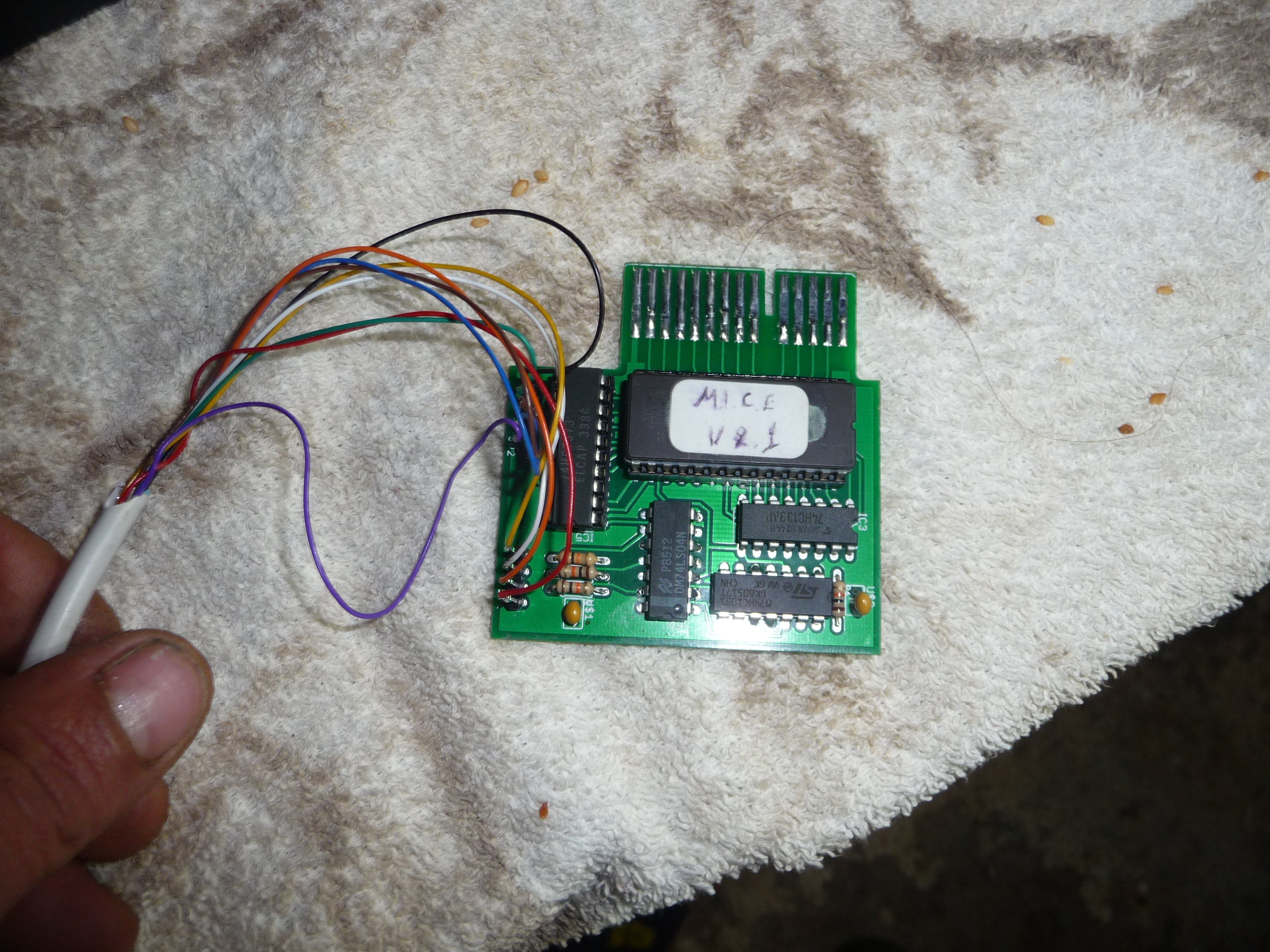

So i buy the clone mice(in a kit) with the ps/2 adepter ....
solder the kit and put it on the rom port of the ql....(i have a microsoft optical usb on)
nothing happen the pointer dint work :cry: :cry: :cry: :cry: :cry: :cry:

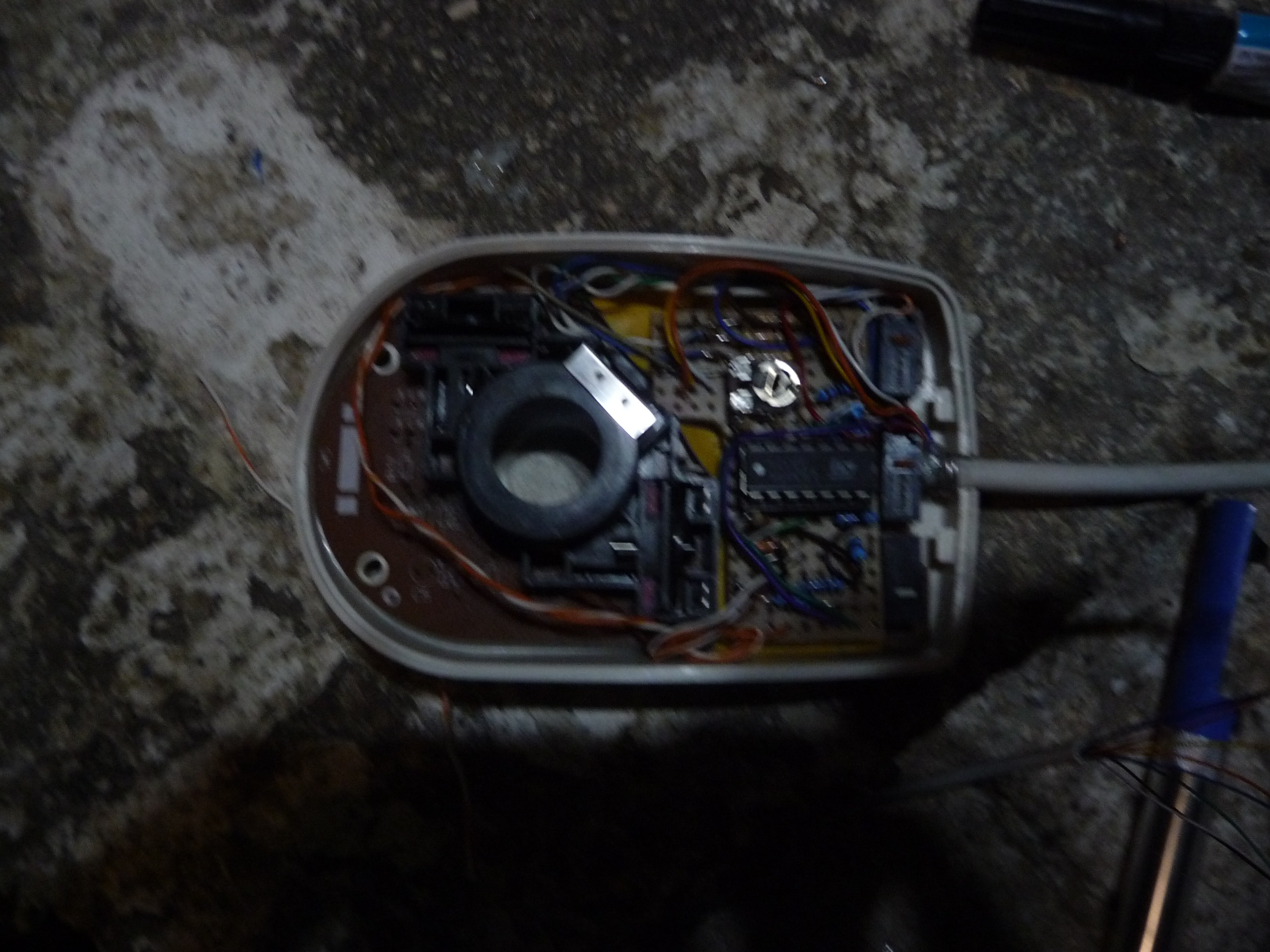

so i search for the schematic of the sm-1 and i found ths works with triggering and lm339.....
second search.... lm339 mouse and bingo wow goal i found this
http://oldcomputer.info/hacks/mouse/index.htm
you take a old win mouse and you can re make it
all the other thing is just history
easy to make with vero (actually i fount a 3 button mouse ball with 4 optos)
easy to adjust to work i fit it on the catritdge and it works....
TIP IF THE POINTER IS MOVE INVERTED CHANGE ALL DIRECTIONS NOT ONLY THE INVERT..
IT WAS THE ONLY HARD THING TO FIND.... IN ALL
