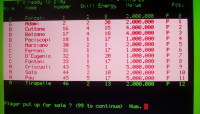

Print_using interpreted
[/size]Ok these are the images. It is an old program, a football manager like that I made several years ago. It is a kind of clone of the original game for the Spectrum. Unlike other clones it has the animatione of the match (like the original) based on gigabasic sprites. It is focused on italian championship. I am making some restyling and is my wish to post it here on the forum in english language. In the previous versions the print using was not present.

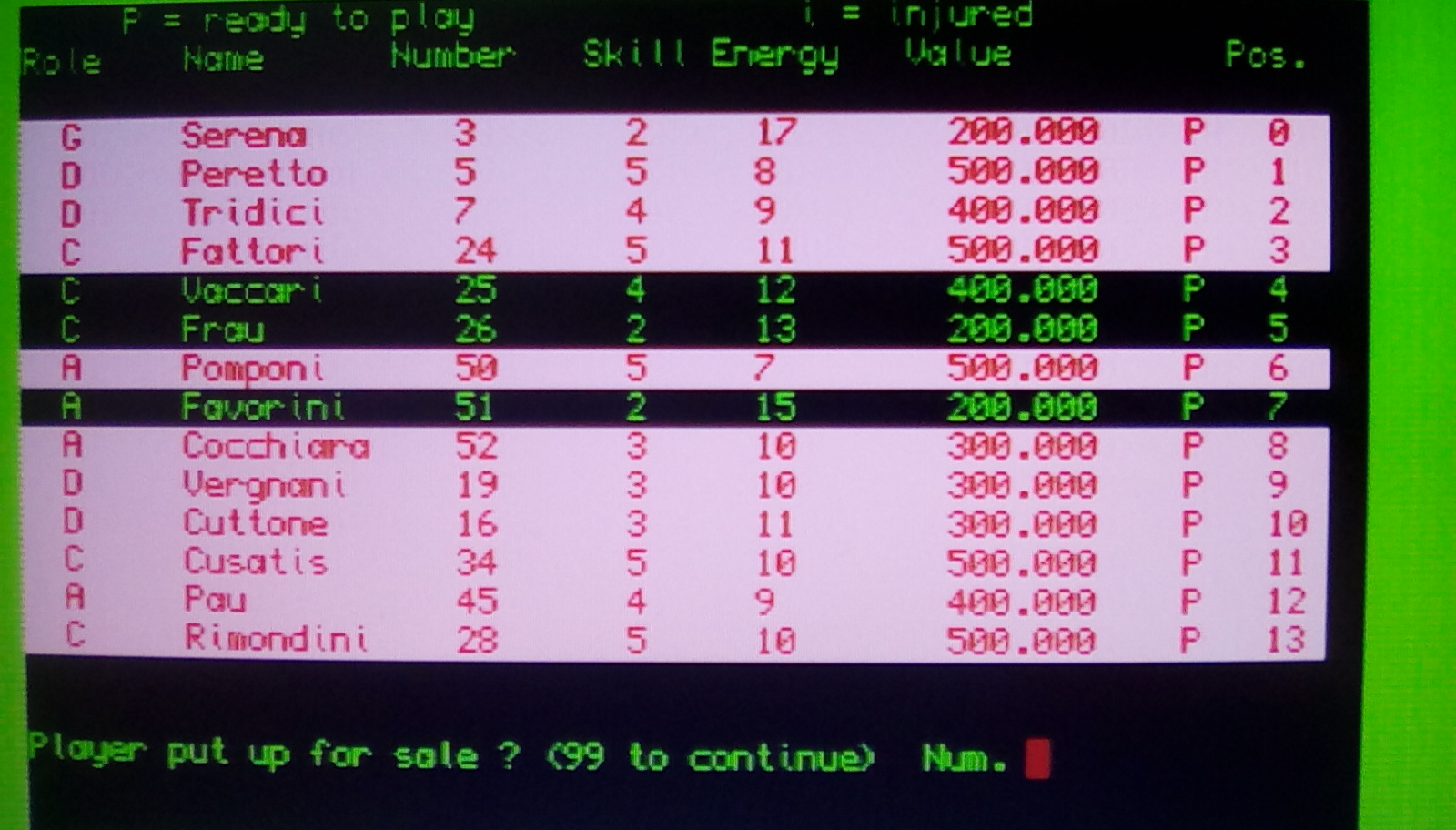

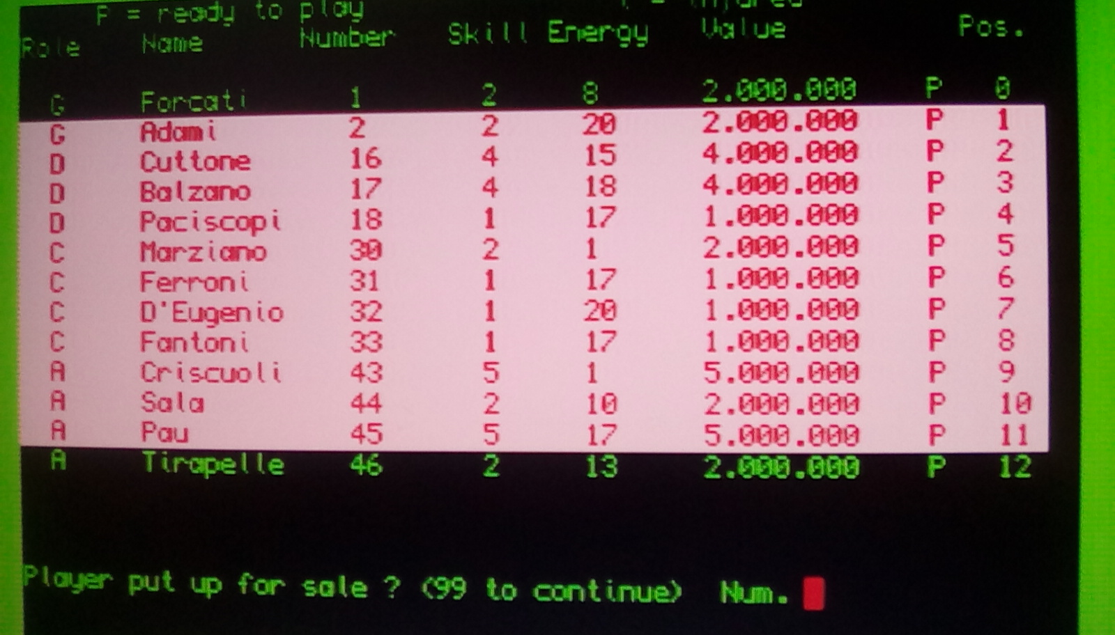

Print_using compiled
Today it came in my mind that the reason coul be in the way the program saves data. I will investigate this matter.
