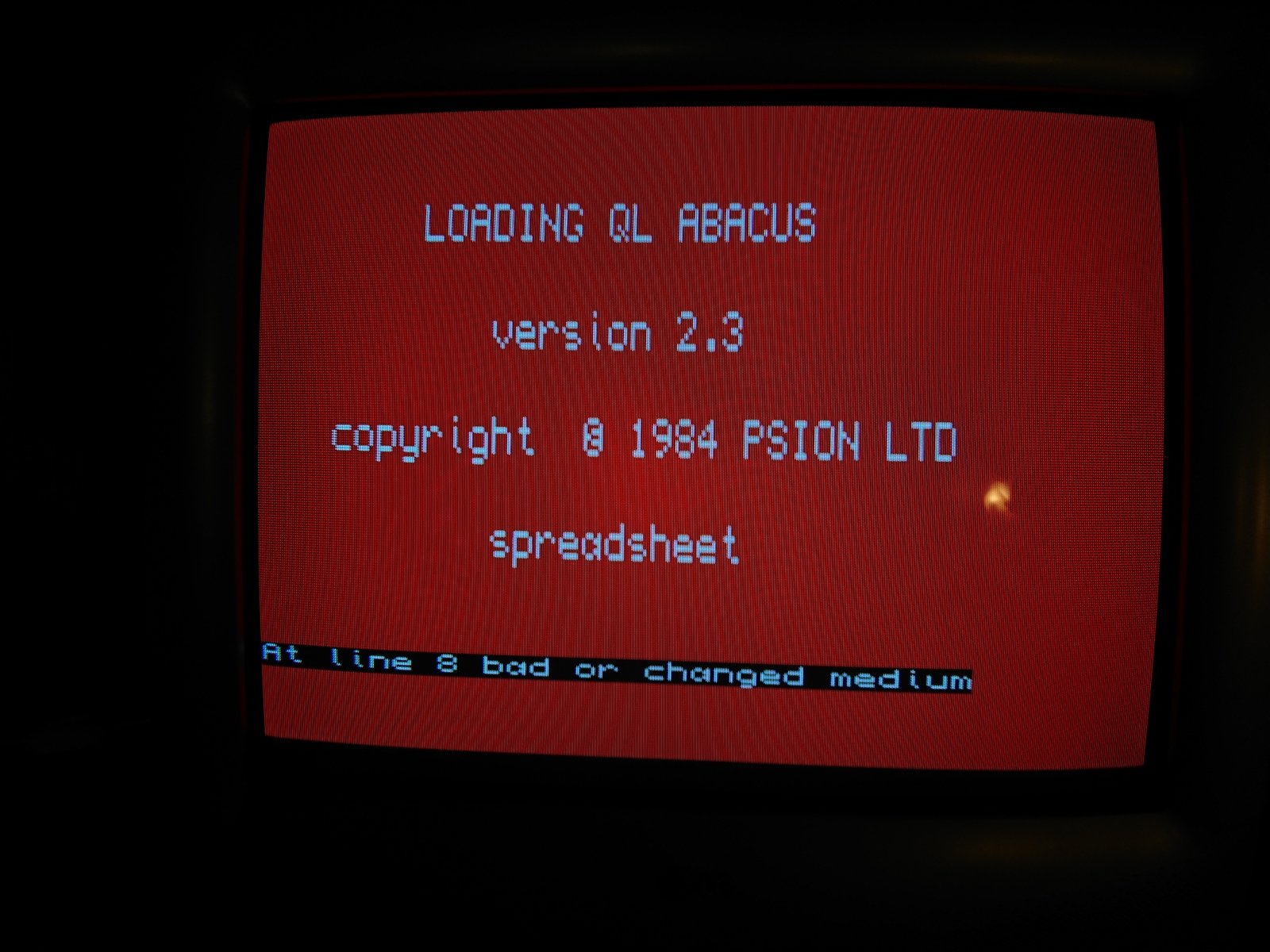

° I cannot run Abacus since I receive the following error:
I have also a copy but the error is the same (I am not the original first owner).
Since I can use the other 3 programs I think the MD is damaged... do you agree?
Would it be possible to transfer in someway a copy of Abacus from a dumped ROM in a PC to the QL... if so, do some guide for dummies exist? :D

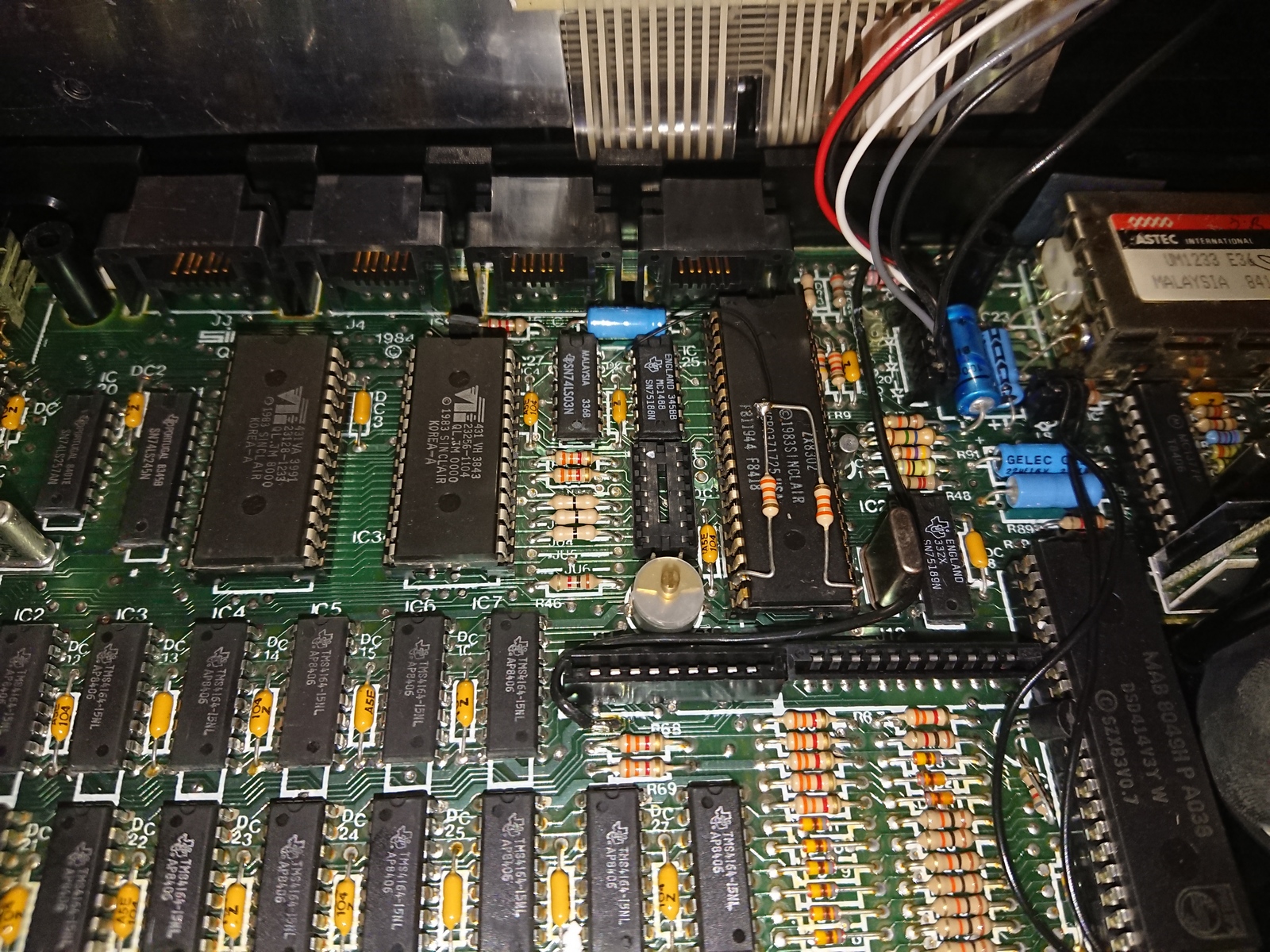

° I have noticed what I think is a modification:
am I right?
If so, do you have an idea of which type of mod is it?
Thanx
Nasta
Posts: 469
Location: Zapresic, Croatia
Re: Sinclair QL... ALIVE!!!!
Post by Nasta »
Factory mod to do with the reliability of microdrive access :)

flaviosr wrote: Since I can use the other 3 programs I think the MD is damaged... do you agree?
Yes, it is probable. Tipically, also the cartridge felt pad is damaged. Fortunately it can be replaced and sometimes the data can be recovered.
