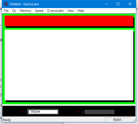

Has anyone had any success in getting Tridim to work?
I have been having a go, but without a lot of success so far.
There seems to be a missing 'unnamed' file that a SuperCharged program 'LBYTES'. I created a dummy file to get past that, Then the SuperCharged program does a 'CALL'. I'm not too sure to where (maybe the file it LBYTEd).
The SuperCharged program also has a reference to a file 'MDV1_Image' which I don't think is there either.
So far I have got the program to here. This is where the CALL happens, and the system crashes.

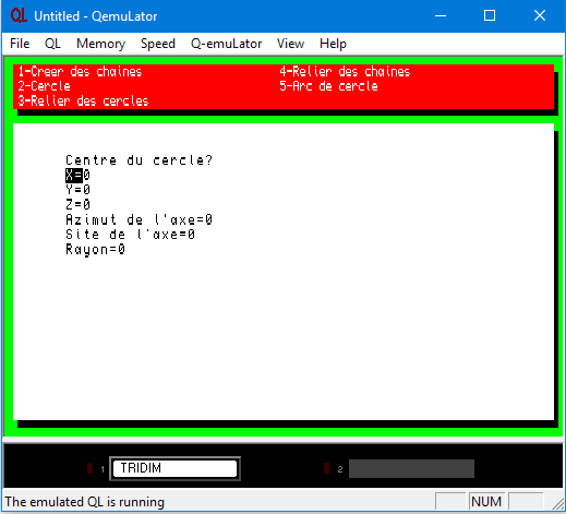

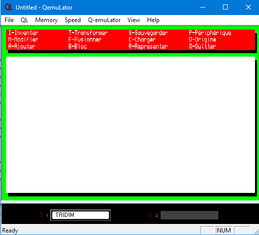

I have got it further.
Are there any French (I think it's French) speakers than can tell if it's working OK.
I have also attached a Qemulator .mdv file.

Re: Pyramide Software - Some Freeware
Excellent - yes it is French - it would be interesting to get the program translated to English as well (normally you can do this by overwriting the French strings, but just be careful not to change the string length!
