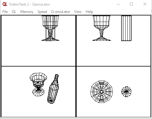

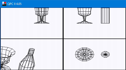

Is there some difference in the graphics drawing between QDOS and SMSQ/E that I don't know about?
In the following two screen shots of a QL program and its conversion to SMSQ/E. In the QPC2 one, the circle looks squashed.
While they are both 512x256, note that the QPC2 window is shorter than the Qemulator window. If stretched, the circle may look right.
Note also that all the drawings are done with the graphics routines, and the circles are drawn with straight lines and not CIRCLE commands.
I need to do some investigations.
P.S. I don't know why the bottom left image is so far off, where the rest look OK.

For what I can see here, all the QPC window is stretched. So it's normal it's also stretched all the graphics inside.
The original modes (8 and 4) have been set to draw round circles on a 4:3 display (rectangular pixels).
This QPC window instead seems to display square pixels.

I have just tried CIRCLE 50,50,20 on QPC2 and it comes out squashed. So it's QPC2 not drawing correctly.
If you try to draw a square box with LINE it also comes out rectangular. For the box you need to multiply each x value by 0.75 to correct
I had this problem with the manipulation program http://theqlforum.com/viewtopic.php?f=3&t=1153&start=30 but I thought is was because I was converting from writing directly to the screen memory, to using the graphics system. So it looks like I will need to make the drawing routines compensate for which system it is running on.
