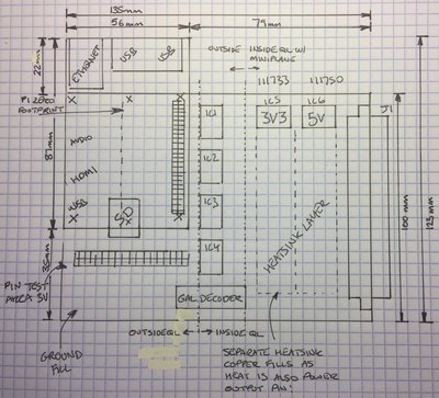

With the R/W pin there it makes direction control easy. I personally prefer the TXB0108 because of the flexibility it provides (one PCB and Pi you can decide which GPIO are inputs or outputs and change them on the fly) but it is a bit pricy - $1.14 instead of $0.64 each. However, when only using 3 or 4 and having a very small run design like this, I think it's worth the extra expense. The TXB also performs better in this application.
If we treat this as a QL expansion device and give it a 16k decoded block, that would certainly increase options and make it a lot more flexible. If someone wants to do a simple GAL decoder and I focus on the PCB design?
My instinct is to make it a card that site the Pi just outside the QL, with ethernet and USB facing back and just hung off the edge of the card so you can use the usual spacers to mount the Pi securely. Do you want to be able to choose which GPIO go where, or is there a consensus of maybe....
8 bits data bus, 8 bits address bus (giving 256 byte addressable range), device select from address decoder, R/W line, room for 6 more GPIOs with 3x TXB0108 or all the remaining GPIO with 4x TXBs. Do you want a little thru-hole work area to maybe at sensors? Or bring out the SPI ports? Any other requests before I do a V1 of this?
Posts: 2823
Re: Discussion about connecting RASPI to QL
Just threw this together real quick to get an idea of the areas and spacings involved:
Quick drawing....
Quick drawing....
IC1-4 would be level shifters. All ports would be conveniently available outside the QL. I'd make a duplicate copy of the Pi connector so it would be easy to snoop traffic.
The 5V and 3V3 regulators would be 1117 SMDs. Their main heat transfer area is their power output pin. They have full over-current and thermal protection circuitry and are quite a bit more efficient than the 78XX regulators, as well as smaller.
If you combine this with a miniplane you can easily have a QubIDE/RAM card in the case too, which would be.... handy.
Am I missing anything important?

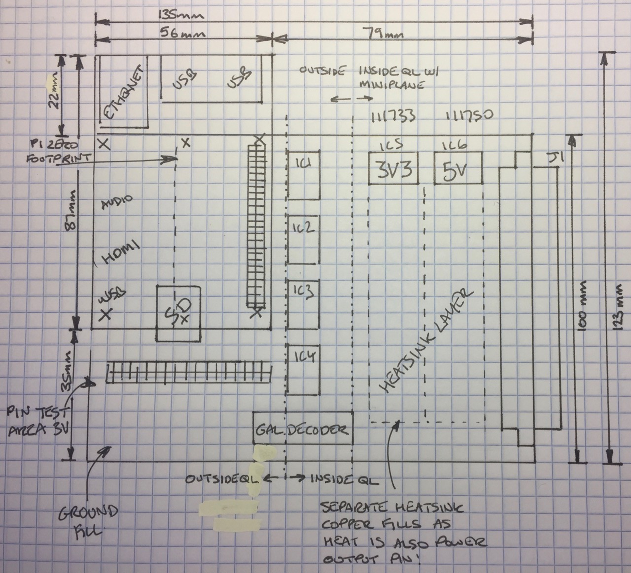

Same again, but with dimensions and physical interactions shown:
36-24-36 *swoon*
36-24-36 *swoon*
Posts: 2823
One thing this DOES allow is the Pi to operate the bus and snoop the QL IO area. It could read keyboard inputs, and read/write the microdrives, use the serial ports, etc. It could run uQLx, and use the QL's hardware as an accessory. It would be by far the most powerful BBQL ;)
