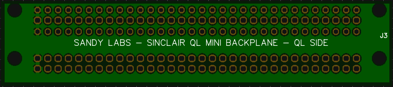

The card fits inside a QL and supports three positions. Two positions face left and one faces right, upside down over the CPU. I don't personally recommend that you use all three positions with old cards that suck juice and spit out heat. However it does make it perfectly reasonable to have a recently redesigned Trump Card and QubIDE with CF slot just above it facing left. Alternatively, you could have the Trump Card face left and the IDE card face right. As long as the total current draw of the cards isn't excessive everything is fine.
The card is TINY, 96.3mm x 20.6mm. I left as much room as possible around it to allow air to circulate in the QL case. It will come with two protective plastic shields so a top card can't short against a bottom card, or an inverted card can't short against the metal keyboard backplate.
I should get the PCBs in a few days and have everything assembled in around two weeks. They have already shipped to me. Then I'll work out my partscosts and sell them at cost price. I'll post photos and so on then. I will only be making 25 of these, and 11 are already reserved. I have parts on hand to make 11 (was 8) until I order more male DIN41612 connectors.
Looks like it'll be somewhere around £20-£25 with three sockets, £17-22 with two and £14-19 if you just have the one doubling back. Plus shipping which looks like it's £10 for international up to two, and £19 three to many. ($13.50 up to 6oz, $22.50 6-32oz). The price variation is just depending on how much it costs to get quality connectors - prices vary from $3.50 for cheap ones up to $7+ for high end gold plated ones with a high number of insertion cycles. I prefer to use quality parts but I don't go crazy.

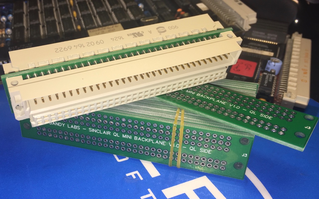

Sandy Labs Miniplane
It's here!
Posts: 2829
Re: New QL backplane.
Here is a new backplane that lets you get two and in special cases three expansion cards inside your QL case. It is a left-over from my QL2 project in 2013.
It plugs into the expansion port and allows one expansion in the usual place, and one upside down over the QL mainboard. It's ideal for having, for example, a QubIDE with CF card internal to the QL.
The option exists to have another small card over the first expansion card. However, it is VERY mechanically tight. You also need to carefully watch the power draw doesn't exceed the QL's ability to supply. The new generation of cards released in the last couple of years do draw a lot less current, so it may be time to upgrade :D Meanwhile, it works well with a (Super) Gold Card and QubIDE, if the 68008 is removed.
A layer of electrical insulation needs to be applied to the metal keyboard backplate as it does touch the back of an upside down card over the QL. I will supply a piece of vinyl that can be applied and easily removed later, so no permanent changes are required.
Due to the physical shape of the Gold Card and Trump Card, they will not easily allow cards stacked above them. If you replace the crystal on a Trump Card with a low profile one, it will allow a QubIDE or similar above it.
I designed it so it is possible to solder all the pins by hand, but it requires assembly in a particular order to gain access. On the top row, it's a very tight fit. My older batch of connectors fits well but my newer batch the pins are slightly larger. I will order another batch with a very slightly larger centre hole.
I'm going to assemble and test a few, then post details of how you can get your grubby mitts on one of these bad boys.
