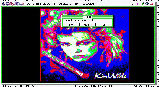

Dialog no 1 before picture is showed. Software knows the size, why asking the user?!
Dialog no 2 before picture is showed, mouse pointer placed on wrong item. Software knows the mode, why asking the user?!
Dialog no 3 before picture is showed. User should be able to configure his prefered automatic choice.
When pressing ESC on a picture showed, SQRview continues with more dialogs. First this one.
Finally this one. A lot of mouse operation, clicking or keyboard entries.

Thanks for including it in QL/E.
Without going into all details of your comments I can only say that it is this way mostly as it was "grown" over time.
First as a test to explore the PIC viewing capabillaties of EasyPTR and then adding stuff.
As for mode 4/8, there is no way to read from the file which mode it is. Suggestions are made on the basis of size, length or name extension, so some dialog will be needed. We don't want the program to crash on the wrong guess.
While testing the latest BMP on the _dat_QLSC_ directory of your QL/E, I did find browsing SCRs there faster than with SQRview.
So there is room for improvement.
As far as the other dialogs go, using navigation to browse a directory of mixed image formats will skip most dialogs and defaults are used to speed the process. And in many cases the pointer is at the most logical option so only a few HITs or DOs are needed.
I will study the comments in detail later but for now SQRview is back at the bottom of the "to do" pile.
