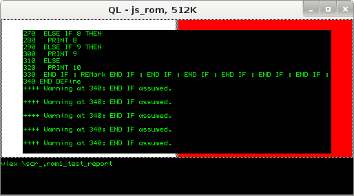

tcat
Posts: 633
Re: Super BASIC coding style for Minerva
Post by tcat »
As it seems, current Turbo version only gives warnings about obvious `IF-ELSE' termination.
EDIT that I am glad for.
`IF-ELSE' obvious termination
Tomas
