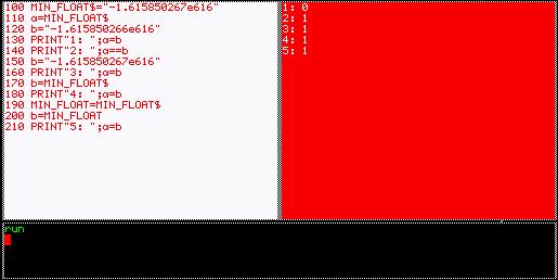

When using functions which return a float, you often want to signal an error to the calling procedure. in C/C++ there exist NAN (or similar) which is no number, but can be returned. This can be interpreted as an error.
In SBASIC such a value doesn't exist to my knowledge. So a good candidate would e. g. be the smallest possible number, to signal an error. So I tinkered to find the smallest possible number:
-1.615850267e616
Even appending a zero to the mantissa will result in an error (try PRINT -1.6158502670e616)
You can e. g. use MIN_FLOAT$="-1.615850267e616": MIN_FLOAT=MIN_FLOAT$. To return an error from a function use:
oops=MIN_FLOAT$: REMark an error has occurred
return oops
The calling code then can test:
rslt=foo(expr)
if rslt=MAX_FLOAT THEN : PRINT"Error occurred in foo()!": STOP
I have tested, that this works (at least on QPC2, can anyone test on other machines, ROMs) with the attached SBASIC program.
The same magic number (without the minus sign) can be used for maximum possible float.
