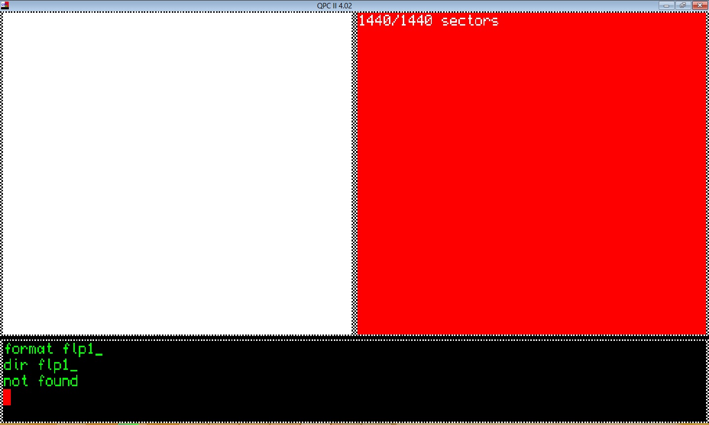

I have an Asrock 980/SE motherboard with floppy controller on motherboard and windows 8.1.
With QPC2 4.02 I can format a floppy disk but the dir command doses not work. On the other hand it works fine with Q emulator. Also the QPC2 cannot read HD or DD disks from original QL + Gold card.

In the screen shot it shows 'format flp1_' with no medium name supplied. Do you get the same problem when you supply a medium name? e.g. 'format flp1_test'.
QPC2 v4 supports floppy disk image files. What if use a PC program to convert the disk created by the QL+Gold card into a image files, and then see if QPC2 v4 will read it.
